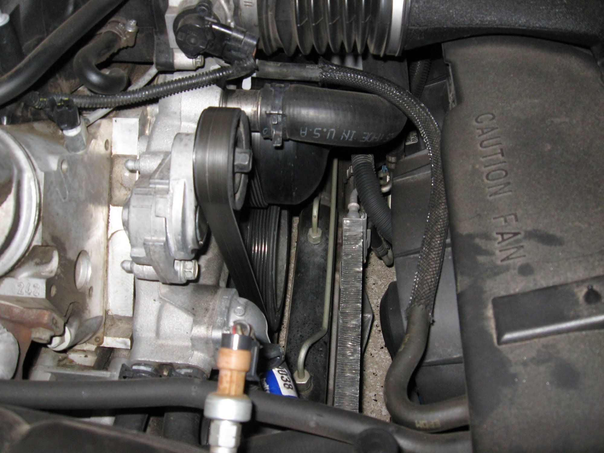

Oh yeah, forgot about the belt tensioner. I'll have to pick one up. Anyone know the correct part number for the tensioner by the water pump?

Can someone post a pic of the correct tensioner pulley? I don't have mine so I can't compare. I see two different styles listed on the web.

Mine looked like this
There's another one for the AC which may be the other one you're seeing.

Yeah I thought it was the other one. Thanks for posting the pic!
