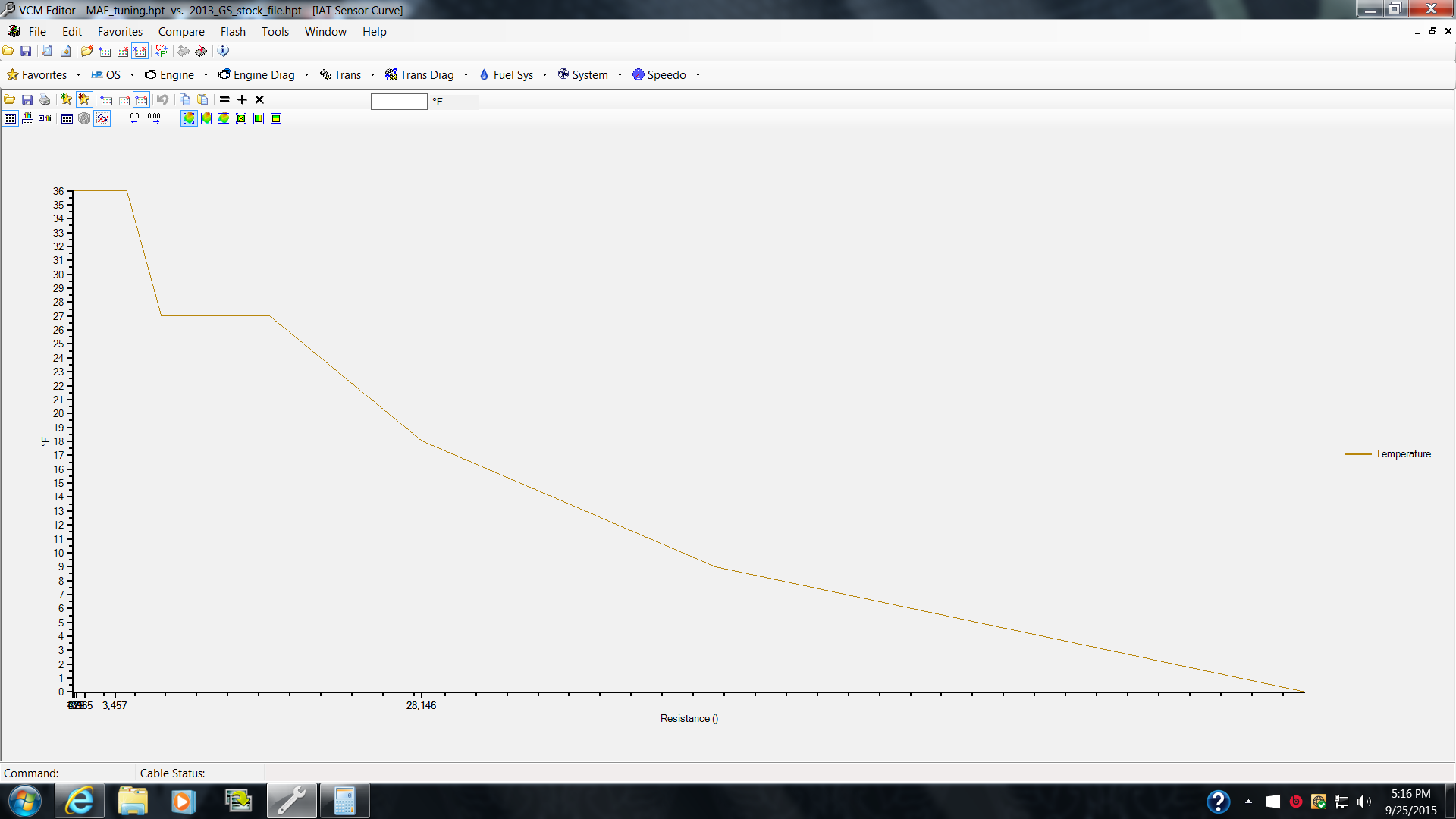

I really do think it's a small amount of meth vapor that's causing it. I don't think it would take much for it to choke on startup like that. When I still owned that car, I pulled the charge pipe and looked inside after letting the car heat soak. There was no liquid to be found, but I still think a small amount could have been getting in and causing a rich condition on startup. Turning off the system isn't going to answer this question, as there will still be meth in the line. You should really disconnect it for testing.
I'm not sure why Pat doesn't recommend changing that table, but I'm pretty sure Dave posted in this thread saying he thought it was a good idea.
I went through this exact same thing myself with my Heartbeat blower. It uses the LS9/LSA IAT2 sensor, and when I left the table stock, my IATs definitely read too low in the ambient temp ranges. Since I have a break-out harness, I was able to do some easy testing. What I found was that the LS9/LSA sensor shows much more accurate values when you use the ZR1 IAT2 table data and axis .
All you need to do is open the IAT2 data for a ZR1 in graph form and compare it back to back with a stock LS3 IAT1 table. There is a noticeable difference between the two, and it's easy to see.
Here's the screenshot. This is comparing my stock IAT1 table to the ZR1 data I have in it now:

Actually....
Compare does weird things due to the axis labels being different, so it makes them look much more different than they really are in practice. Compare just compares cell 1 to cell 1, cell 2 to 2, etc. and doesn't take into account anything else
If you take both curves, plot them in Excel and overlay the graphs, they are very close to the same
Still.. Dave said to use ZR1 IAT2 data, so I use it.
That's actually what I first did. Just opened 2 different HPT sessions and could cycle back and forth between the two. Unless I'm missing something, I'm pretty sure there are some big differences at cooler temps.
Well well well...you hit the nail on the head! I did change the parameters on the IAT2 side but not on the IAT1. I'm a dumbass for that! So I returned the IAT2 side back to stock and used the zr1 data to change the IAT1. I didn't have time to test but a quick start showed the temps to be much more accurate. Before I'll see this high temp just to get below ambient in no time. Now it stayed like it should since I was idling.
Thanks a lot! I'll update once I get to do more testing tomorrow. Now is the old lady's time....lol
Did you change the axis labels as well?
