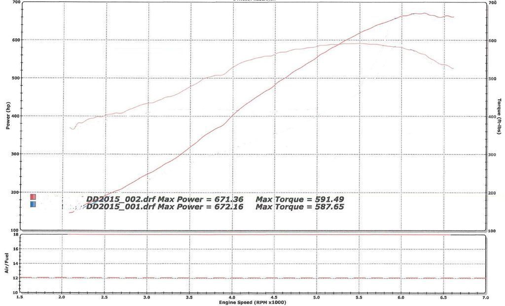

Just got the car back from BLOWNBLUEZ06 Thursday after adding alky control dual nozzle running 100% meth, swapping to 3.6" pulley (from the 3.8" on A&A's V3 Si), gutting the cats (on LS7 manifolds) and switching over to speed density and eliminating the MAF. Went to a dyno day today, and she put down 672RWHP and 587TQ (up from 600RWHP and 525TQ). I'm very happy with the gains in power, but even more happy with Bret's tuning of the car. I'd always had some slight surgning issues at low speed (1st & 2nd gear) and surface street cruising (4th gear from about 40-50), it wasn't horrible but it was definitely noticeable. The car now has zero surging, and drives 100% like stock until you get on it. Can't speak highly enough of Bret and the job he did, he was very thorough on the install and on the tune.
The only downside is that now I've got a serious meth addiction!
Next up is to see how long the stock clutch lasts, once it goes I'll upgrade to something stronger and then go to a 3.4" pulley (not that I need it, but you know how that goes).

The car has always been on the strong side, dynoed right at 400RW stock, and then 600RW after the I tail blower install. I'm really amazed the factory (LS7) clutch is holding up to it, although I've never taken it to the drag strip. That's the main reason I went to the 3.6 pulley, I didn't think the clutch would last if I went to the 3.4.

11 pounds

Went from 574/532 to 640/588 adding methanol at ~11psi. One of these days I'll do a Dynojet to get the "higher numbers" The main thing with methanol is I found the car wouldn't pull as much timing and was more consistent in power delivery. In humid-ville USA it made all the difference.
