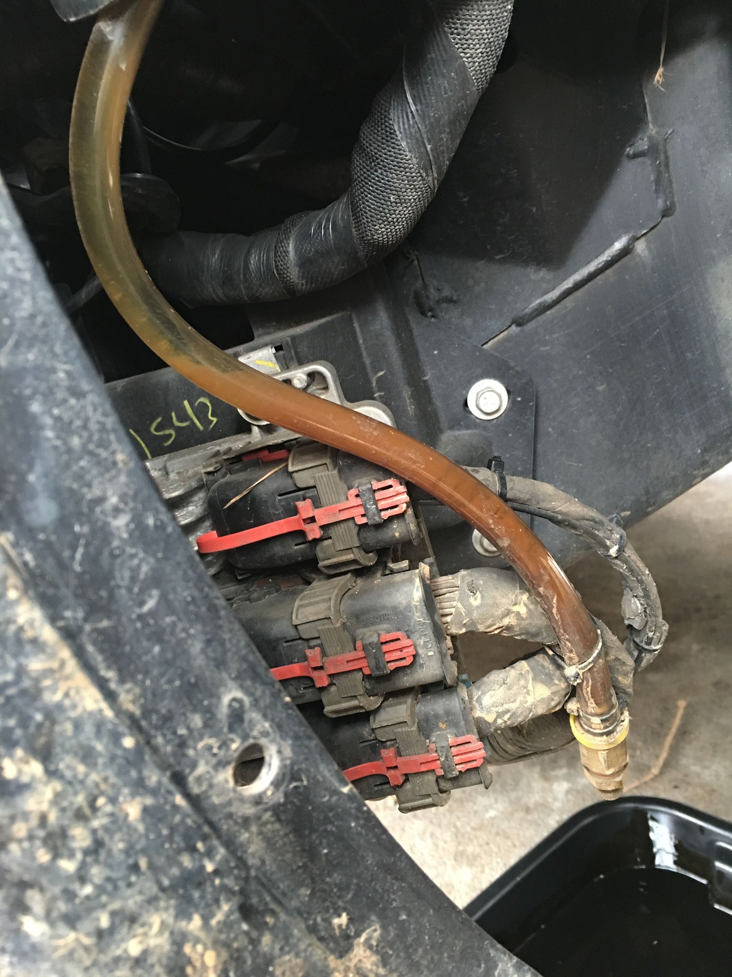

Old Nov 30, 2015 | 04:46 PM
schpenxel's Avatar
schpenxel
Joined: May 2004
Posts: 16,667
Likes: 1,209
From: Raleigh, NC
St. Jude Donor '15
I wish I had measured it.. I just emptied it a week or so ago after not emptying it for probably 2 months. I got a lot out of it but can't quantify how much it was.
It was more water than oil surprisingly. It was enough to fill the remote drain line + fill the can up to the sight glass thing, however much that is.
