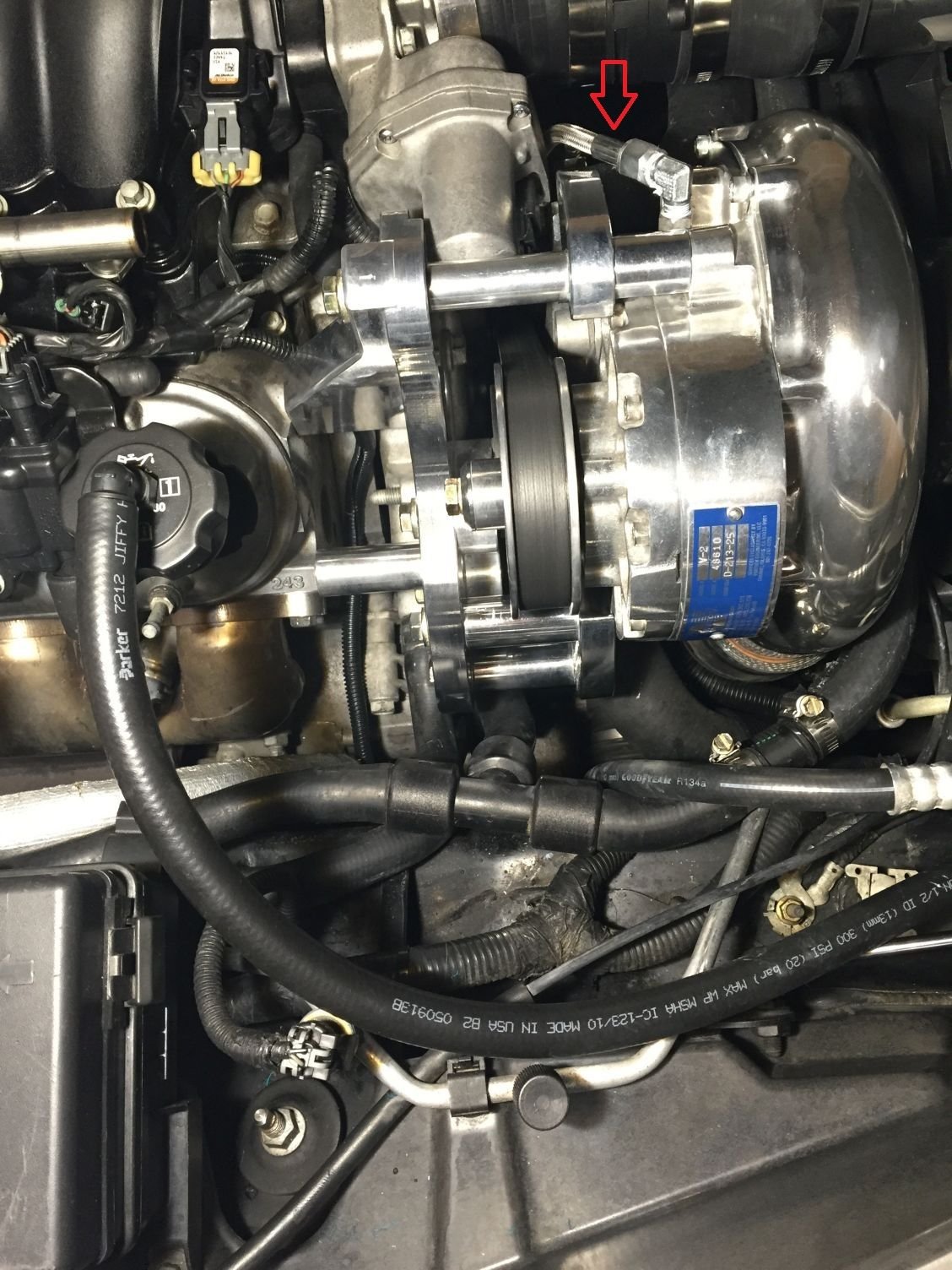

Originally Posted by bumpin96monte
Thanks for all of the feedback everyone, I appreciate the help!
I'll try and give A&A a call Monday; my wife is going to be induced for labor tomorrow morning, so I didn't have much time today to dig too deep into it since we were busy trying to get everything together. I have a tuning appointment next Saturday, so as long as I'm done by then, I'll be ok.
I really like that T relocation, that seems like it would make a lot more sense to move it off to the side.
As for the trans lines, I fought with them a little more tonight. The first clip is up by the leaf spring, and I undid that one. It gives me a lot more vertical play. I see there is another back by the oil level sender on the pan, but I haven't tried pulling that one off yet. If I do, it looks like that will only give me more room to move them to the passenger side, which I don't think I want.
Unreal, I know you said yours are on the passenger side of the power steering loop, but does your upper line go around the passenger side of the blower outlet tube as well? Reason I ask is because mine seem to be closer to fitting it if I go around the drivers side of the blower outlet which forces the lines to the drivers side more.
See image below- it's closer for me to make a 3" tube fit if that line goes towards the bottom of the screen rather than make it go around the top.
On a side note, I did try putting the upper cooler line through the loop in the steering to give me a little more slop. It seems like it would work, but I'm not sure how I would prevent the lines from rubbing each other since they would cross at such an odd angle. Using this routing, I was able to get the bracket as close as I've been to bolting it on though (close enough that I think it would fit if I applied pressure to rotate it while I started the first few bolts/installed the last spacers).
With the baby coming tomorrow, it looks like I won't be able to dig in until Tuesday or Wednesday at the earliest.
you can prevent the 2 hard lines from rubbing against each other by slitting a piece of hose from end to end that is the same i.d. as the o.d. of the hard line.install on line with tie-wraps so it doesn't move

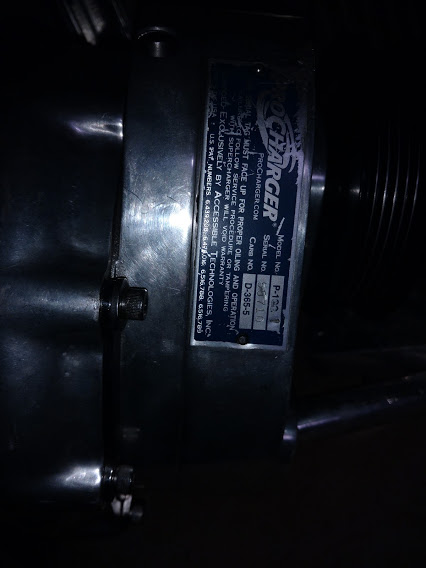

Originally Posted by asteroid
Hey guys, I will aslo soon be trying to install sc by myself, can you help me with some questions?
I dont know where I must plug in this hose at another side from headunit
as I bought aftermarket supercharger kit I dont have instruction manual, my kit is procharger with p1sc1 , can anyone help me with link where I can download installation guide?
Thanks
If your head unit is a p1sc, you will not have an oil feed line. They are self contained with 4oz. Special oil you buy from ProCharger. Do NOT fill it with motor oil.

decal has some scratches but can read that it is p1sc1

that's a remote drain line, not a feed line
