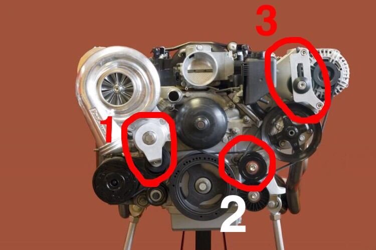

Originally Posted by PEETYZ
There is a tensioner on the supercharger side as well you either use the stock Procharger one or the Cartek. I have no doubt the Cartek Billet tensioner is much better than the procharger one as well.
Having a more dedicated blower belt that only goes around the Balancer, Blower, tensioner/idler, and part of the water pump makes a big difference. Tighter wrap around the crank especially is huge. Ideally I suppose you would have a belt system with just the Blower, Balancer, and Tensioner but the water pump really has no other way to spin due to its location.
Take a look again at the diagram and you will see what I mean http://www.cartek.net/v/HPE/FlipDriv...uctDetails.jpg
Technically 3 tensioners in the whole system with flip drive.....#1 right under the blower, #2 under the alternator, #3 Stock AC tensioner (This one doesn't need much tension)
Now I believe it ���� u mean more surface of blancer touching the belt . With 3 tensioners its enough �� , but i do researchs for flip drive some kit coming with the #1 i think tensioner below in the picture i attached and some without only coming with
#2 and #3 !?

you will need a cartek blower bracket in order to use the tensioner labeled #1, it is not part of the flip drive
Thanks for clearing that up. That is definitely why I don't have that tensioner and use the stock Procharger bracket/ tensioner with the flip drive.
I'm using a&a's secondary drive and it works great, it's similar in design to the flip drive but it uses an auto tensioner instead of a manual tensioner so you won't have to adjust it once installed... cartek's blower bracket is really nice and I was going to get one when I switched but they would not answer the phone and I wasn't going down that road again lol... I believe 8 rib is the biggest you can get with their bracket though, as far as I know there is no 10 rib option... I'm glad they didn't respond because I am very happy with everything I got from a&a
