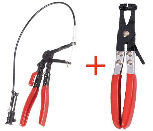

Not "Exactly". You do need to remove the oil (or 710) filler cap. One can find a good quality set of bendable pliers from the local Harbor freight and go to town swapping the valve springs.

Wtf!
Just need Comps LS valve spring compressor tool and do it the easy way.
Last time I checked...you can't get to the springs with the valve covers on...

Sarcasm... you missed it
