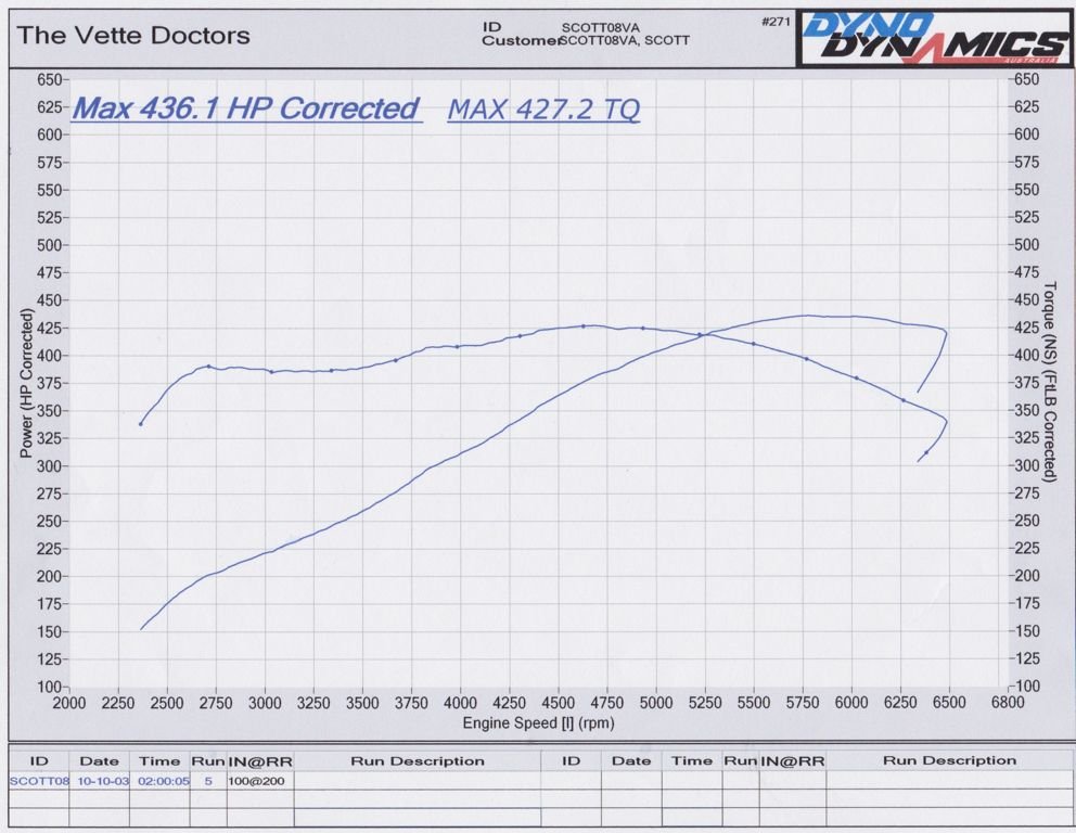

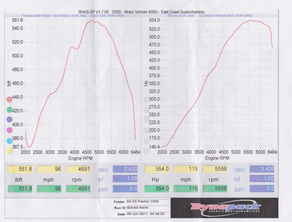

Decided to have ECS install their Methanol Kit on my 2008 LS3. As I was placing my receipt into my car folder archive, I came upon the last two Dyno runs performed after previous MOD installs. Just thought I'd share with you all.
2010 - My first Engine MOD - American Racing Headers and a Custom Tune provided by the Vette Doctors
2011 - Supercharger Install and Custom Tune by Doug at East Coast Supercharging

Probably nothing earth shattering compared to others on this site...but when that little green led light illuminates on the "A" Pillar, I sure do get a huge smile on my face!!!

It gained 120rwhp with just the addition of meth? That doesn't seem right. You sure he didn't change pulley and/or remove restrictor?

Looking at the second Dyno I posted I think Doug at ECS may have given me the wrong Dyno result. If you look at the top it has my name (Scott Bear) but on the bottom it list the name Gerald Aiello...I probably had more power then I thought!
What are the usual gains for my setup?

So it was 554 with the blower and headers??
Yeah i'd say they pullied down or removed the plate lol

I think you're right!
Depends on how it's tuned but with additional timing maybe 40rwhp or so.

It is the correct dyno sheet, I just had a different folder open at the time. My mistake, sorry.
But to answer the boost question, yes the restrictor plate was opened up.

No problem...LOL, it took me 5 years to notice!

The following is off-topic, sorry for that.
Your dyno graph from 2011 is a bit strange. Maybe there was knock, maybe belt slip, whatever, but that dip especially at 4000 rpm in the torque graph isn't normal.
Anyway, at 3000 rpm, you used to have about 260 rwhp.
Now you have about 240 rwhp.
You lost 20 rwhp.
Strange, isn't it?
Anyway, the later setup is of course much much better than the previous one. Have fun with your car!
