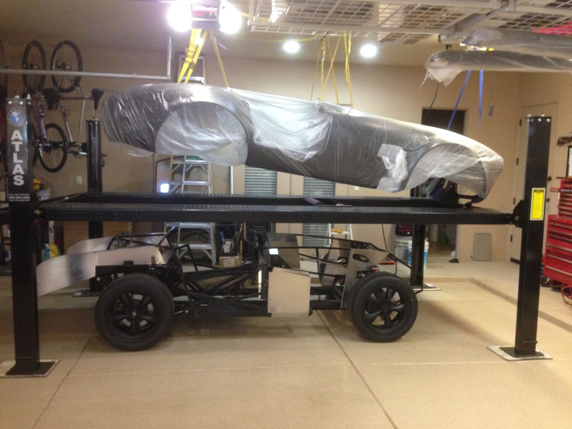

Originally Posted by CaddyTech
Interesting use of the floor jacks. They are sturdy with half of them not on the lift?
Yes, as solid as if on the floor. The pic might be a bit of a distortion, but the actual contact point on the frame transfers weight vertically pretty close to the center of the ramps. this distributes the weight out across the bottom of the floor jack and the contact patch for the jack rails covers about 2/3rds of the rail lengths. the front rollers of both jacks are on the ramps. Because of the counteracting scissor positions, this creates a larger triangular support structure across the complete width of both ramps. It wasn't setup in the pic, but I also have a bridge pan I can position under the front carrier and I could place a middle safety jack stand if/when doing heavy mechanical work under the car. But for this project, I am mostly working in front and not underneath the car.
I've done some pretty heavy work with this setup. I built a complete Factory Five Roadster from the chassis up using this setup. I've even rigged it to completely remove the body of the FF myself just using the lift, which is normally a 3 person job on the ground. Believe me, at my age, I'm not into dangerous.
