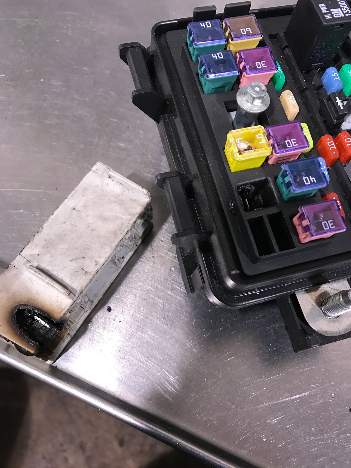

Also check 60 amp fuse(25) cooling fans in the fuse box/engine compartment. I had the same problem my fuse box and connector were burned up.

If it's burning up a 60 amp fuse, the fan motor is probably on its way out, which could take the module out with it. Tuners love turning the temps way down low so the fans are running constantly. Mine doesnt go to 90% duty cycle until 220 or so. Coolant temps are rarely over 200 when the fans only at 15-20%.
