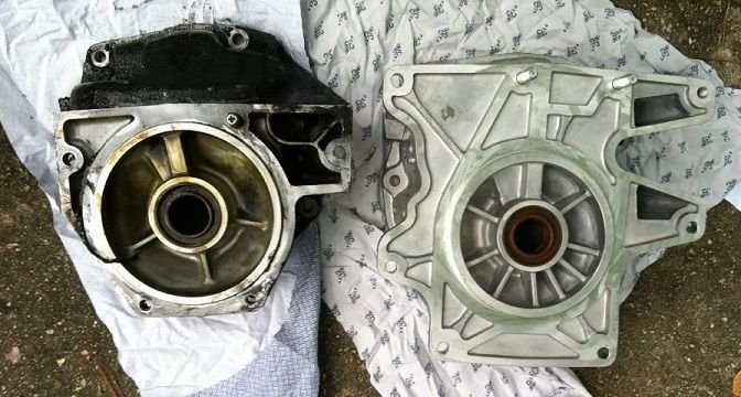

I just bought this 09 3:42 diff and noticed this.....thoughts
To 2005 differential upgrades?

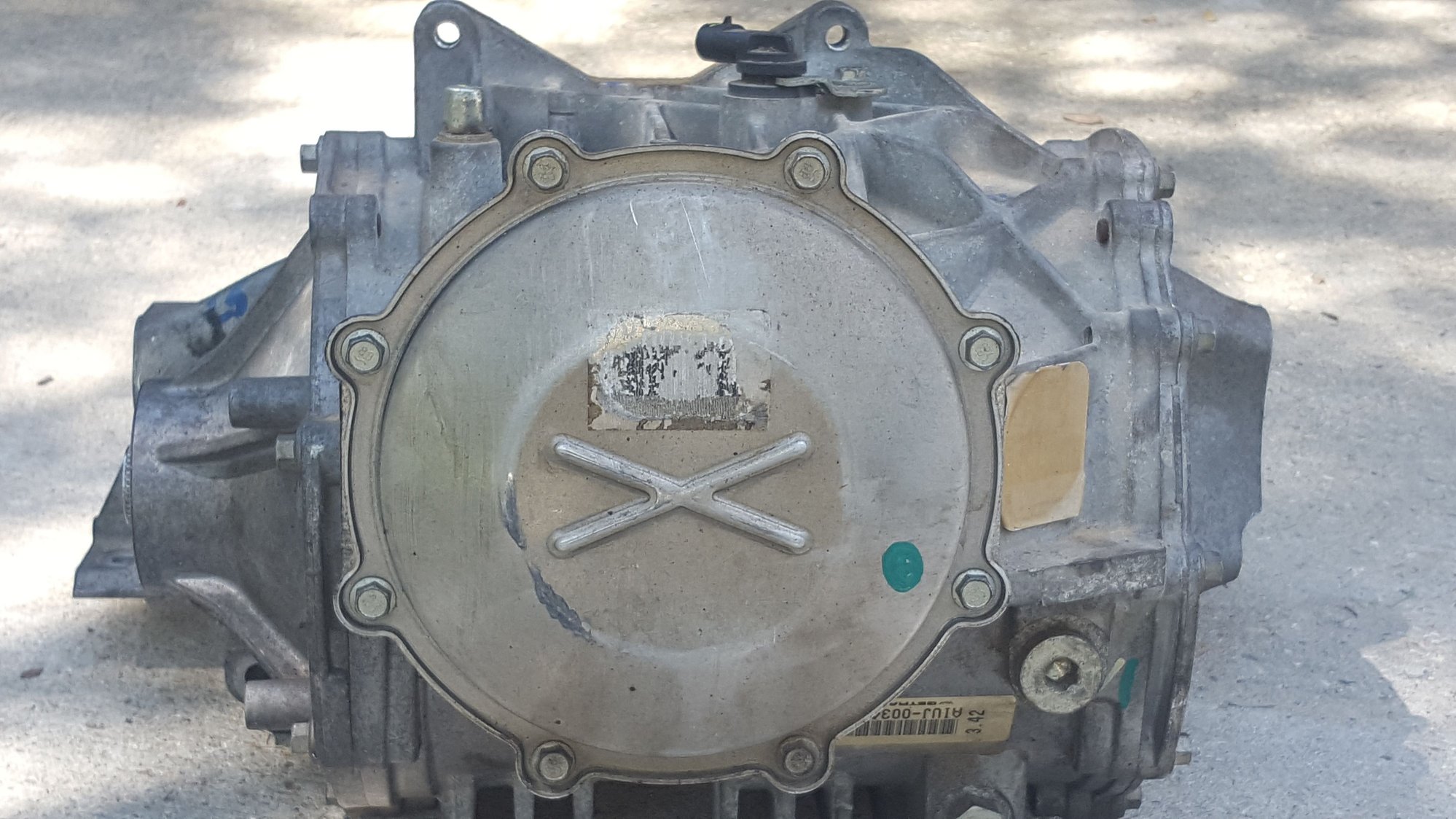

This an 09 diff?
