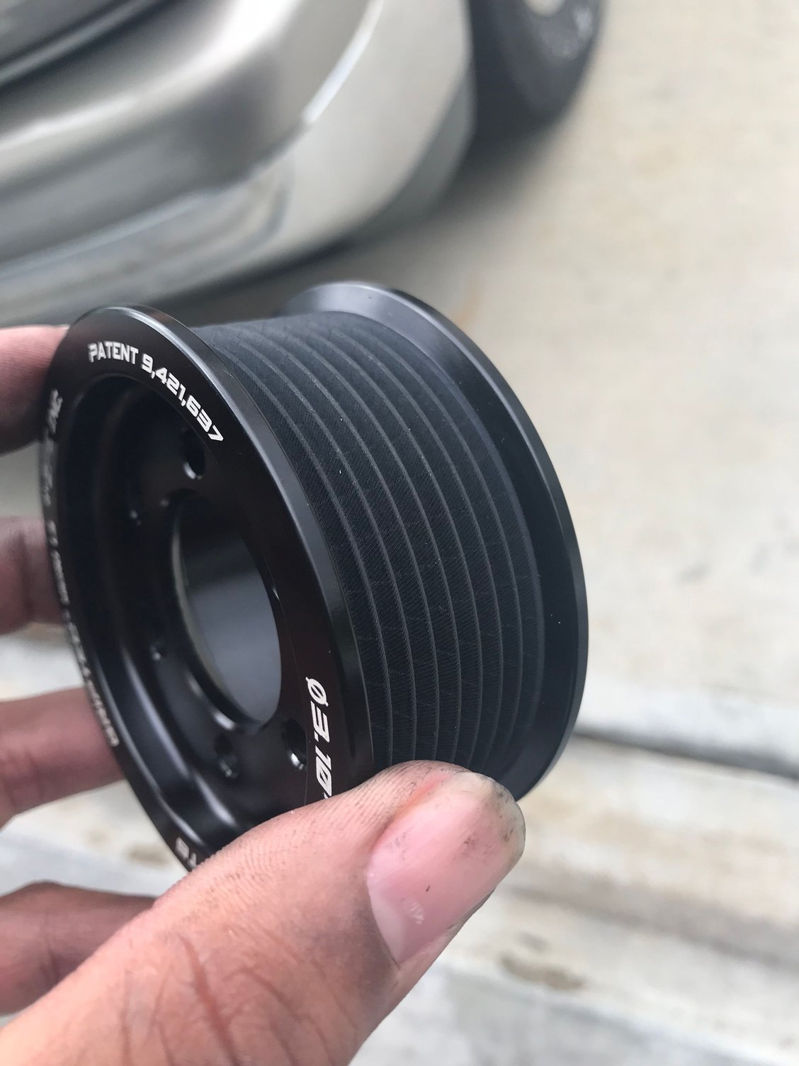

I just wanted to let you guys know. I am working with z-industries in helping them get a line of pulleys for us. Now I have the test pulley and they should be good to go for other orders I do know that everything is aligned and works with the ecs kit on a ls3. Any other kits or engine combos I am not certain. I have been fighting the 6 rib just like everyone else before I upgraded and went the direct drive route I want to give them a shot sense I come from a supercharged viper and they made pulleys for us. Now I can say the 6 rib is very problematic but with this pulley combined with the ecs heavy duty tensioner I am seeing 14.6 psi on the east coast in North Carolina for anyone that wants to do elevation calculations. from a 3.15 pulley in a 6 rib belt. For comparison reasons same pulley 3.15 that was carbonite Coated only gave me 12.8. The boost numbers to me are substantial when you take in that the cost of both pulleys are almost the same but one is providing more grip.

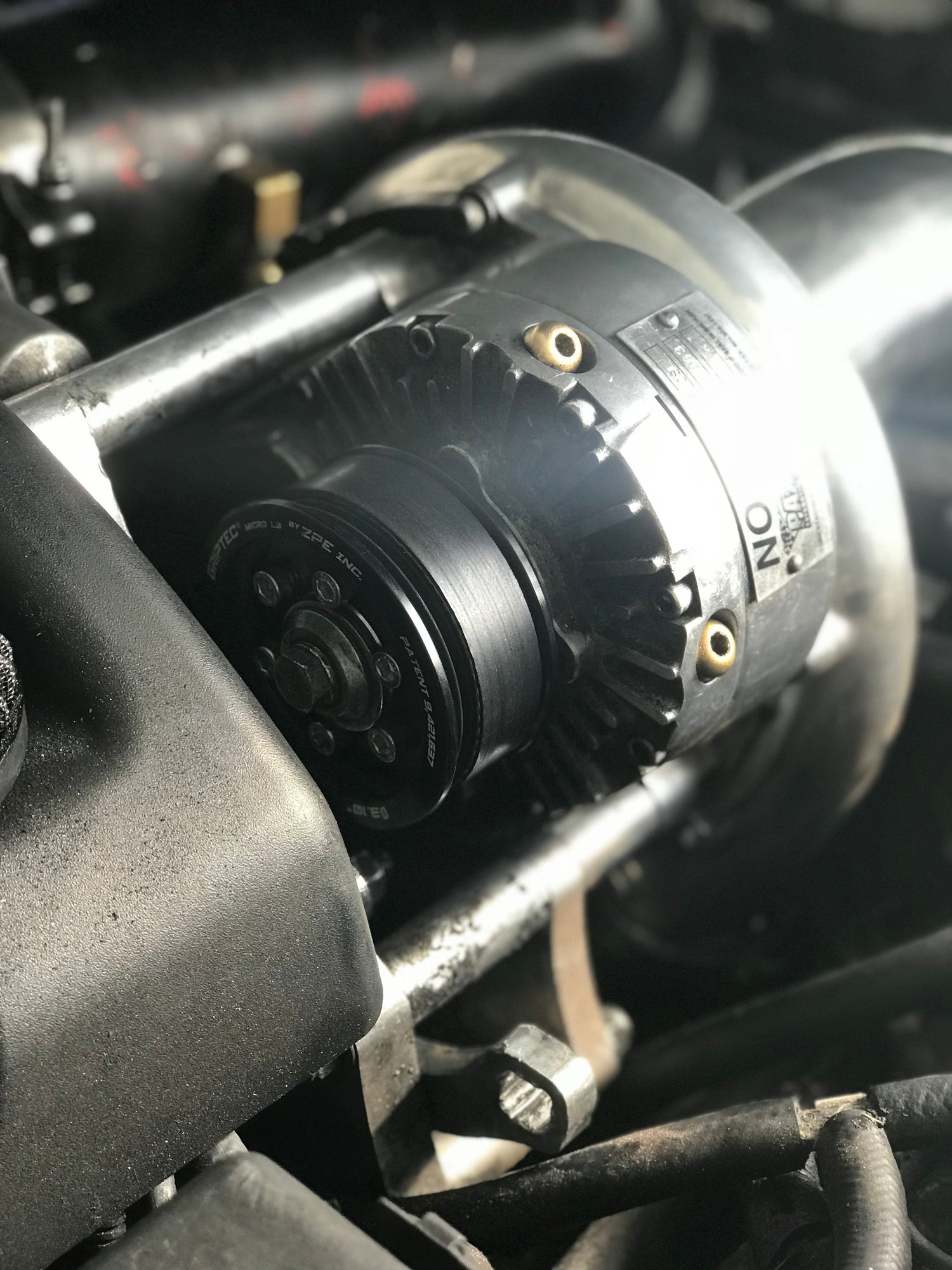

I also forgot to mention that they come with a hub. So there is no need to move the supercharger forward anymore to put pulley pullers on to take the pulley off. Just unscrew the allens and the pulley comes off easy. The process that they told me they use is pretty cool also. they actually grind the ribs for the the belt and re weld new ridges that are stronger and the slits on the ribs are actually welds. They told me that they won’t get clogged and they are self cleaning so if anybody has had a carbonite pulley then they know you have to clean the periodically. This pulley is supposed to be maintenance free.

Interesting, I know A&A cuts ridges in their pulley below a 3.125, and if I was gonna have belt slip I was gonna try and get a lite coating by carbon coatings, it helped a buddy with slip on his maggi.

Looks nice, keep in mind that you are over spinning the blower with a 3.15 though.

Pulley comes off in <2 minutes on my ecs kit. No need to move supercharger forward, or touch anything. Just undo the one bolt, slide it off, slide new one on.

I'm actually running one of these on my d1sc procharged vette. used to have a slash cut pulley but this seems to work better. I used to have an annoying issue where if I was in 4th gear and WOT it to redline then would have zero slip and make full boost to redline. But if I start in 1st and then 2nd, 3rd and then 4th, done that way I would get a tiny bit of slip in 4th. I think probably from the belt stretching and tensioner not holding it together as well. It wasn't a big deal but this fixed that. Also way easier on the belts than the slash cut pulley was.
my supercharger pulley also comes off in about 2 minutes with one bolt.
