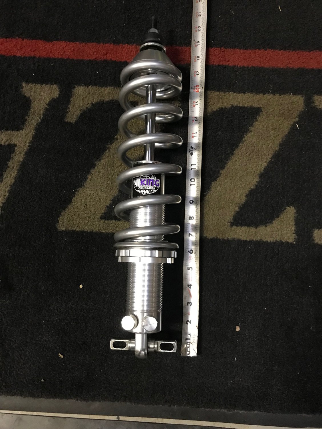

Here's a few pics of the front c/o, they appear to be ~19.5" tip to tip.

Thanks. Those look just like mine. Unfortunately, I didn’t measure mine though. I’m going to find out what the difference between the “A” and the “C” though, and will post back on here. I’m anxious to hear if you have any interference problems when you install them. I took mine off the other day to change the upper shock bushings out. The crappy rubber ones had started to distort as well. I changed them to some poly bushings I got from Jegs. When I did that, I turned the C/O around so that the the adjuster ***** are pointing in, which makes them a bit more accessible, but doesn’t do a damn thing for interference , which I knew that couldn’t be the problem, since the mounting lug on the bottom is perfectly centered. If it was offset, then it would make a difference.
