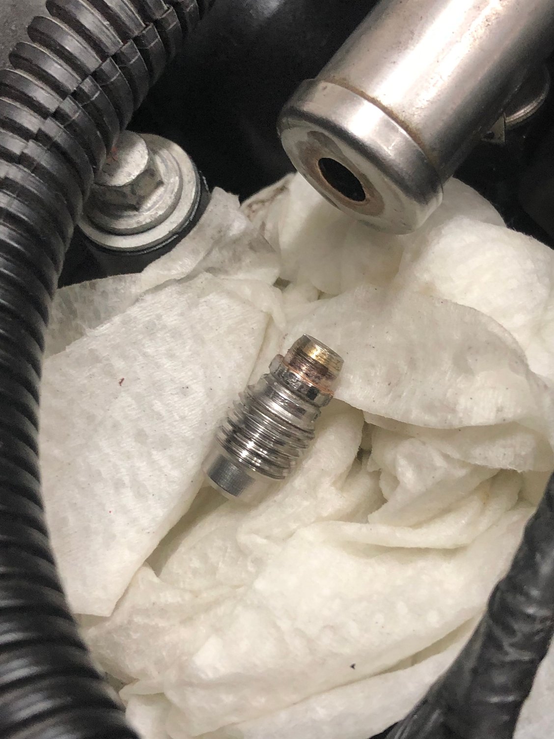

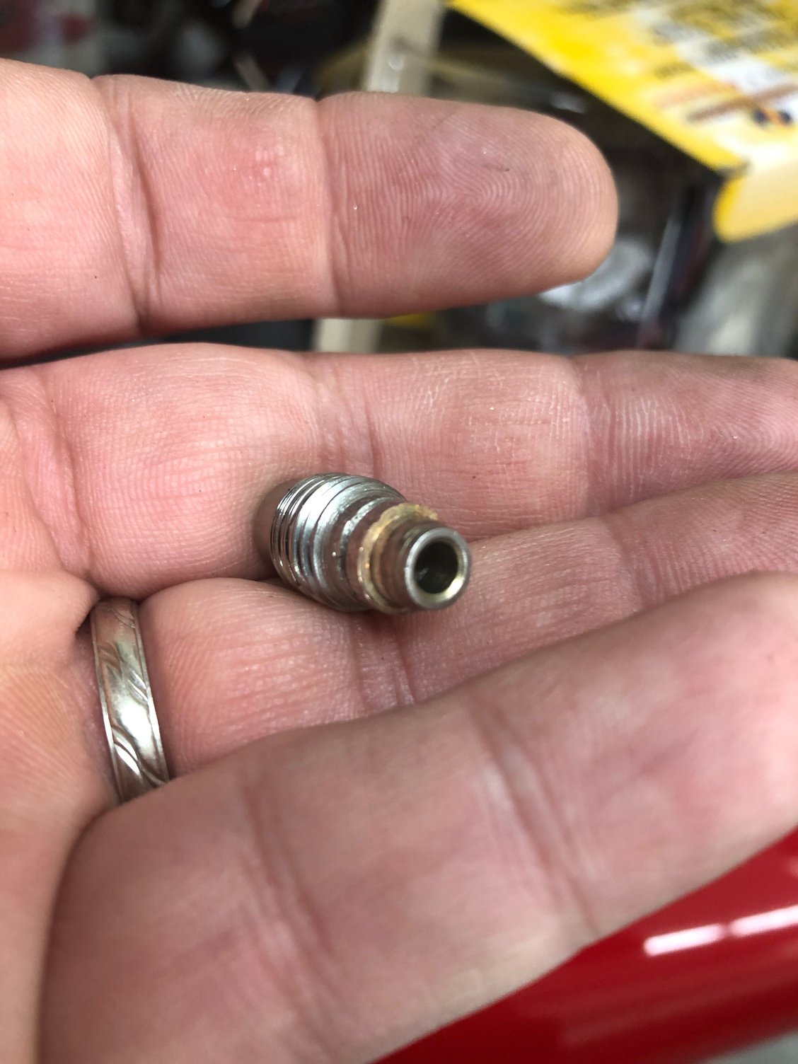

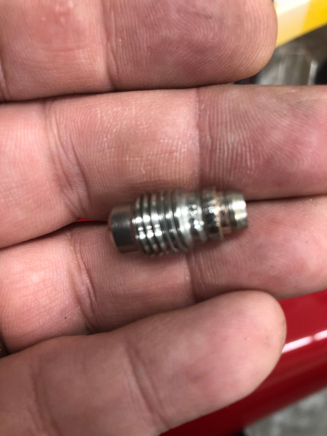

Ok - now i did it.
I was taking my fuel rail adapter off of the shrader valve and twisted it right off.
Can this be reattached? soldered? Replace the rail?

****, that sucks. Unless you can find someone who you absolutely trust to weld that back up properly and pressure check it for leaks, I would toss it and buy some aftermarket rails and be done with it. Or buy a new stock rail and invest in a standalone fuel system. If you’re using a serious amount of nitrous, that’s the best way to do it anyhow, rather than pulling fuel from the rail.

Now just think if you had an extra fitting hanging off of that. Go aftermarket rails or feed from the line going into the rails.

Man....You had to have ate your Wheaties before hand haha.
If you decide to run another stock rail...
https://www.nitrousoutlet.com/fuel-d...l-adapter.html
or..
https://www.nitrousoutlet.com/fuel-d...e-adapter.html

I had my schrader removed so I can install a -6AN return on the stock rail. it's difficult to tig weld, because it's so thin. the tig didn't have much to hold onto, I had it brazed welded on top of the tig. been holding solid for 5+yrs
