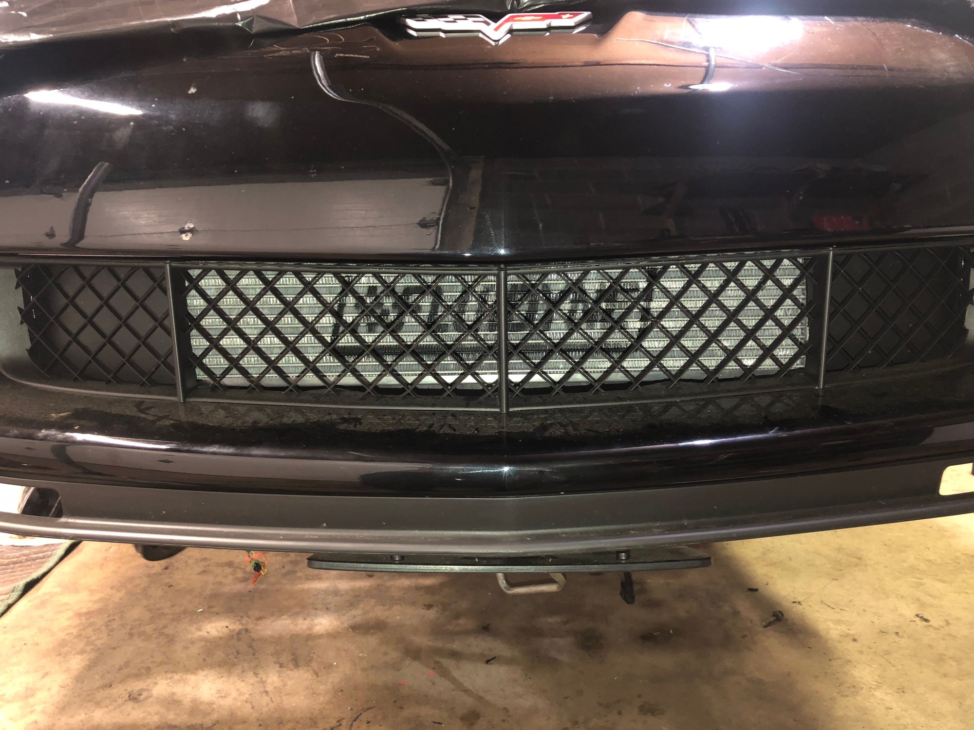

I have I fluidyne HX and 6 gallon tank from PNR in my trunk. IAT’s never to above 10 degrees ambient. Spend the money once.
Old Jan 31, 2019 | 10:25 PM
SSmoked1's Avatar
SSmoked1
Joined: Feb 2011
Posts: 76
From: Parma Ohio
The part number for the HX and dimensions. It fit perfect length and width wise on a 06 c6z. Just had to move the horn.
FLD-FHP35-CTSVHX

I just found this one 7.5 gallons i think ill go with this one powder coated black
https://www.lethalperformance.com/pn...oler-tank.html
now for the pump and lines? what did you go with and does anyone know how the edelbrock heatexchanger does compared to the HX listed above? they're both around the same price i just dont want any cooling issues as it will be driven hard

Here’s the details on the PNR tank I got. They said the Davis Craig pump is recommended for DD/street cars. I started with a LSA blower on 12lbs and now have a LS9 on 18lbs with that trunk tank and HX. ZL1 lid and brick. No heat soak issues. No IAT issues. Made over 800 wheel on e85. Get that HX and similar trunk tank and you’ll be fine - with room to grow.
Size: 7.5 gallon 14x14x9Color: Powdercoated blackHose and install kit for pump: 12an Hose and install kitcap selection: 10" Easy spin off and leak proof Black and Red . Best cap for sealing and easy access for ice.Feed fitting size on tank: 12anAdd external pump: Davies Craig 150 and fittings to mount the pump to tankReturn fitting on tank: 12an
