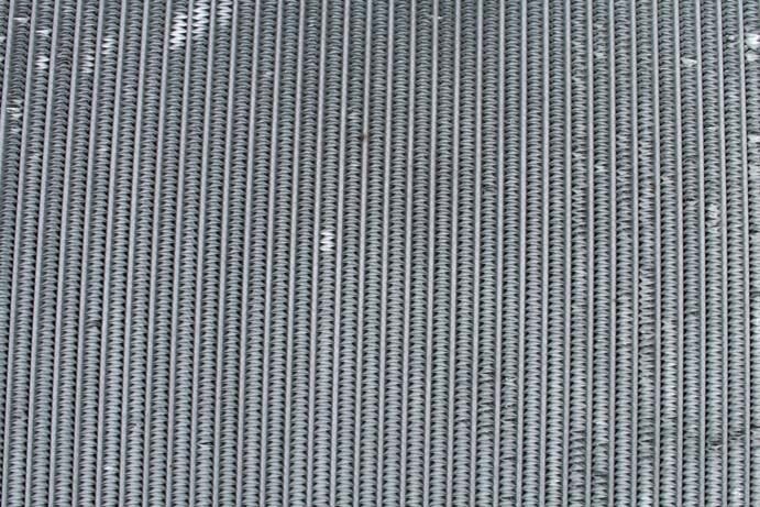

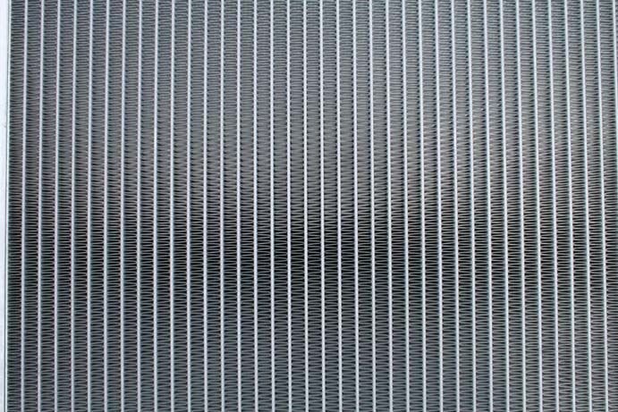

I went back to the top post and I noticed you purchased the radiator used. Maybe the seller was trying to get rid of a problem. Sometimes a pressure spike in the system can expand the flat cooling tubes and this crushes the fin and closes off the air path through the radiator. It crushes the fin very evenly so it's hard to tell unless you are really looking for it. An easy test is to slide a zip tie through the core and it should come out the other side. If you can't do it, something is wrong. See these two images for a good and bad core
BAD
GOOD

Temperature will not do it. This is typically caused by engine exhaust, compression stroke, or backfire getting into the cooling system via a bad head gasket or compression leak.
