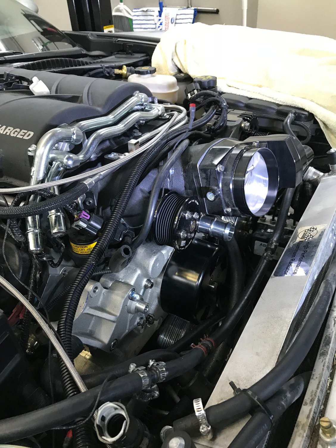

Well today my factory water pump pulley failed. Just like many others at the weld. Ive been doing some research and found out that some guys are using the Edelbrock 8893 High Performance Water Pump. I am considering doing the same thing. However all of the parts stores say it is not applicable with the 2008 LS3 because of the clutch fan? Has anyone done this replacement with the Edelbrock 8893 High Performance Water Pump? If so, what did you have to do to make it work and what pulley did you use? Ive also seen were guys welded the factory pulley, and some changed a tensioner. I just want a solid mechanical water pump so i can just installed it and forget it. Ive looked and seen Holley has a water pump and the pulley has no welds on it, but I have not seen any reviews. And I seen a lot of guys used then Evans water pump but for for some reason I cant find that part number. Guys with experience, please dime in. Thanks
BTW the car is a 2008 LS3, ECS supercharger set up

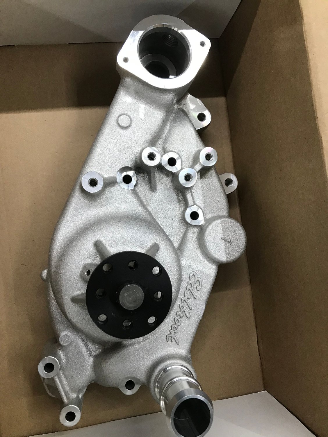

I’m running the Edelbrock, albeit the 2009-up model which has the radiator hose outlet on the left side. It’s actually the same casting, with provision for the radiator outlet on either side, and Edelbrock simply drills and installs the outlet on the drivers side for the 2009-up motors and on the passenger side for 2008-down motors. You would need the earlier-model style, unless you want to change your upper radiator hose and switch your outlet over to the other side of the pulley.
Please note that the pulley in the photo is NOT the correct pulley, but is in fact the pulley for the Victor series model, and I had to machine 9/16” of the back side of it to get it to work. You will need the #8899 pulley. https://www.edelbrock.com/billet-pul...8894-8899.html
Between the Edelbrock pumps price and buying the pulley separately, its not a cheap solution, and it doesn’t seem to cool any better than the stocker (although I’ve never had a cooling problem) but you won’t have to worry about breaking the pulley again.

Thanks for the reply. Like you said with the set up you have, I wont have to worry about any pulley failures again.

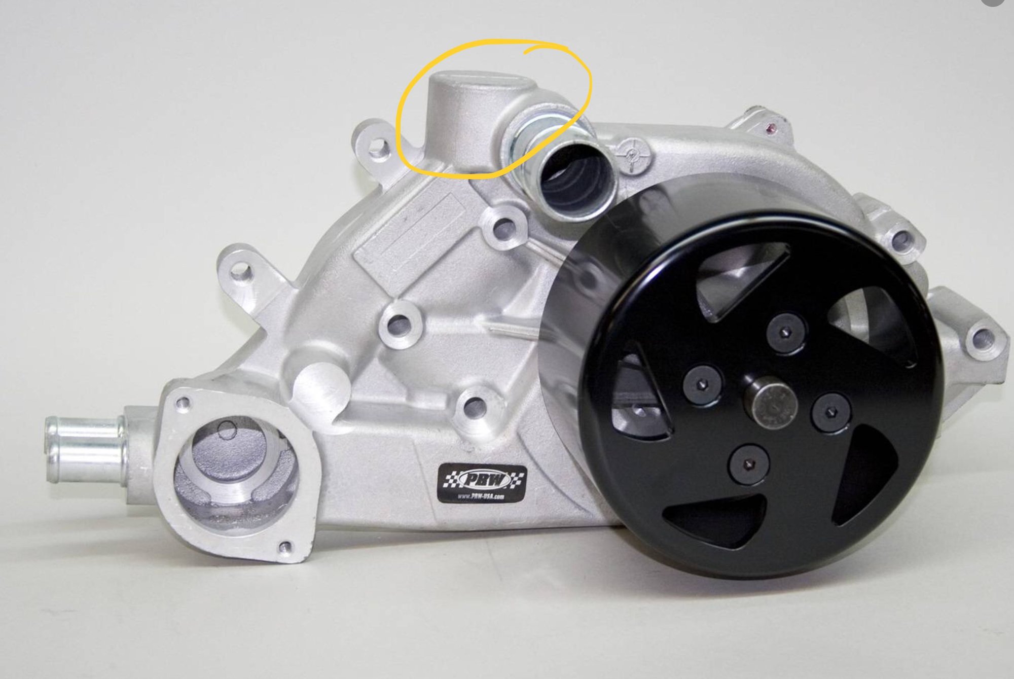

I also found this water pump by PRW, but I have not seen any reviews on it. Has anyone used this?

As far as the PRW pump is concerned, my only worry with that would be the boss on top of the pump body which is cast to allow for the outlet for the truck applications (circled in yellow in the pic below). That may very well get in the way of something like the supercharger bracketry, but I can’t say for sure. Something to bear in mind though.
