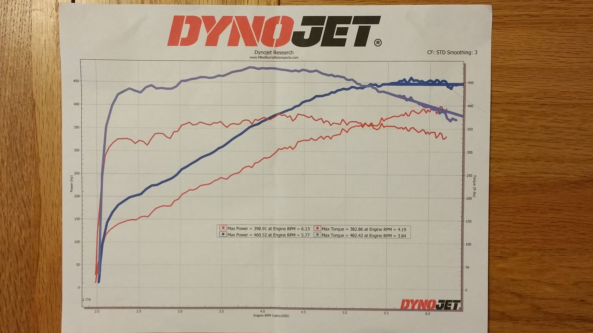

So I had my car re-tuned yesterday by David Griffen of GriffTuned LLC near Indiana. My car is a 2011 Grand Sport 6-spd manual. I installed an E-force with a 3.5" pulley, BAP, Kooks headers (with cats), and a Monster LT1-S clutch.
The Edelbrock provided tune was way off. Car made near stock HP on that canned tune. 398 HP and 382 TQ. Could easily feel the car didn't have the power it should
Had the car initially dyno tuned at Norris Motorsports on a very hot and humid day. He did a okay job on the tune and final numbers were up to 460 HP and 480 TQ. I had posted those results here previously and a lot of people commented that my numbers were a bit low. I had thought it was because of the hot humid conditions. As I drove the car more and more, it still didn't feel quite right.

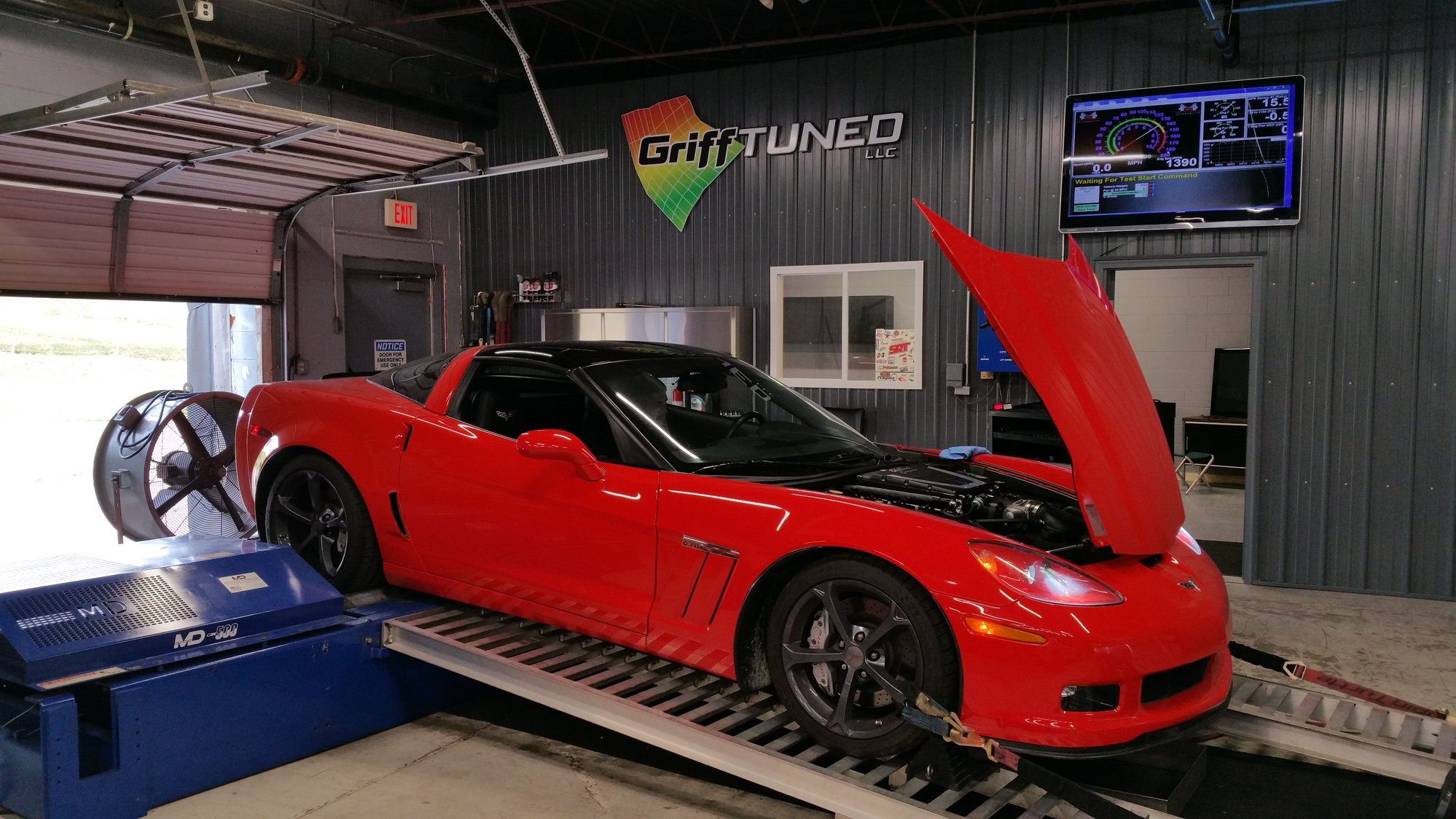

Had it re-tuned by David Griffen. Final numbers were 519 HP and 519 TQ. David was able to diagnose that I had a bad ignition coil. It was misfiring in the upper RPM's. Once that was taken care of, the dialed things in. Very impressed.
Well, not ok of course.
Having rwhp far from promised is always a sign of some sort of problem.
If something mechanical is way off (as your your rwhp numbers suggested) tuning should be stopped right away.
Very good!
