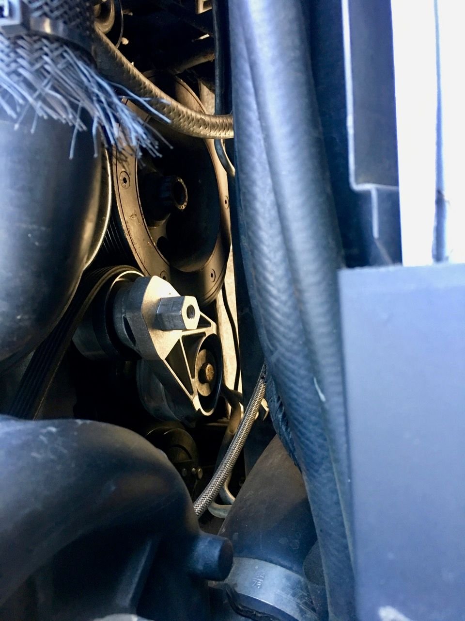

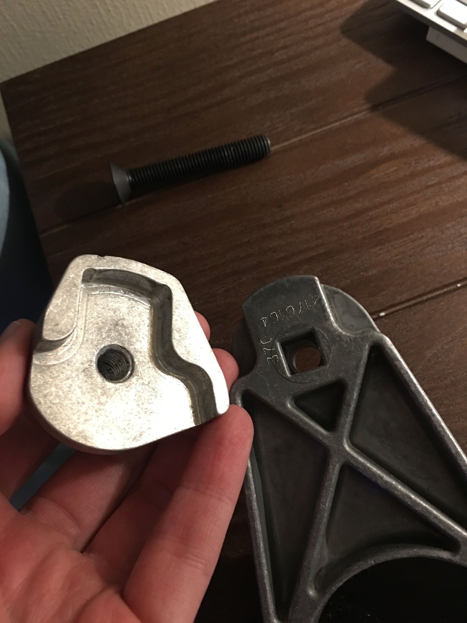

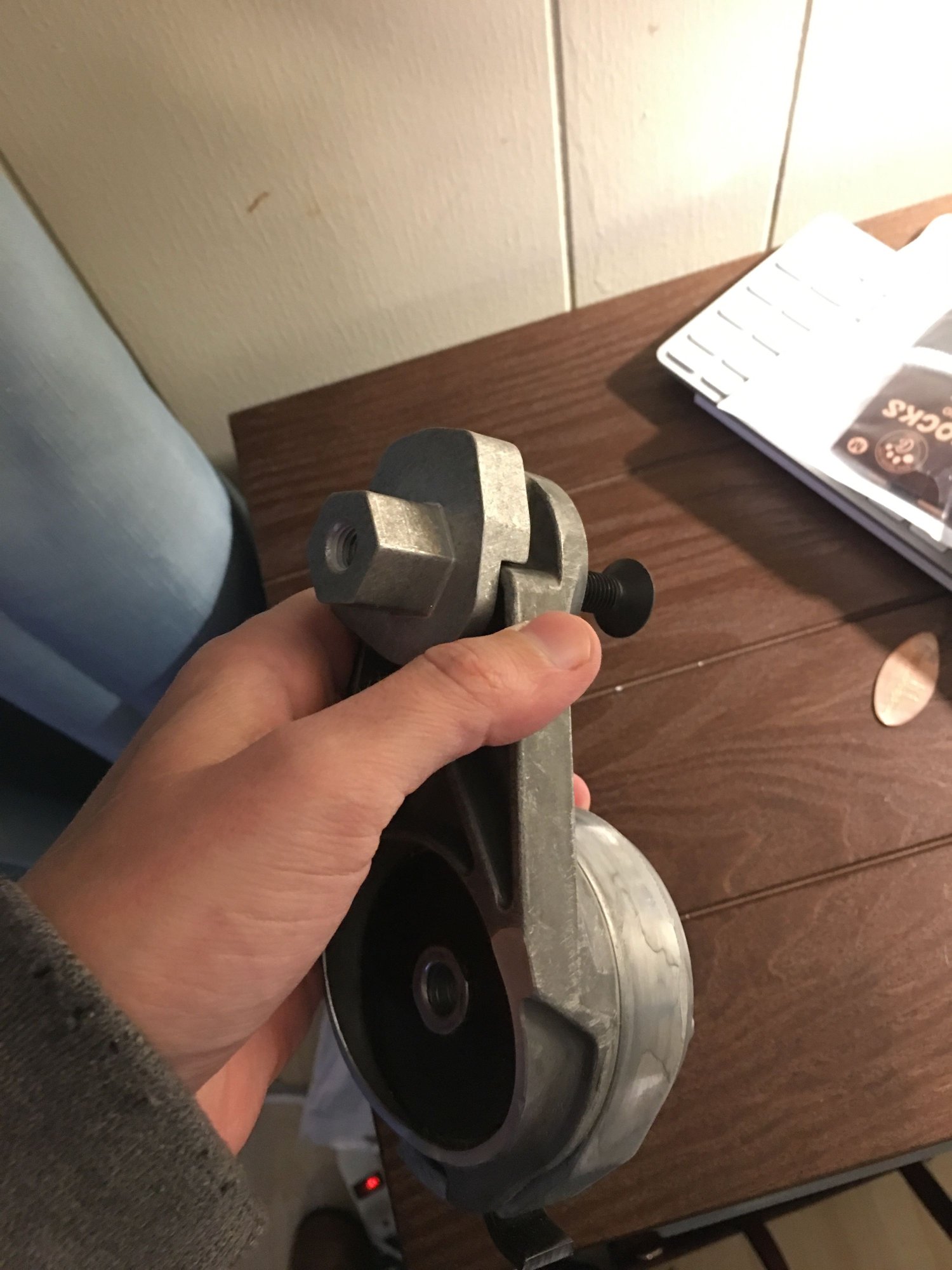

The 3/8" square slot where you use a ratchet to hold the tensioner open gets stripped out pretty easy if you aren't careful. I have heard several people complain about it and I stripped one myself too. Mainly because that tensioner is a beast, and the aluminum around that opening tends to be soft.
I have this on mine now, makes a HUGE difference.. I just crank it down with 15/16" socket or whatever it was and it doesn't matter if I'm using an extension, flexible head ratchet, it ain't stripping. Makes belt changes a lot easier for guys doing it in the driveway solo. The bolt for the pulley goes through and holds this thing on. It just slips over the end of the tensioner, very easy/simple and it works great.
Originally Posted by Unreal
The socket drive on the tensioner to open it up.
I welded a 1" aluminum nut to mine after stripping 2 of them. Been great since then.
Yep, that's where I got the idea.. makes it way easier
