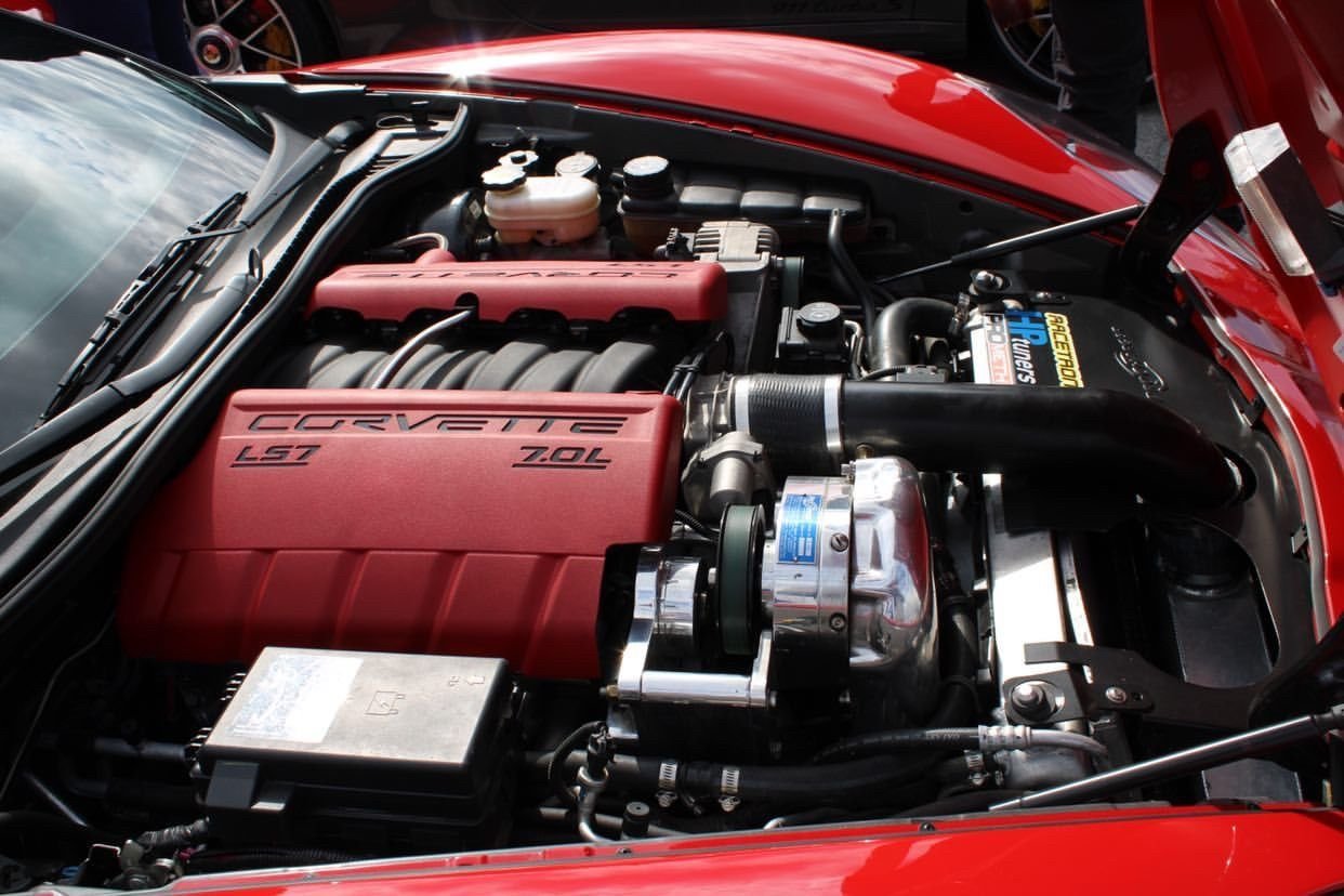

I have a full size on my hci blower Z06. Living in NY I never see coolant temps above 198 with a/c on. I have a procharger race intercooler also.
Old Feb 2, 2020 | 11:21 AM
JetstreamGS's Avatar
JetstreamGS
Joined: Jul 2014
Posts: 2,138
Likes: 204
Thats impressive. I see 205 generally without a/c. Seems like a pretty significant improvement in cooling. No clearance issues? Any pics?

Old Feb 3, 2020 | 12:54 PM
HouseS2k's Avatar
HouseS2k
Joined: Jan 2016
Posts: 907
Likes: 160
Old Feb 3, 2020 | 01:04 PM
JetstreamGS
Joined: Jul 2014
Posts: 2,138
Likes: 204
Looks like you’re running a bell mouth? I’m more curious if my dongle will clear.
Old Feb 3, 2020 | 01:10 PM
HouseS2k's Avatar
HouseS2k
Joined: Jan 2016
Posts: 907
Likes: 160
the factory procharger one clears, I moved onto a Dallas performance I take for cruising. But I mostly just run a turbo guard.
