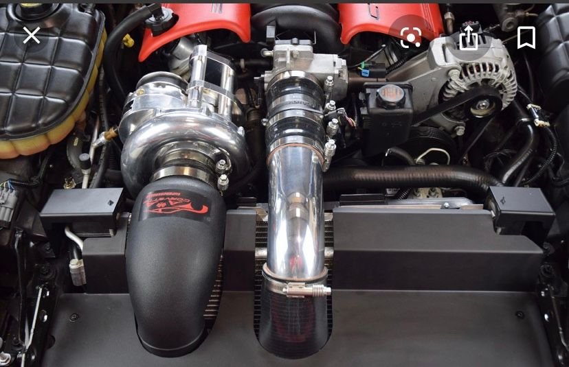

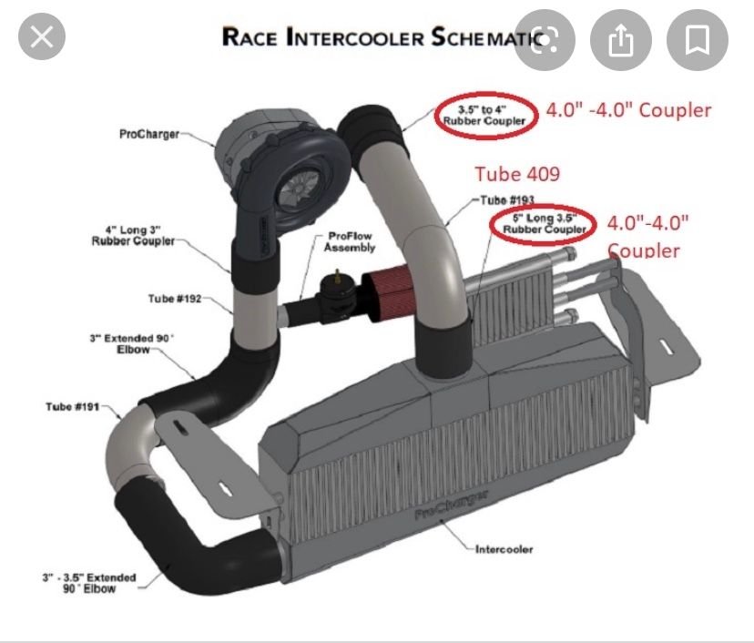

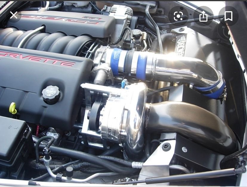

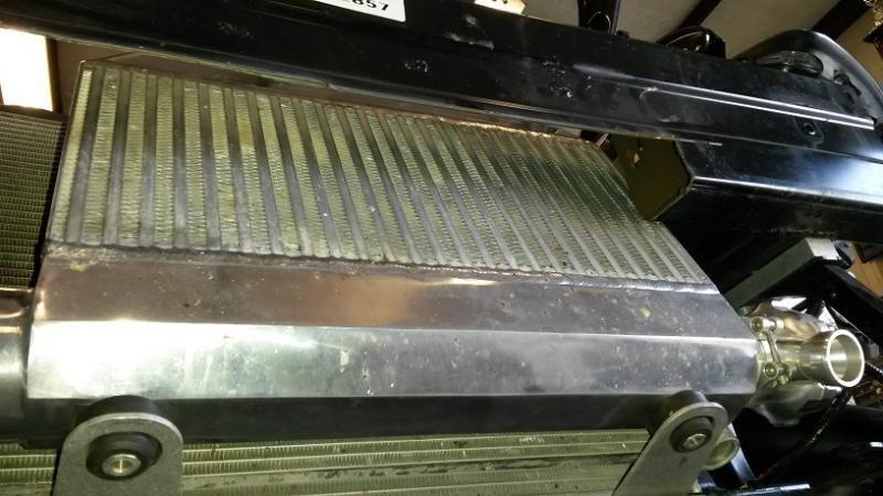

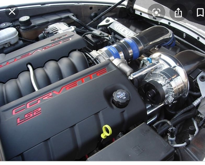

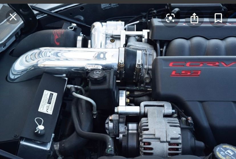

I think the better question is show us what centri blower kit comes with BOV/bypass in the location you recommend based on an article about turbo placement BOV and compressor surge? I can tell you already the 3 centri blower kit manufacturers all have them located before intercooler close to blower.
Now you can move it, mine isn’t in the exact spot anymore because I went with a Tial Q 50mm and we used all aluminum piping removed all the rubber hoses but it’s still before intercooler and close to the blower. I’ve seen some people use the location you speak of but there are zero kits that come with it in that location.

Most of us have meth nozzles spraying just up stream of where you suggest the BOV, again I’ve seen it in that location but never with meth spraying behind it. Interesting all three kits use the same location though...maybe ECS or A&A will jump in to give the down and dirty tech beside what has already been explained as why it’s comes in the factory location.
