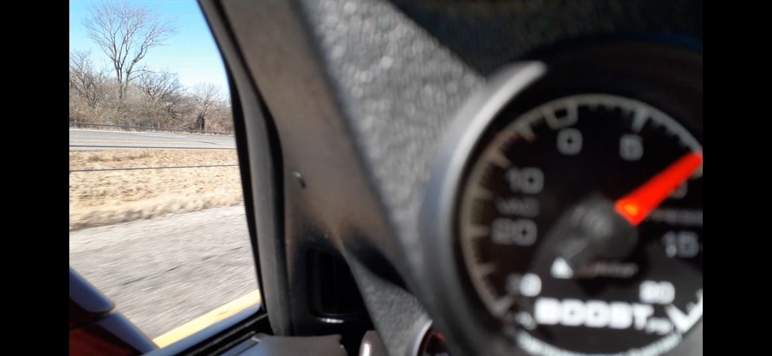

E Force generating 9 psi with 3.8" pulley. 6.0L, stock cats and H pipe probably helped push it briefly to 9psi.
Mods to come if we ever get out of lock down.
