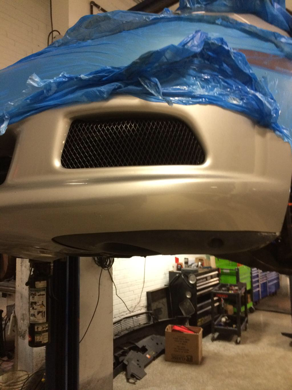

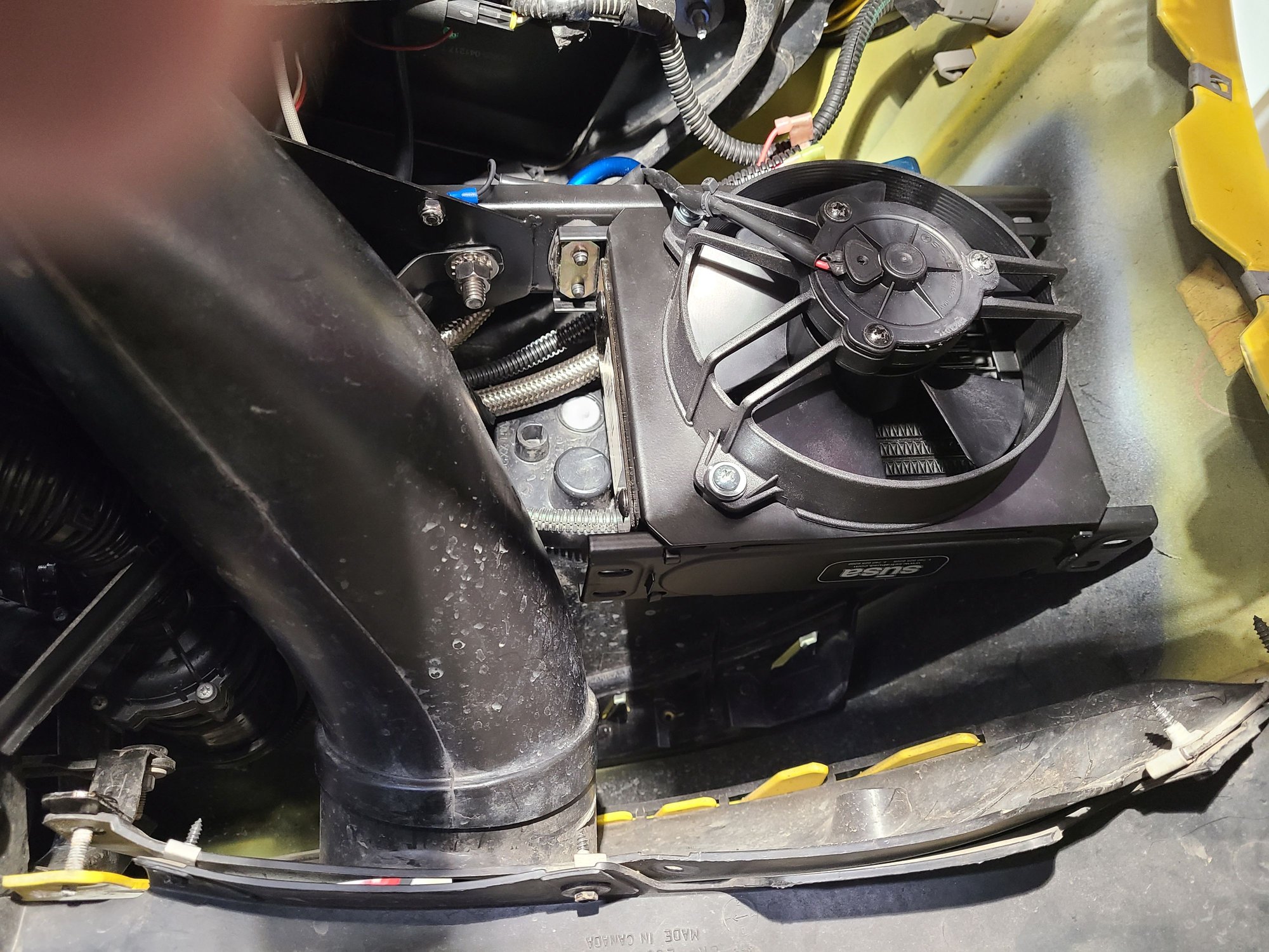

I used the improved racing low profile adapter and a B&M cooler with fan behind the fog light. Replaced lights with mesh. Works great.

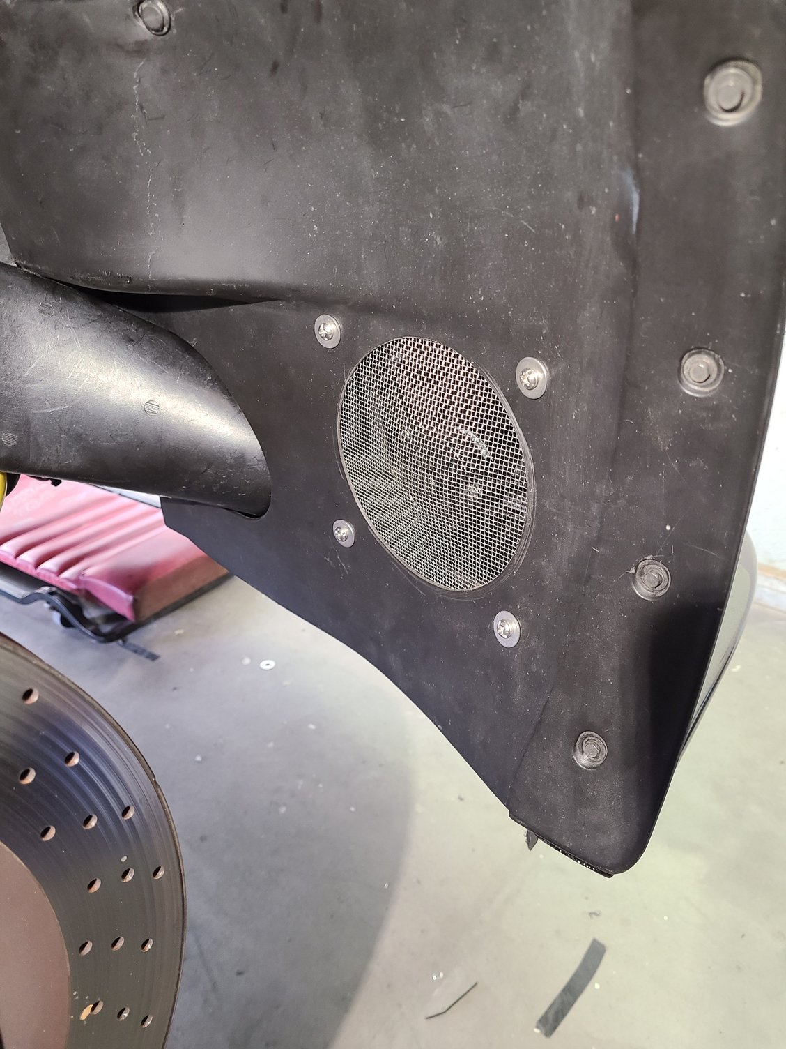

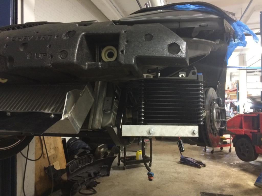

I install this EOC in the cavity behind the left headlights. I sacrificed the cooling duct to the brakes, no big deal as I do not track the car. As you can see, there is no fan, just air flow from the bottom duct. This has worked great and I never see oil temps above 210*.even in hi-90 oat, at cruise speeds the temp in around 195-ish.

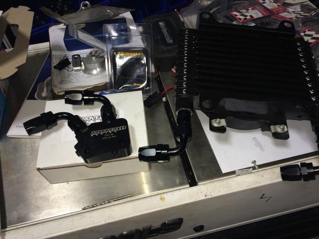

We make a complete oil cooler kit for the C6: https://new.improvedracing.com/2005-...t-ec6-600.html
If you want to piece together your own kit, use our EGM-112 thermostatic oil cooler adapter: https://new.improvedracing.com/low-p...s-engines.html
I assume this is a street car only? If it's a track car, that cooler won't be sufficient. The cooler in your pic is a transmission cooler will provide minimal cooling. Make sure the fittings are -10AN as well, and run -10AN lines. If the cooler has -6AN connections, that's too small.

From: ocean springs mississippi
issues? Pics of brackets/install?
Old Nov 8, 2020 | 09:51 PM
realcanuk's Avatar
realcanuk
Joined: Apr 2011
Posts: 7,821
Likes: 412
From: Montreal
St. Jude Donor '13
Have had no issues in 5 years with this. I do not have many good pics but here is what i can find.

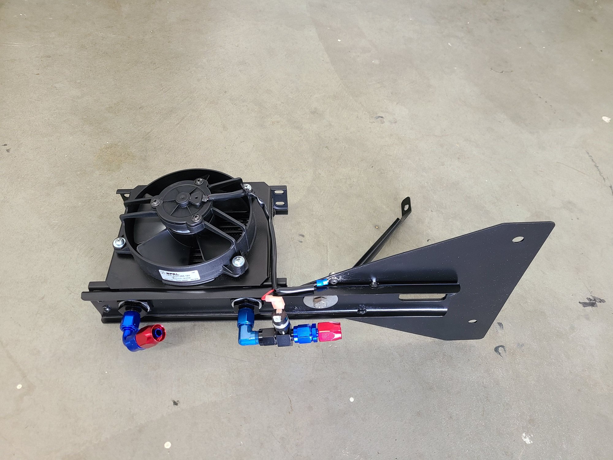

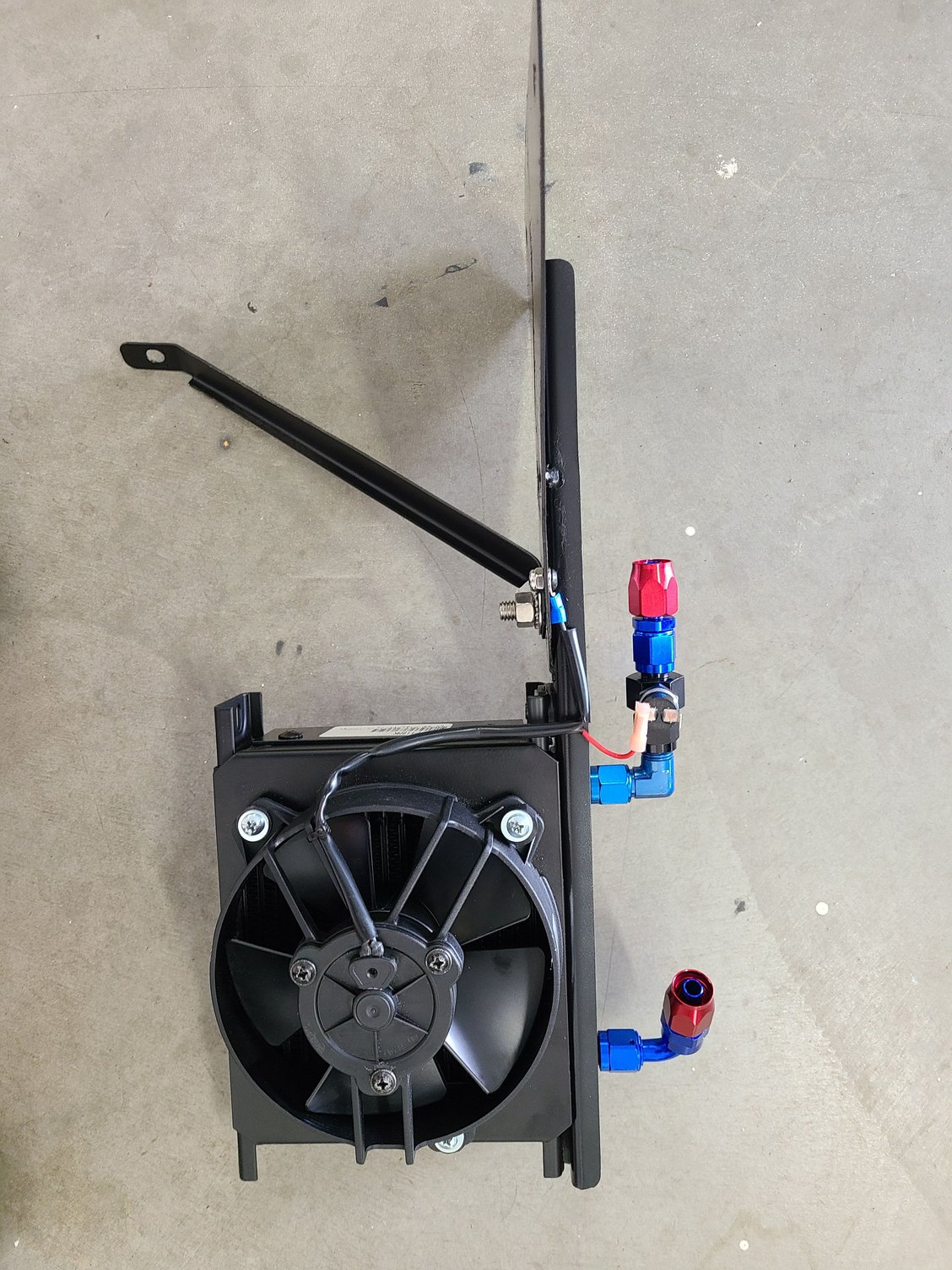

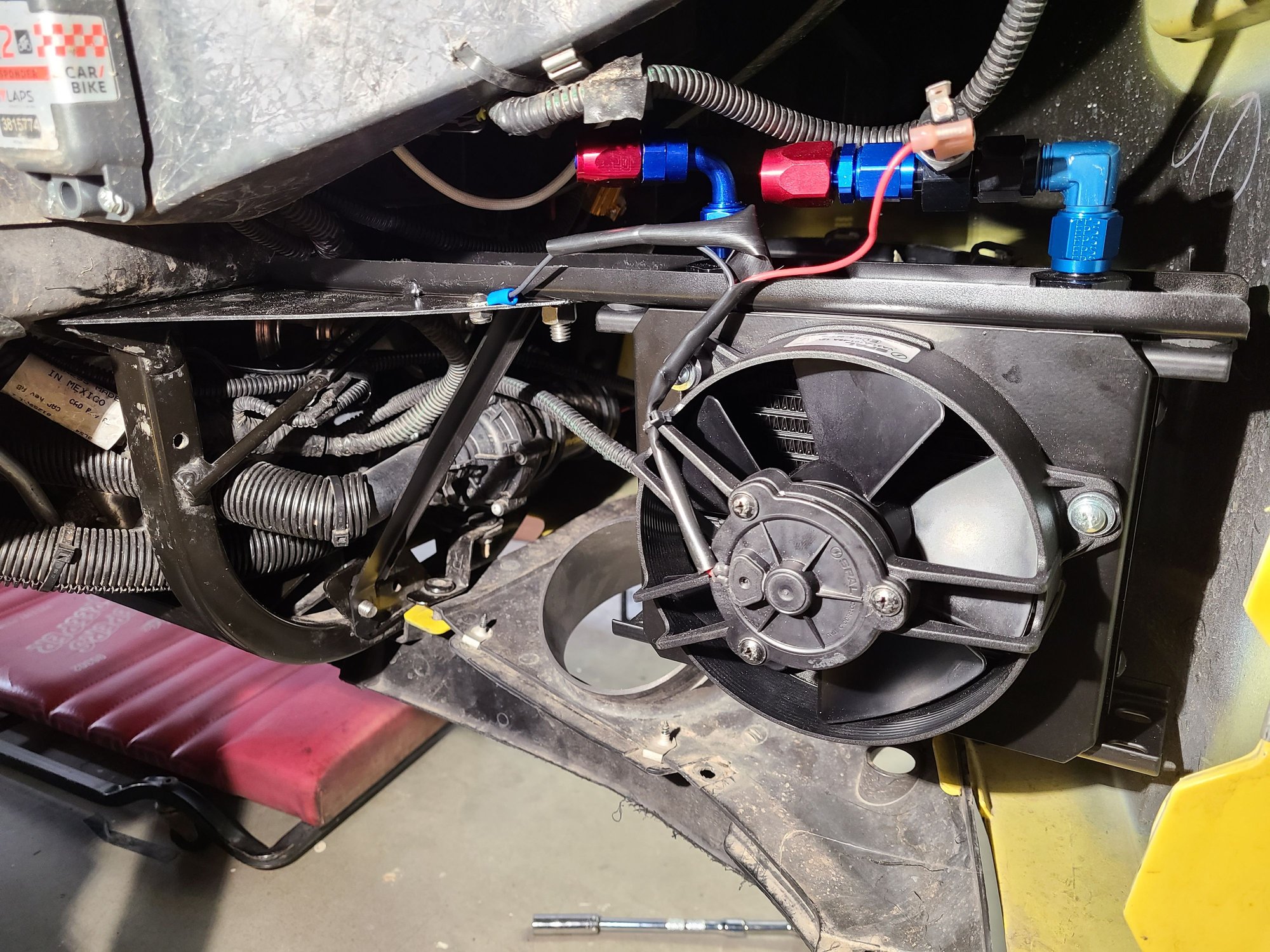

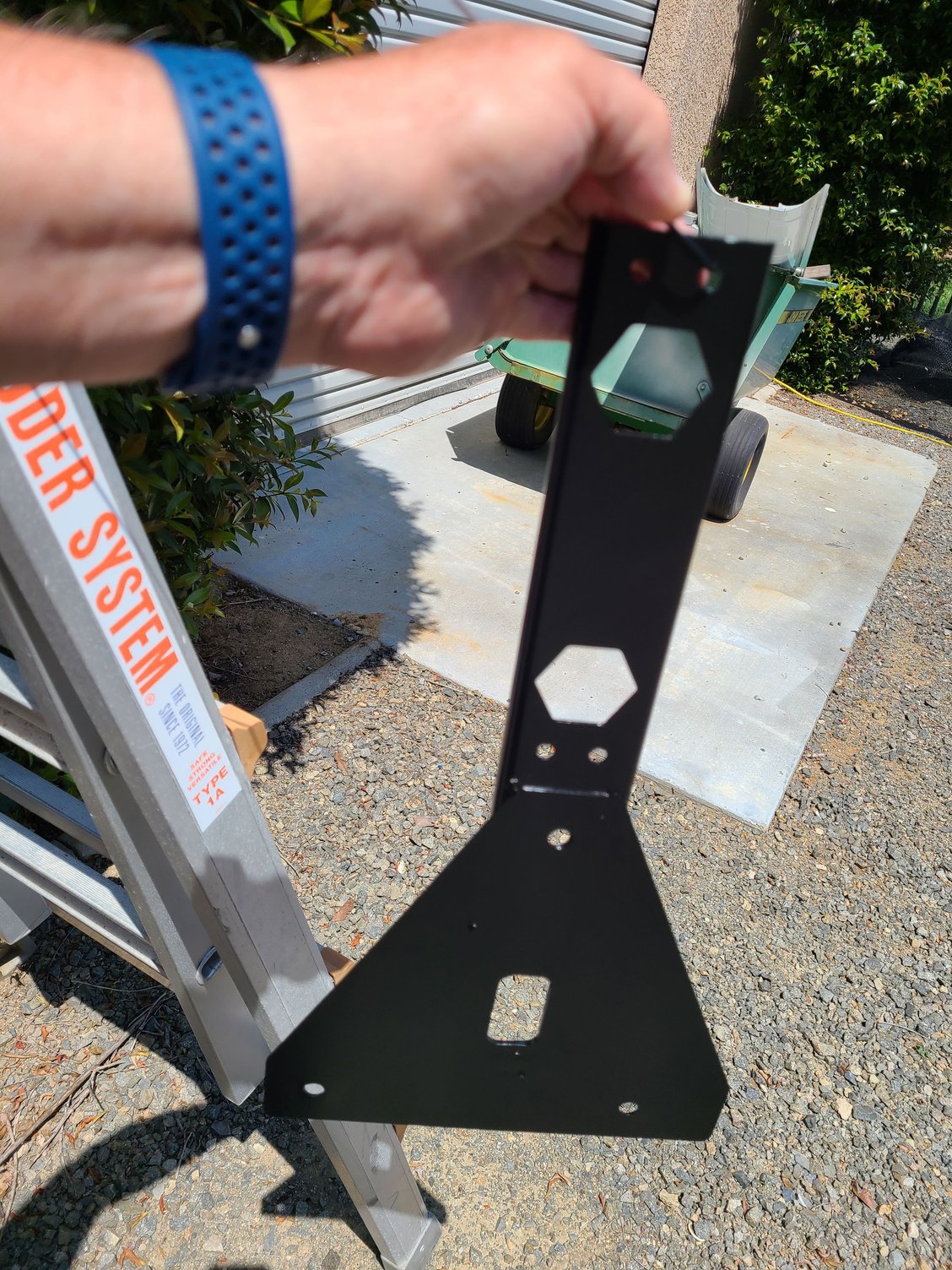

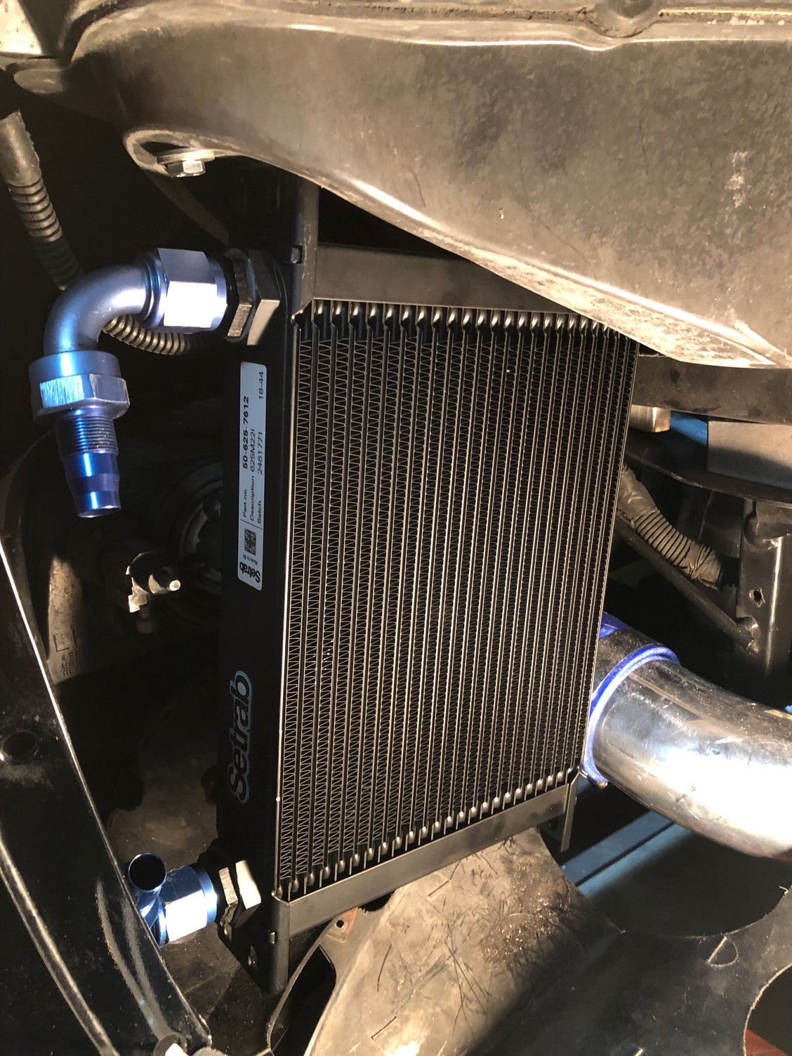

I did it on the passenger side, I think there is more room on the drivers side (no s/c cooling pump). I think my template can flip to the drivers side. I used a different cooler also.
nice design! Yeah my BOV is in the way as well

Default Cooler

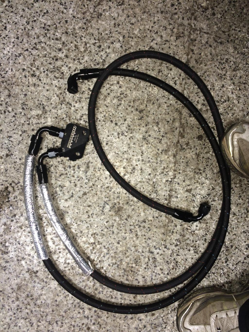

Here are the final photos.
To Oil cooler
