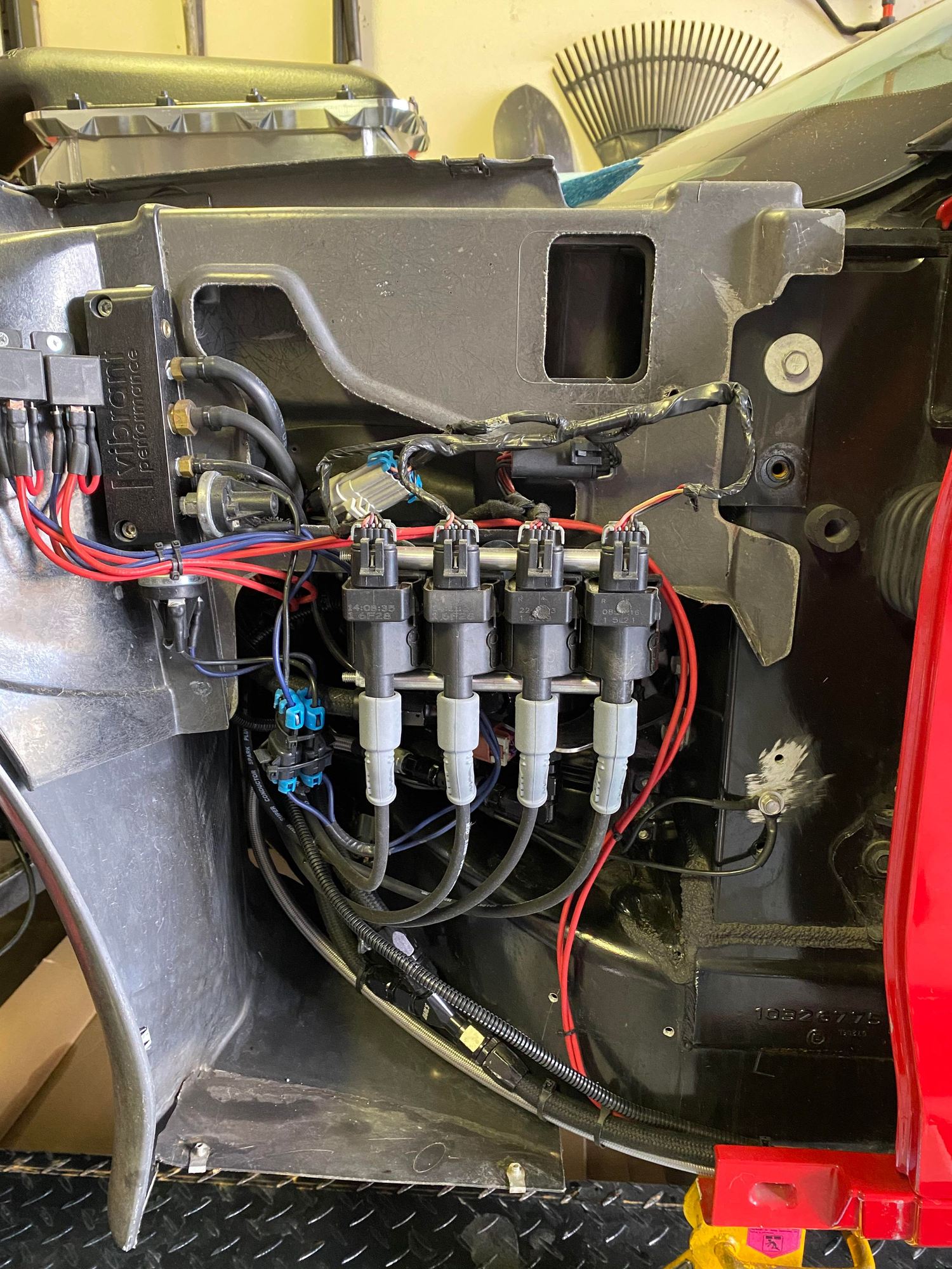

Here's an older pic of how I ran mine:
To Vacuum source
