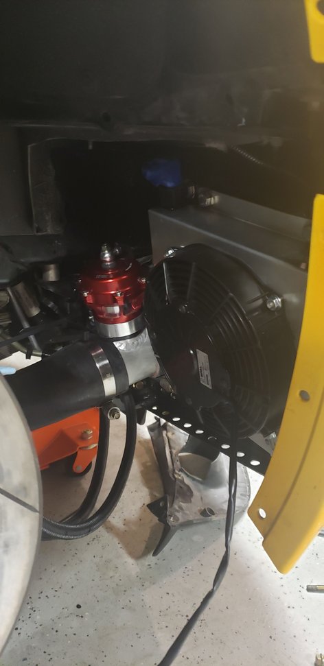

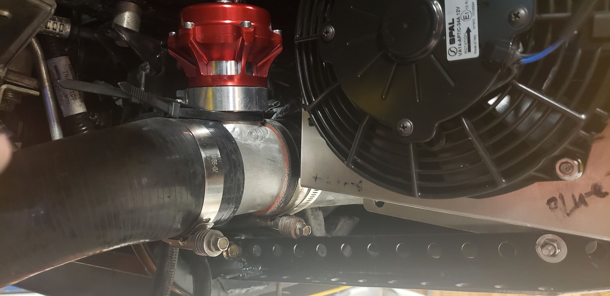

Snug fit...but installed

@C U IN REARVEIW
Nice work!
2 of them?
Do you have pix from further out so I can better understand the location?

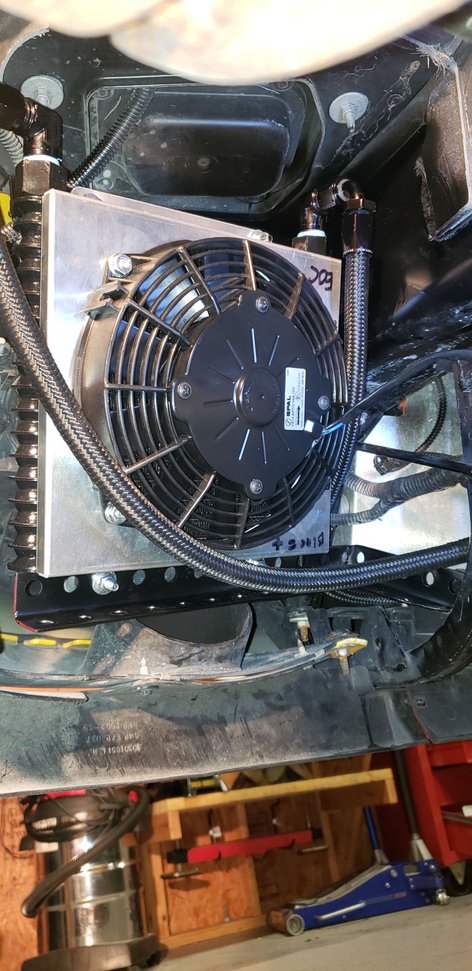

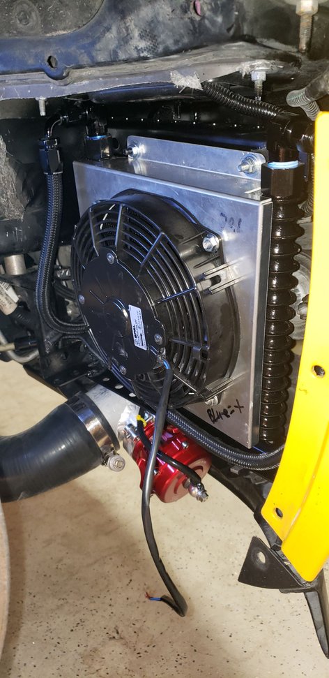

Originally Posted by SteveJewels
@C U IN REARVEIW
Nice work!
2 of them?
They are in the space behind the foglights in each fender well. One for engine oil and one for transmission fluid. I will try to get some better pics.

Old Nov 29, 2020 | 12:01 AM

Old Nov 29, 2020 | 06:21 AM

@C U IN REARVEIW
Thank you!
do you have the fans as pullers like that or pushers? What are your oil temps now compared to before?
they are setup to pull air...although not wired up yet... temps are much cooler (but also cooler outside) than before .

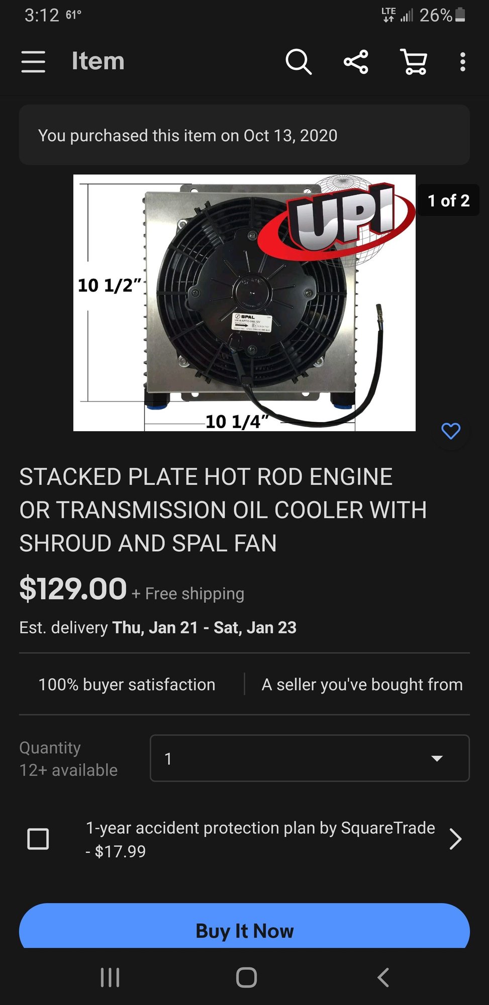

Nice. Would you mind sharing the part number for the cooler?
