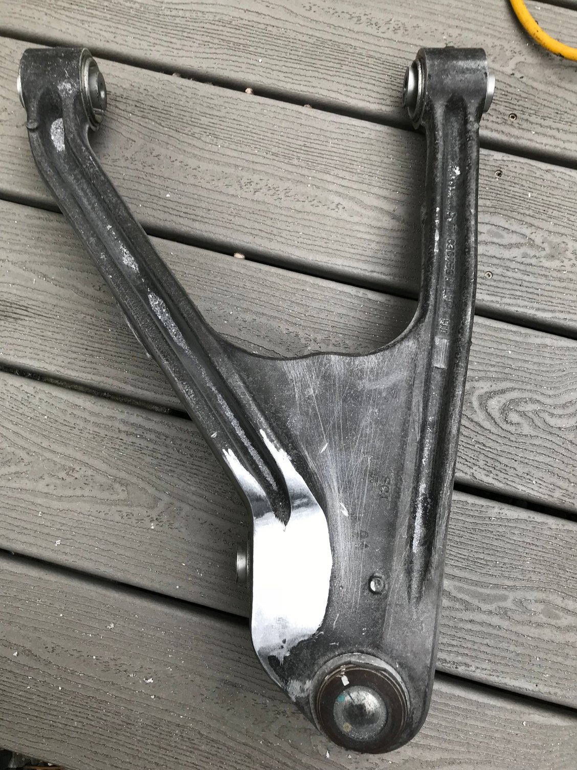

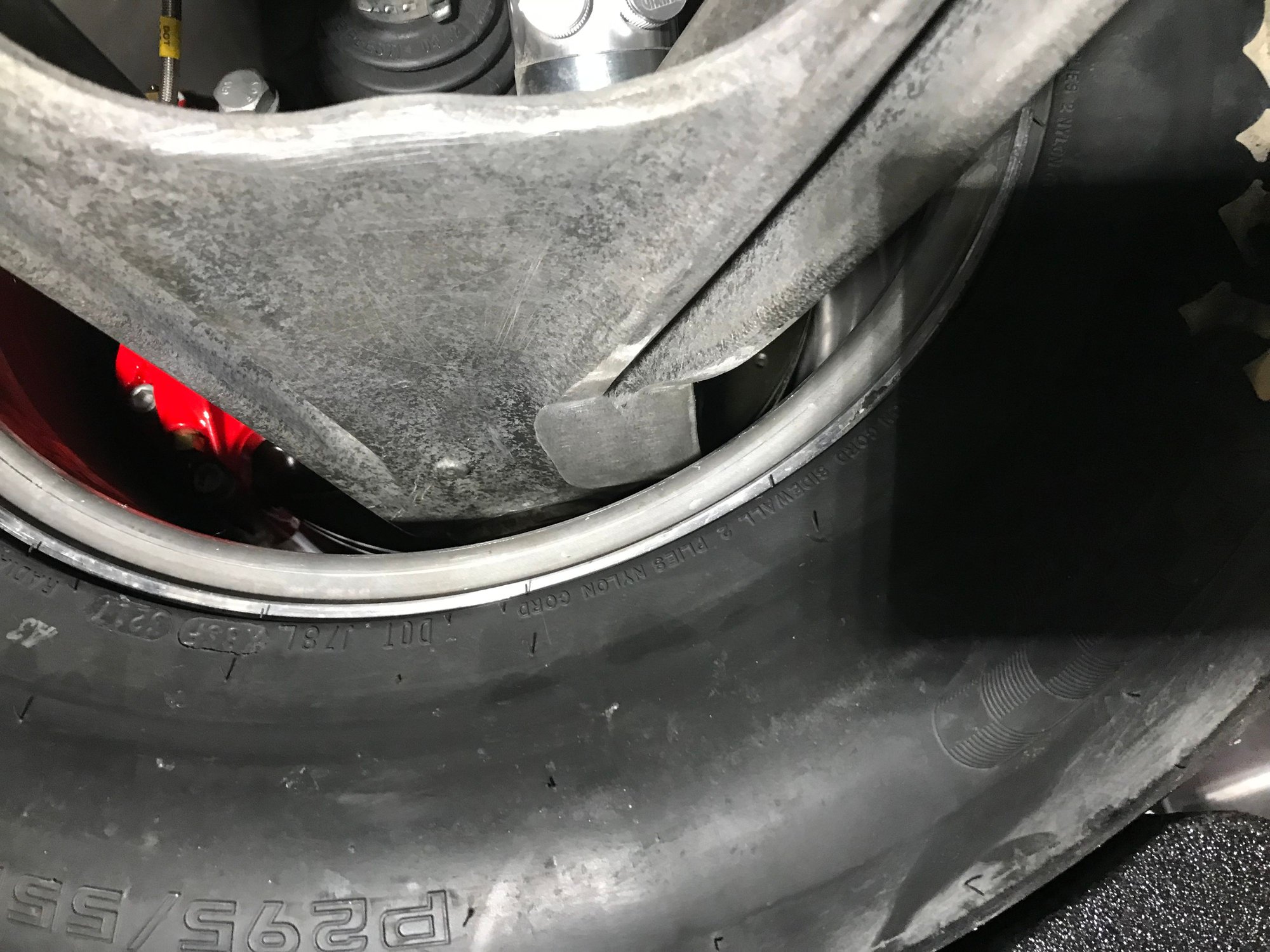

On the lower control arms, I’m including a few pictures so you can see what needs to be clearanced for the 15” wheel. Please note that I followed the pictures a saw online and ended up taking off more material than was necessary, which you can see when you’re looking into the back of the wheel with the suspension loaded.

You can see from this angle that the majority of the material need to come off the rear corner of the control arm.
Here’s a close up, but at a not so great angle
This is what my control stems looked like when I finished cutting them
This shows how much I took off.
