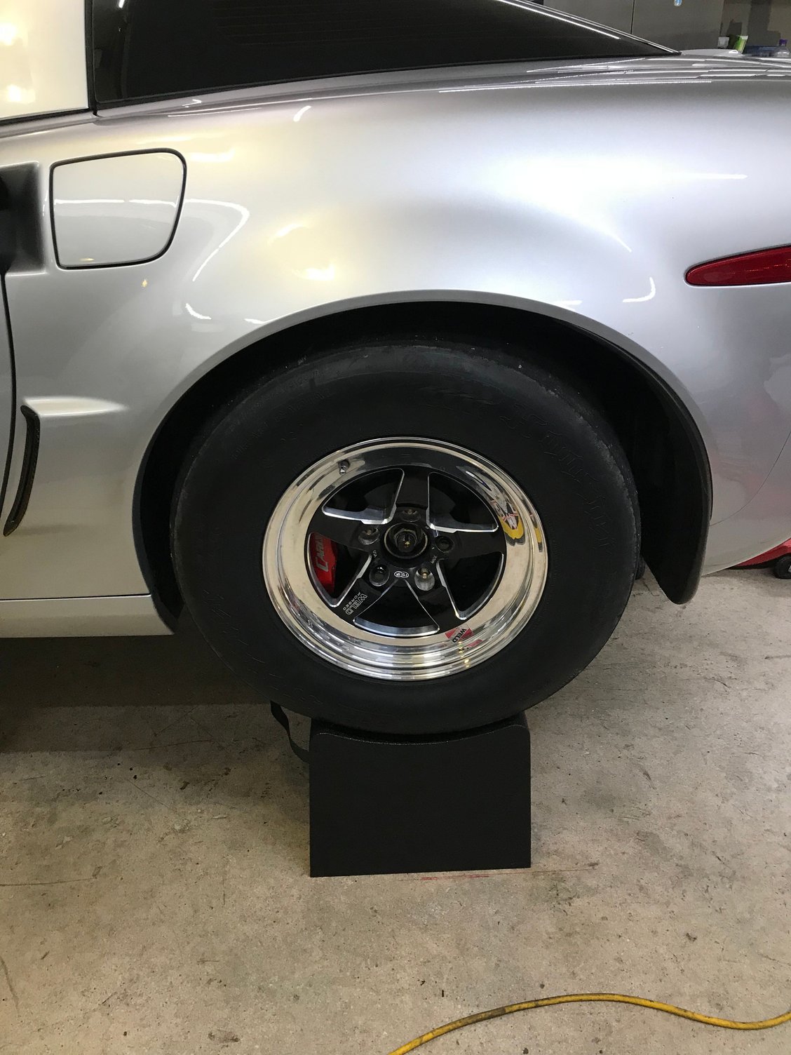

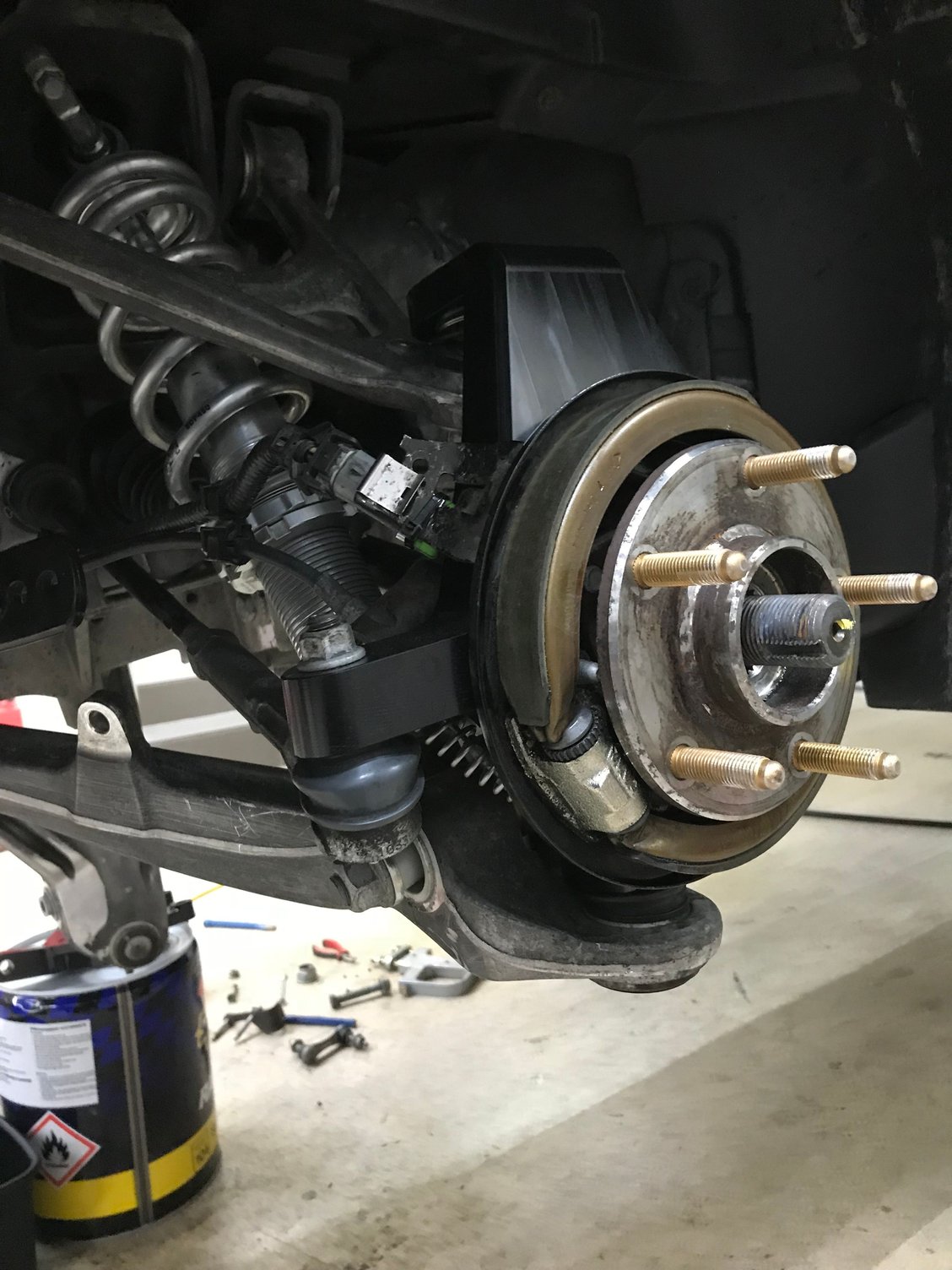

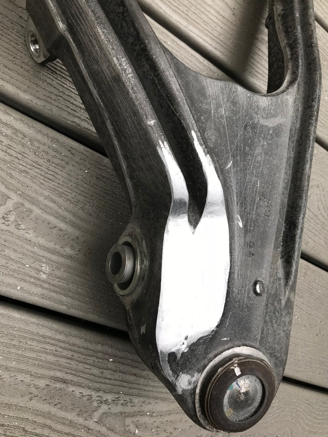

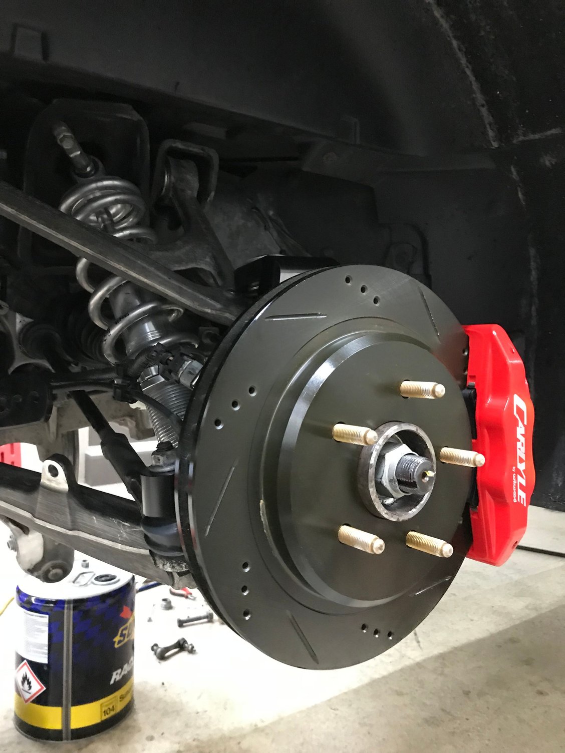

I finally found the time to work on my car yesterday. Got my Carlyle racing 15” conversion spindles and brake kit on. Going to align it today.
I know! It was dirty.

Nice! Did you run into any problems?

No, it all went pretty smooth. I did have to do a little more grinding after my initial test drive. Hey CI, are you running coil overs? What kind?

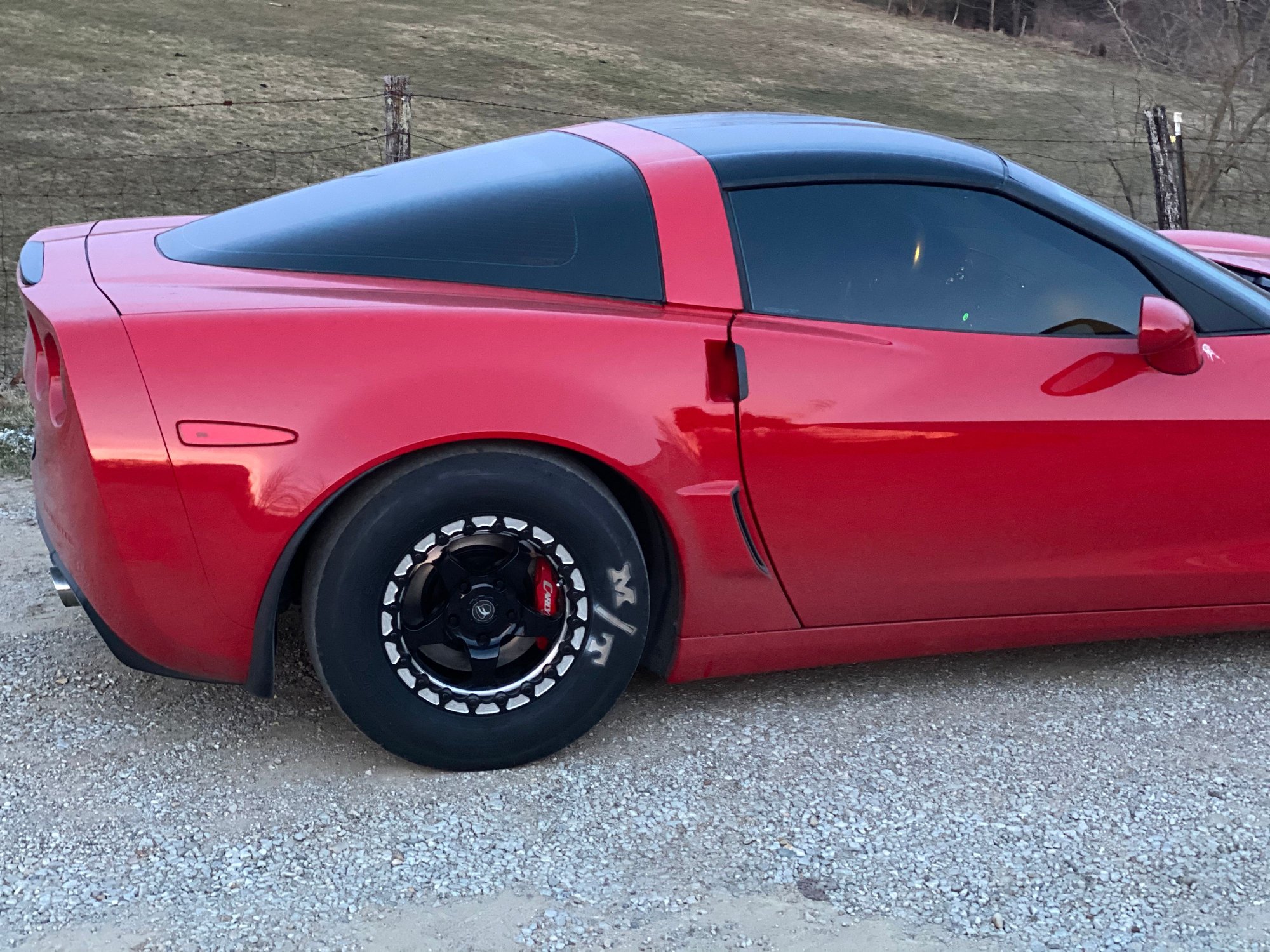

Me? I’m running Hoosier P275/60R15 (17375DR2) Drag Radials in the rear and M&H MSS017 Front Runner, 26.00 x 4.50-17 (165/70-17), Bias-Ply up front.

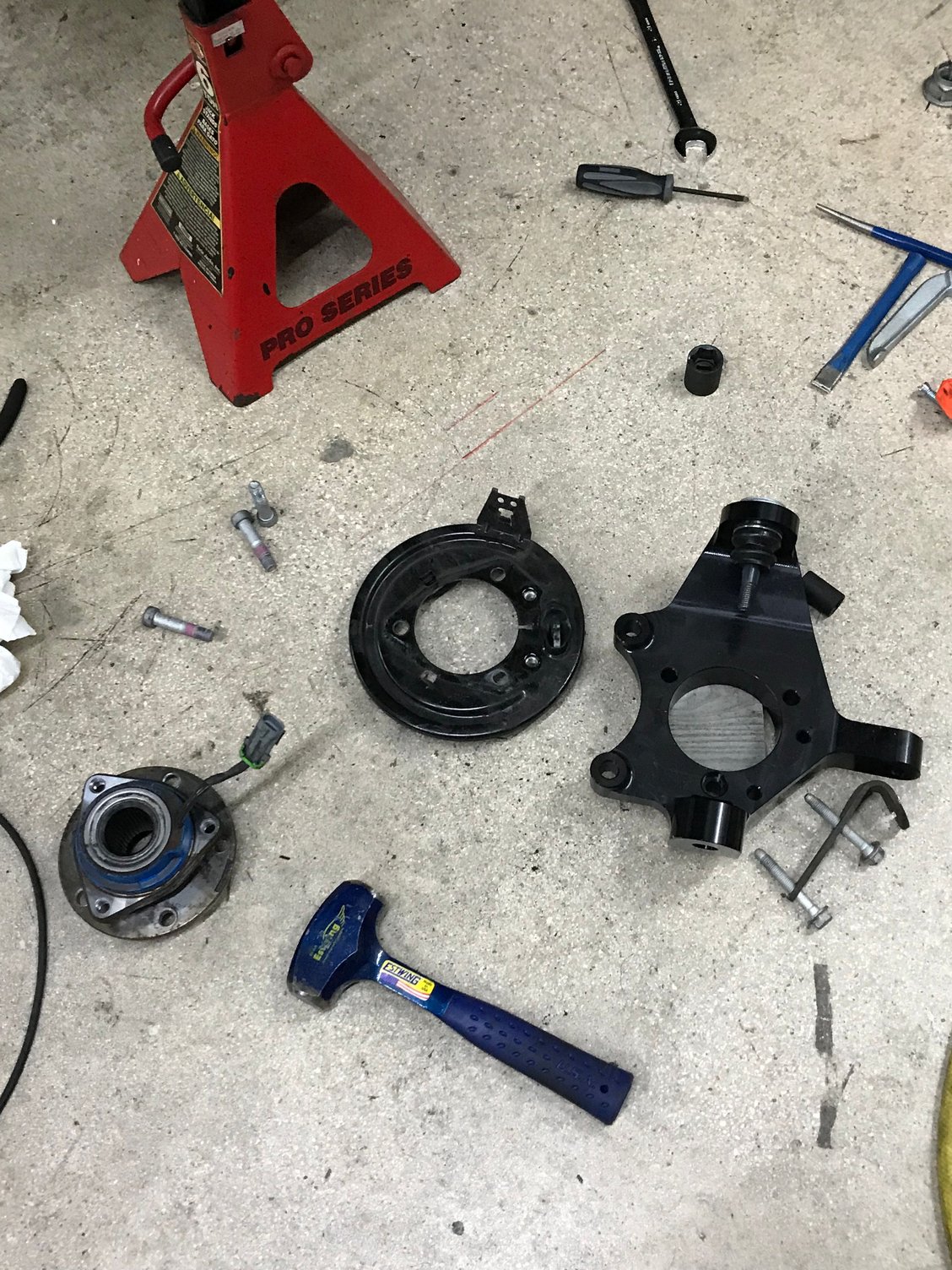

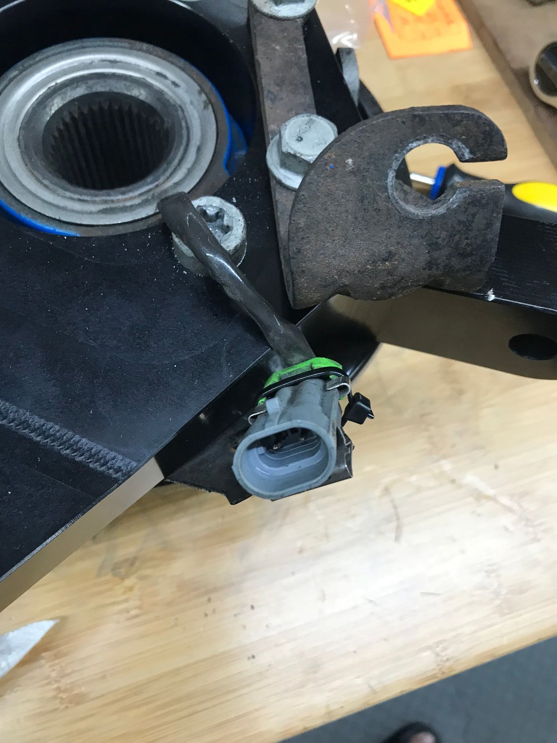

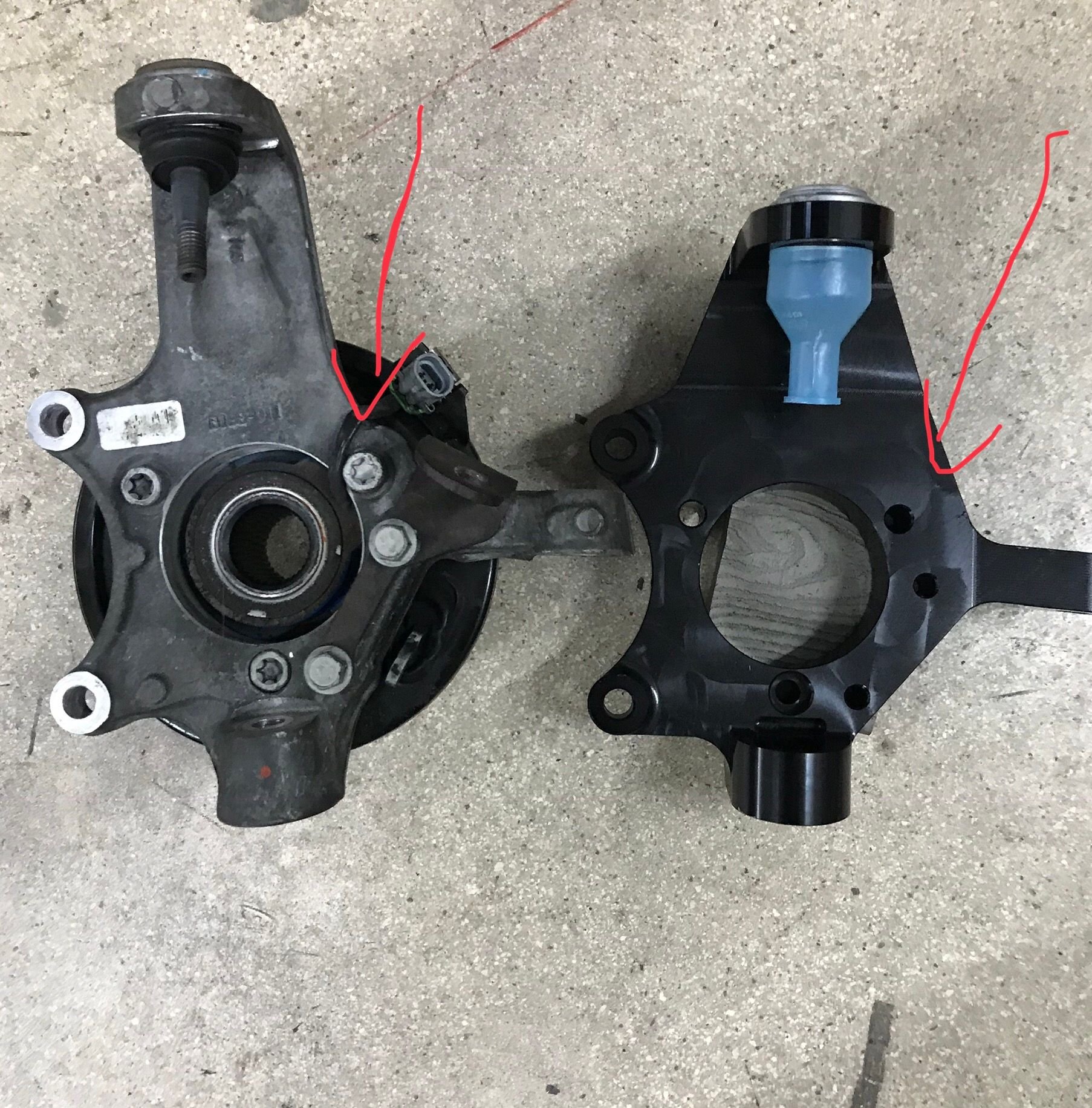

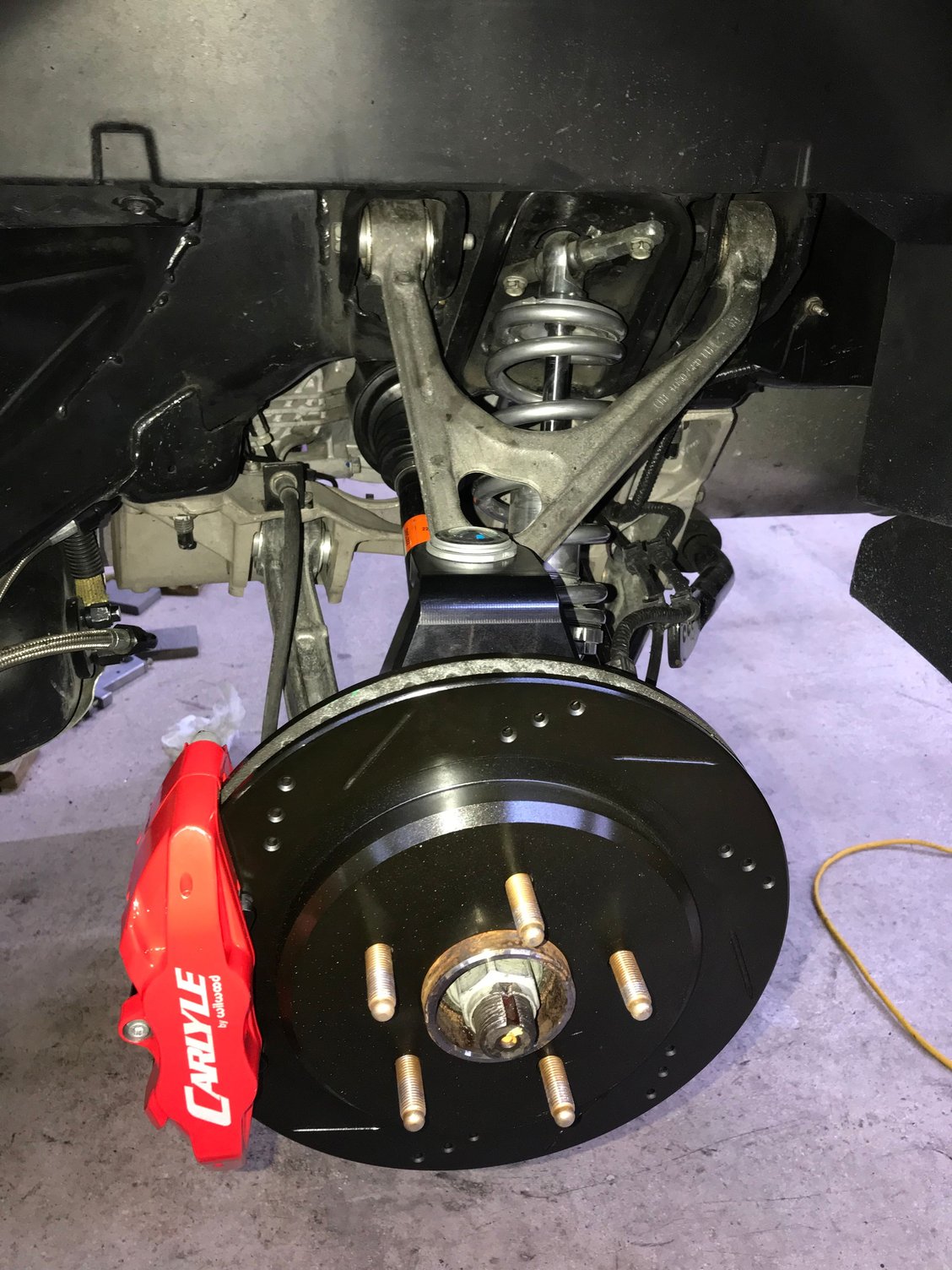

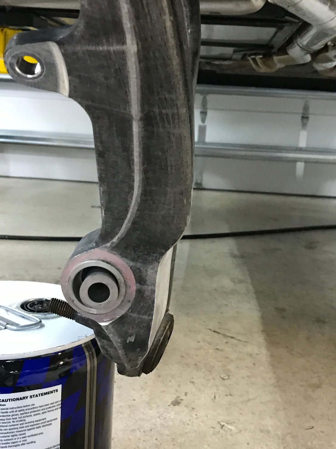

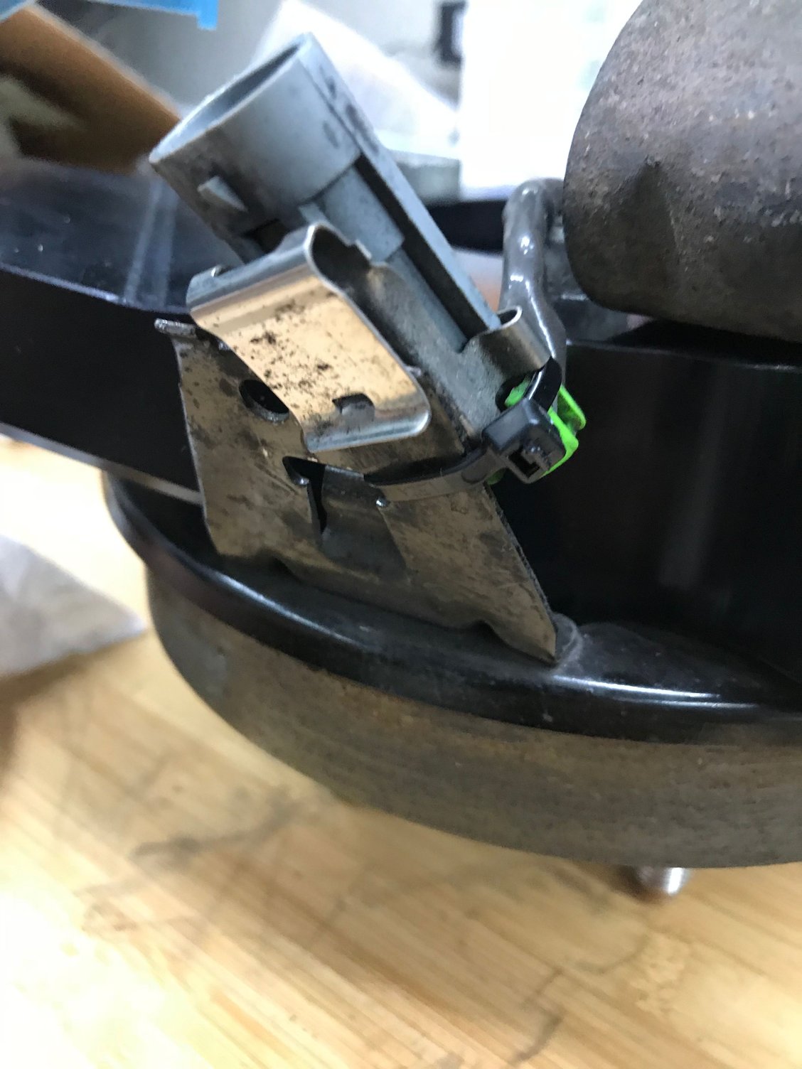

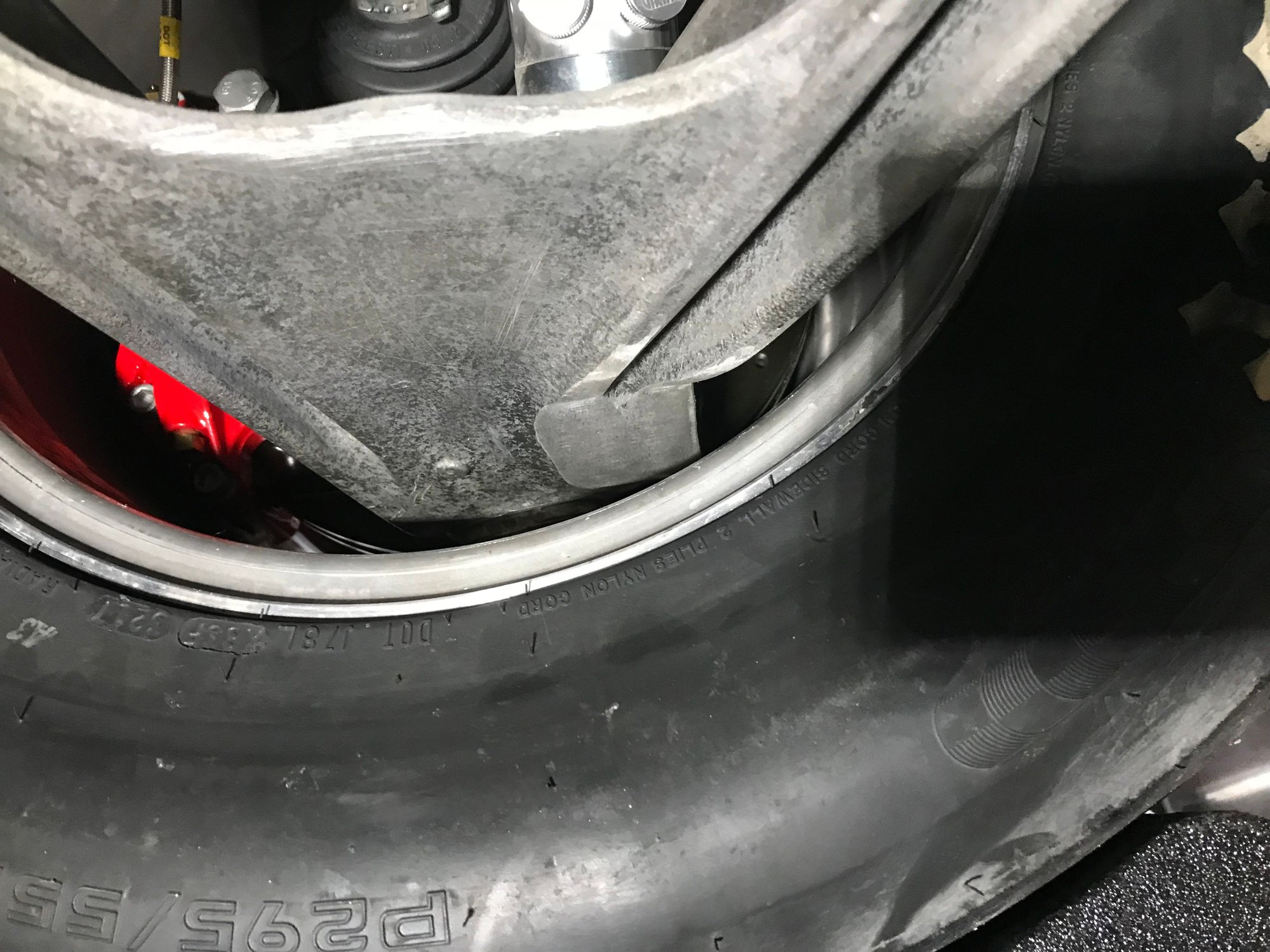

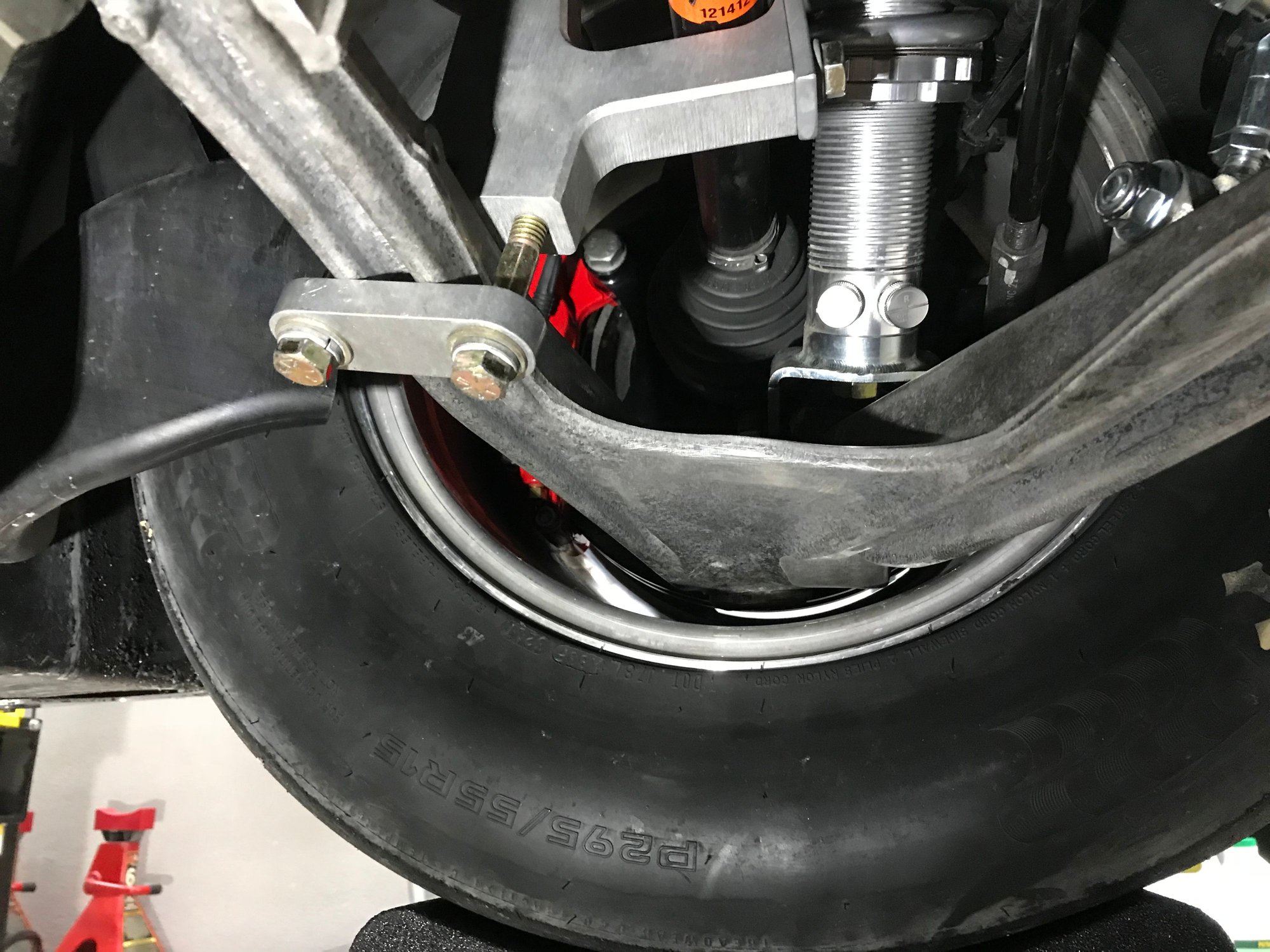

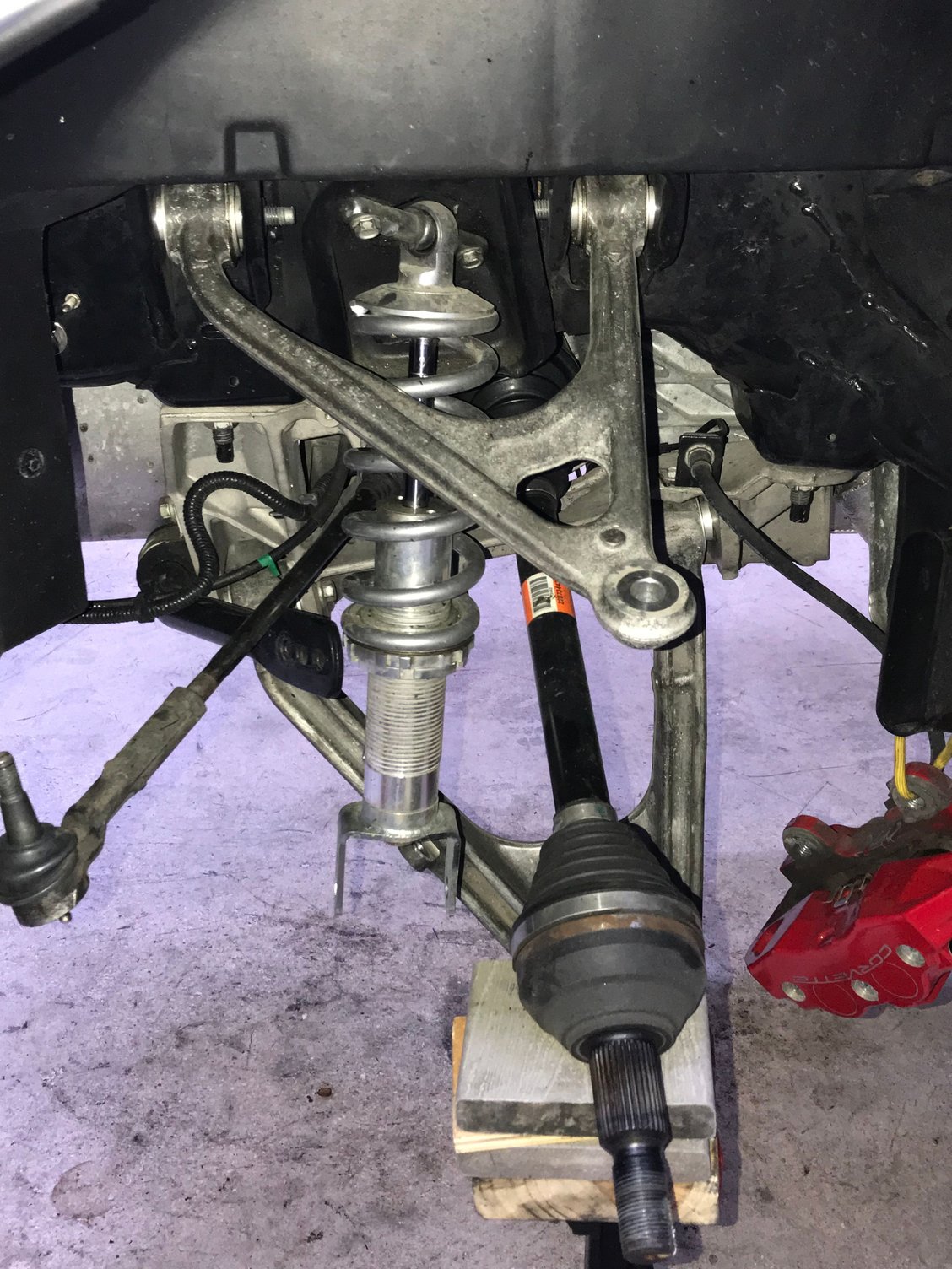

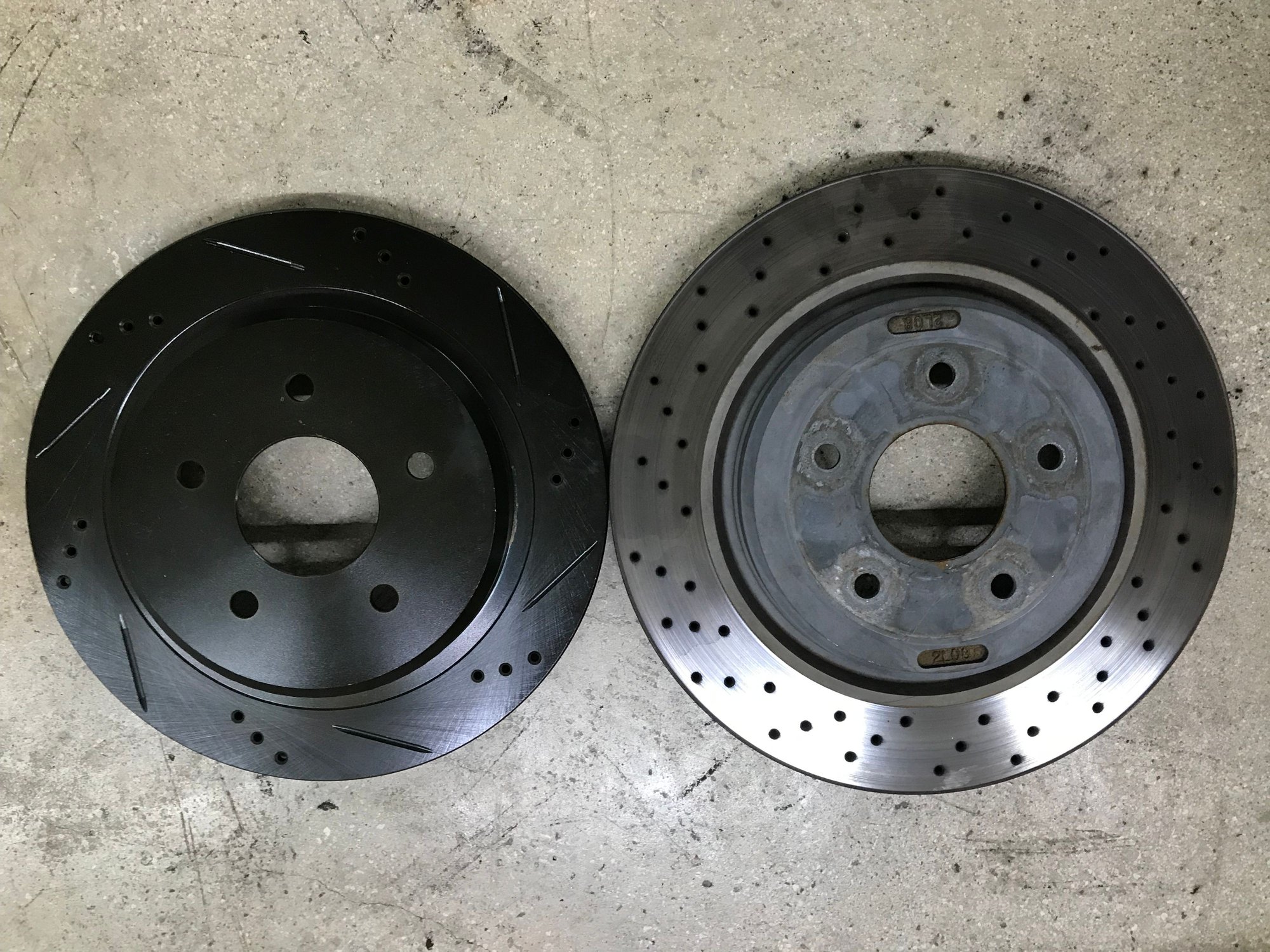

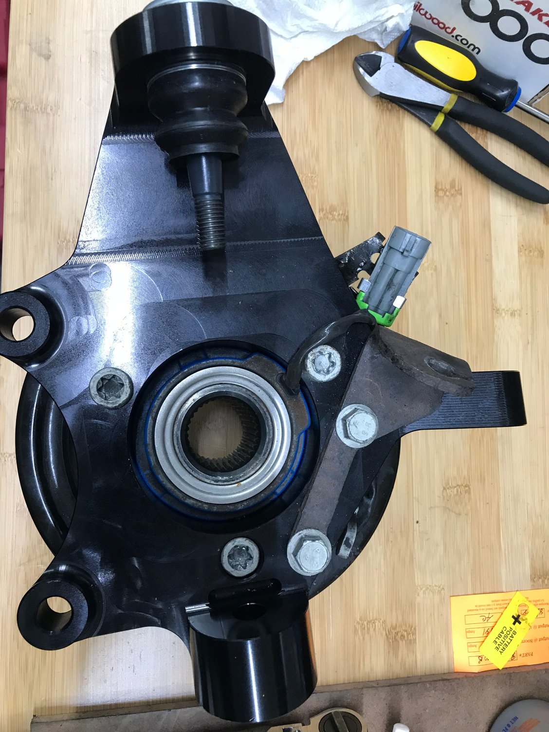

Here’s some pictures from my Carlyle 15” kit install:
