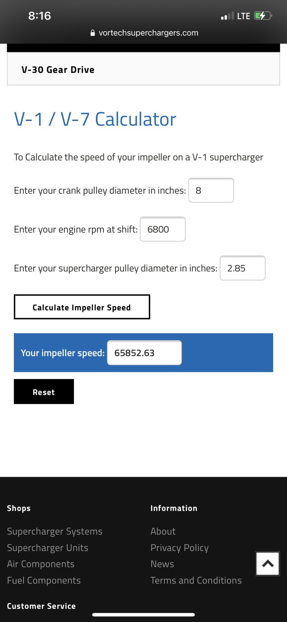

Going to just go for 1000 crank which should be 900whp want to be a little safer on a stock bottom end before I push it to 1000+ I’ll go sleeved 427. I do want to rev it to 7000 if that isn’t a issue so I’m wonder if I should go 2.85 pulley or 3.0 I’m going to keep comp right at 10.0. I’ll be on flex only time on 91 is to baby it to get to a e85 station for injectors for sub 900whp I’m thinking 1300cc? I’m doing a walbro 450 in tank with a dsx aux that I have here.

I think revving to 7k and having a big cam with ported heads on e85 should get me near there so I think I’ll run a 3.0

so 66k is max propeller speed even though I was told it can go over 70k but just want to retain the life of the blower now. But reliability wise is 200rpm for motor speed make a difference I heard the ls9 pumps don’t like to be over spun

Spin mine over 77k.....
