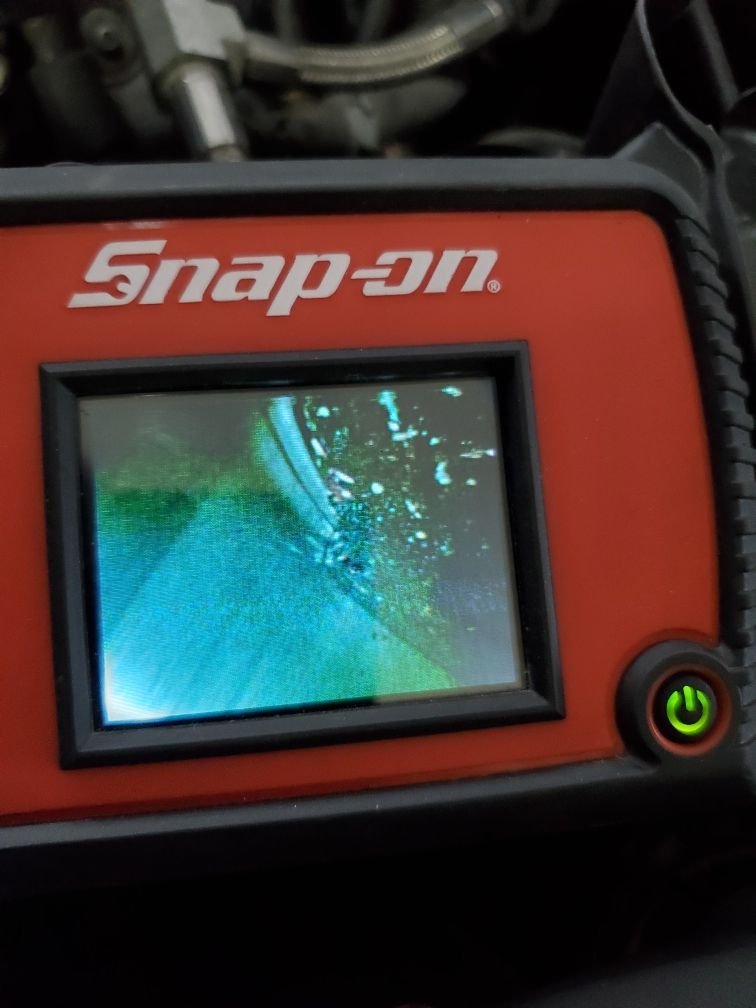

So, I broke a piston...
This is cylinder #7.
I'm not sure exactly why it broke. Bad gas maybe? I heard detonation when it happened, but my data log doesn't show any knock.
I'll add the log later when I'm on the laptop.
Best octane we can get around here is 91, and I've been adding a bottle of octane boost with every fill-up.
I'm at about 8lbs of boost on a T-Trim.
LS3, stock bottom end, BTR Supercharger cam, ARP head studs, dual springs, Johnson lifters, etc...
Was this a fluke (bad gas)? If so, should I just slap another stock piston in it and go?
Would forged pistons hold-up any better in the event of bad gas?
Is it worth the extra $ to put a set of forged pistons in there?
Any advantage to doing rods too?
I'd love to turn it up a little bit more, but since 91 is the best I can get, I don't see how forged components will make any difference.
Meth is probably the only option for more power.
Maybe a dished piston will help (safer)?
Would love to hear some thoughts...
Gotta get the head pulled-off soon to see how bad it is in there.

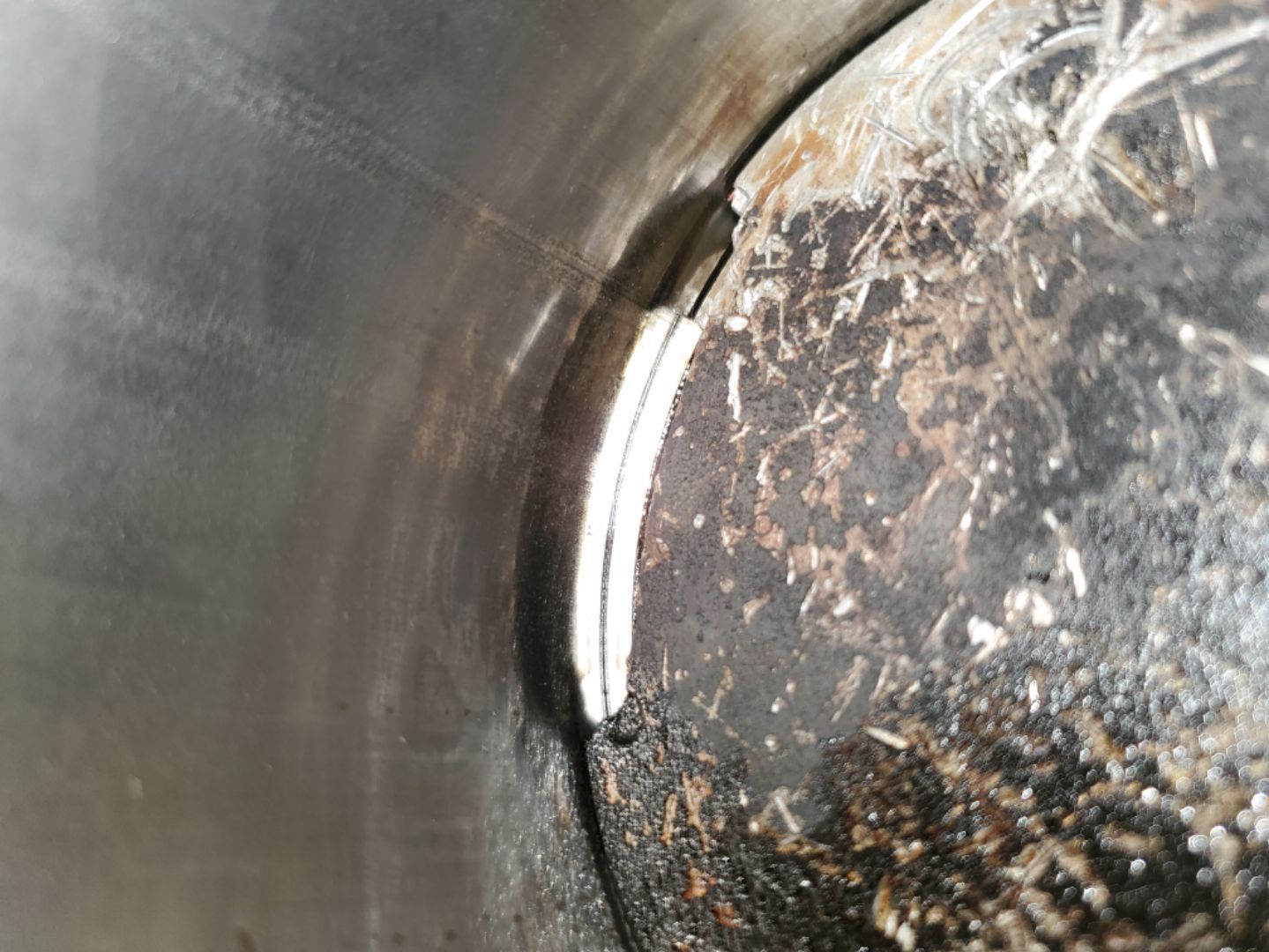

A couple of engine guys told me not to bother opening-up the ring gap, because the LS3s don't have issues like the earlier LS motors, so I didn't.
I wonder if that would've helped at all in this situation.
It kinda looks like the ring bound-up and chipped the top of the piston.
What's everyone's experience with ring gap on the LS3s?

Well does guys are idiots. Most top ring damages comes from the rings pushing in to each other. Is there other things that can contribute to a broken piston yes but that percentage is extremely low. All ls engine are about gapped the same from factory.. So i don't know why he's tragating ls3 engines or maybe i don't know something.
Good ring gap to start at is around .025 ish. And factory is no where around that. JMO

So maybe just slap another factory piston in there and set all the ring gaps a little bigger?
You guys think bigger ring gap would have saved this one if it detonated for a few seconds from bad gas?
Forged pistons are tempting because it's SO much work to get the upper oil pan off anyway...
BUT I feel like the rotating assembly should probably be balanced if I'm putting forged pistons in there... and I really don't want to take the engine (or transmission) out.

Agree, that damage is typical of piston ring expansion until there is no more gap. There is a minimum and maximum gap tolerance and your LS3 is likely on the lower side of that (maybe just that cylinder). LS3 is normally fine running that level of boost so like I said I just think you were unlucky. It would be interesting to see what that cylinder's gap is assuming the ring is not distorted.
Forged pistons are never a bad idea if you are willing to spend the money for them. But still mainly important to get the piston ring gaps correct.
Might not be a bad idea to pull each stock piston out, measure the ring gaps and open them up a bit for some insurance. If the engine is already apart...

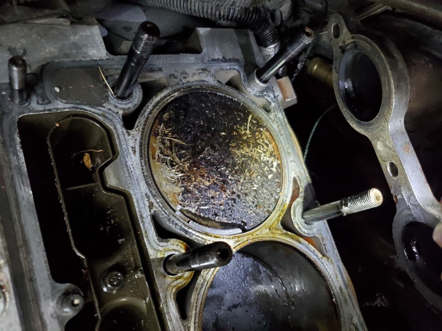

Got the cylinder head off... Looks about like I expected.
I think I'm just going to change the #7 piston this time around.
I'll plan on gapping the rings a little extra.
Also, I've heard of guys running a colder plug in #7 since it gets hotter than the others. Will that help at all to keep it safe?

Highly advised to pull that engine and disassemble. You don't know the true damage. For instance, how do you know the chunks of that piston didn't make it's way to and through the bearings on the bottom end? Could be living on borrowed time. I feel your pain dude, trust me. I did that to two pistons at the same time. The bores needed a few thou to clean up, yours looks no different. Bad news man...but just putting a new slug and rings in there is making a large gamble. Just my opinion. YMMV.
