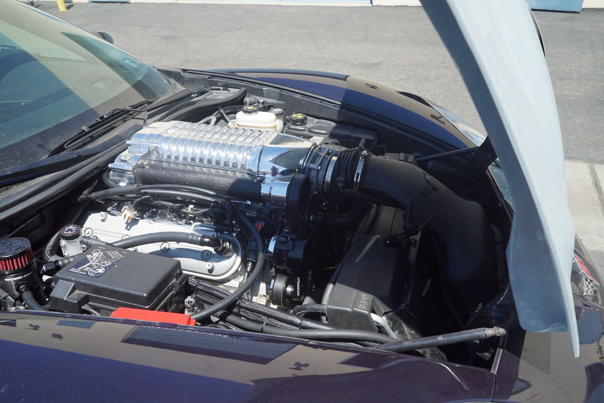

My cars finally being finished up at but we have a hickup at American Heritage Performance
Lets solve this one together!!!!!!!!
Looks pretty good! Engine Dyno'd good without the whipple,
but there is a minor issue getting the whipple tune running.
I am looking for people who have dealt with Whipples, or I guess other Superchargers to trouble shoot this.
Remember, I live in California
I think it was supposed to come with a handheld Superchips handheld with a calibration when I bought it in 2020. Apparently, now it comes with an RTD where you send them the base tune to be modded and sent back. Matching a template, as I think they are changing their ways of doing things. But I don't do this for a living. Or know their process, or changing process.
According to whipple and thier logs, they state that the tune they provided should work fine, and the issue appears based on the tune logs that it appears to be something before the throttle body.
Implying bad Maf sensor or not enough air coming in. However it was designed to work with the stock intake. They said it could even be vacuum leak or something stupid throwing everything off. Which makes sense. And we all have seen a million times on newer cars with the finicky computers, when something is a little off, like a vacuum leak.
American Heritage thinks it's a bad tune itself. And that the problem is not with the engine, but the tune. With the whipple tune on the car, it will run, but stalls out at idle. They have said they've gone through things and can't find an engine issue. Vaccum, or anything else. And they have checked the fuel pressure for proper pressure and it is good,
After speaking with Whipple and the Tuning, they state the logs seem to be pointing towards the intake side. However there isn't much complexity to the intake. It is a factory sized plastic box with a maf sensor and that is it. Obviously the Maf sensor working within the range of the factory volume in which has not changed and of course a small varying degree that the computer can deal with. And I'm assuming since this kit is 50 states legal, that it was designed to work on a Factory volume.
This suggesting that really before the throttlebody the only possible thing could be a bad MAF sensor, While I don't have any scanned log data for you at the moment, I need some serious people who have dealt with this issue. For some opinions on what they think might be going on.
While I've read the whipple tune is crap. It might be, but it should be good enough to run the car safely and without stalling out. So why is it stalling out, and what is the issue? Could use some help on this from some experienced people because no one seems to know what it is!

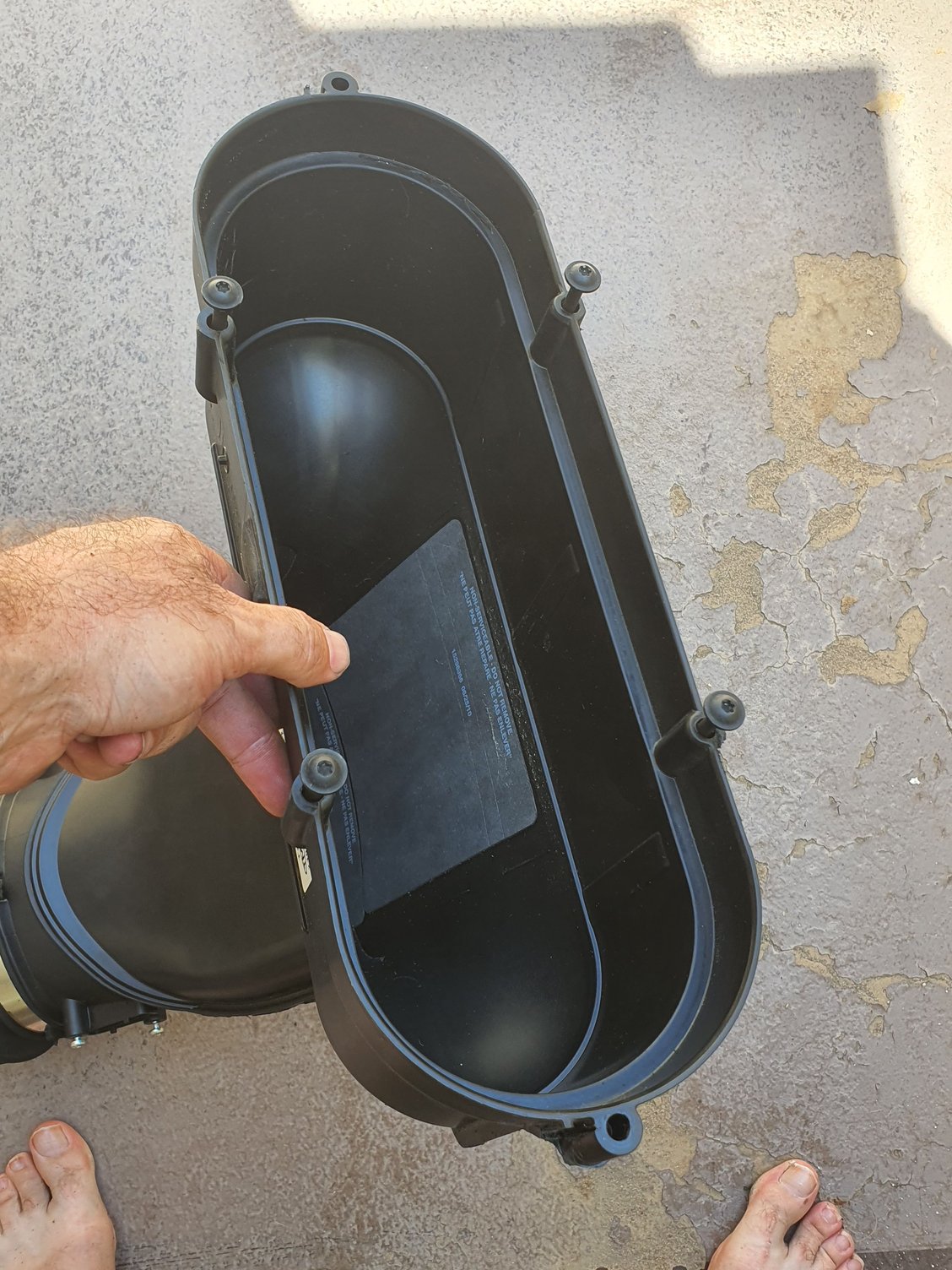

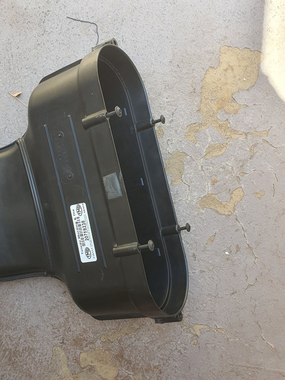

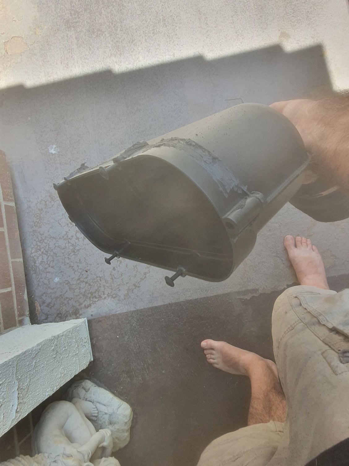

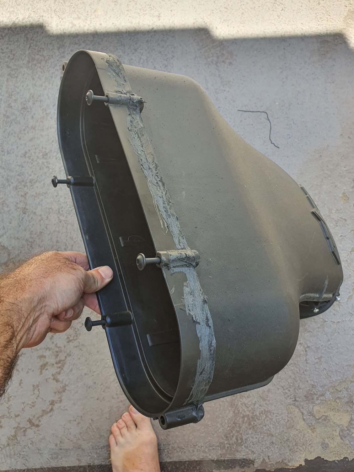

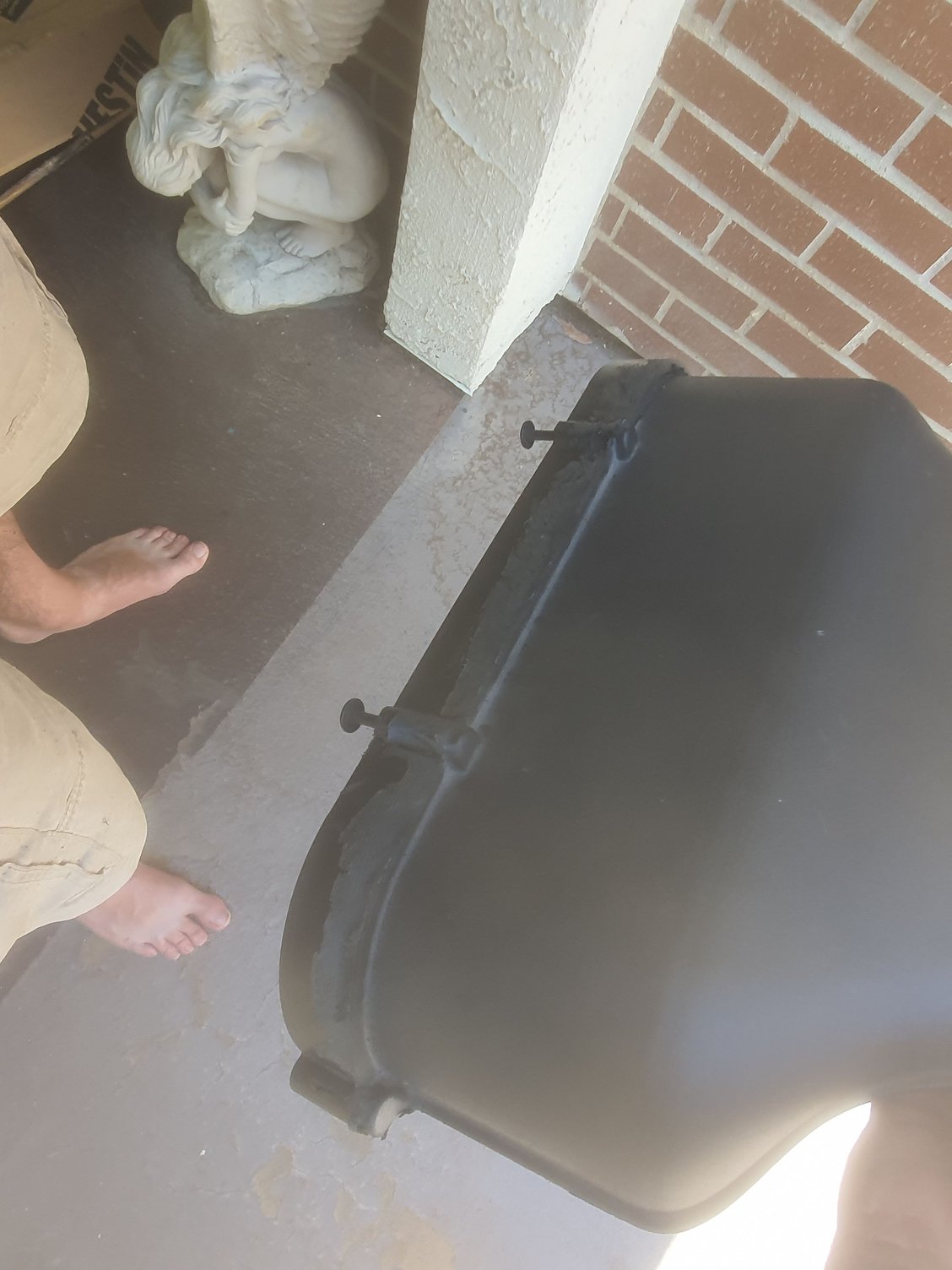

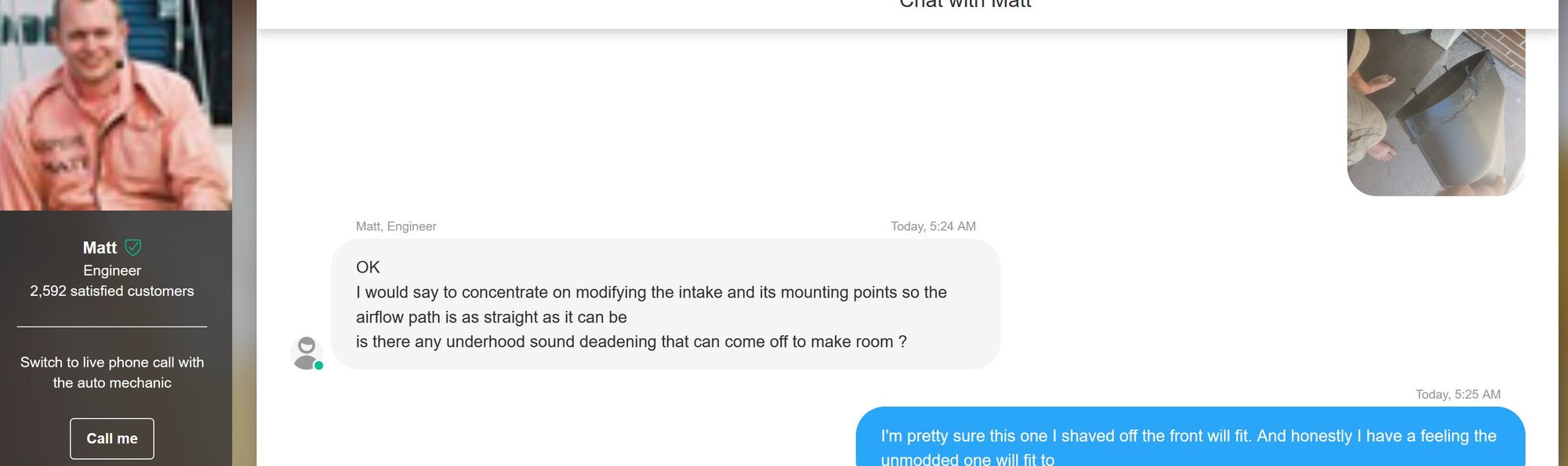

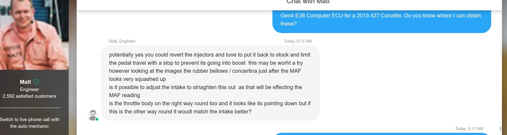

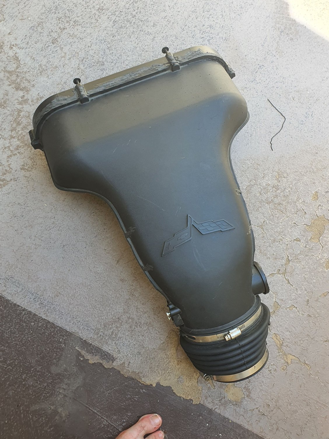

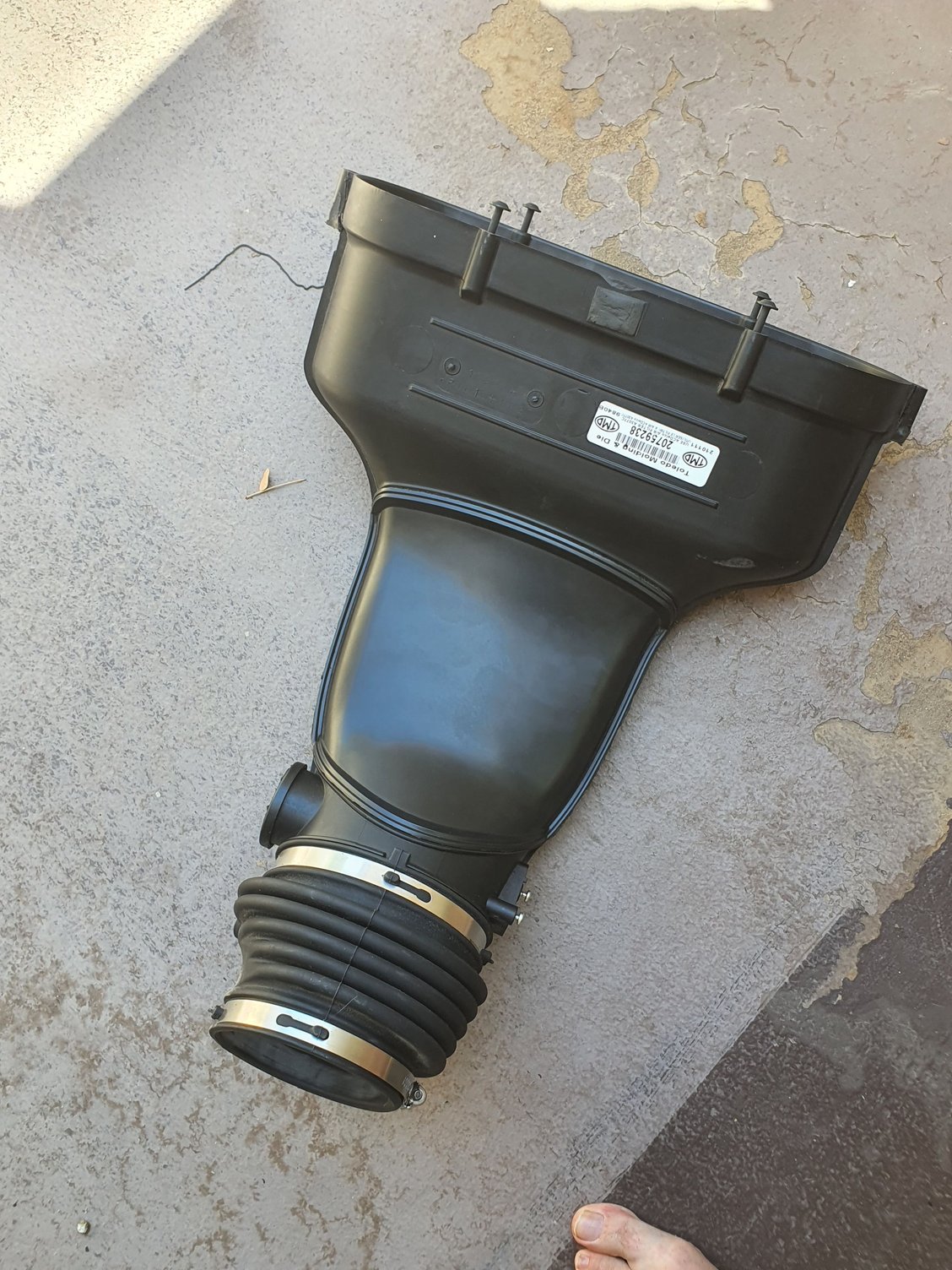

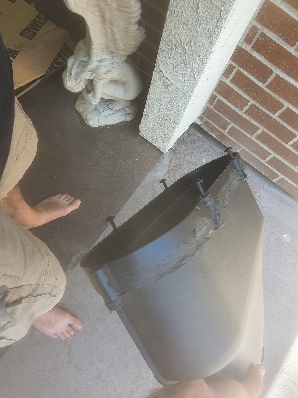

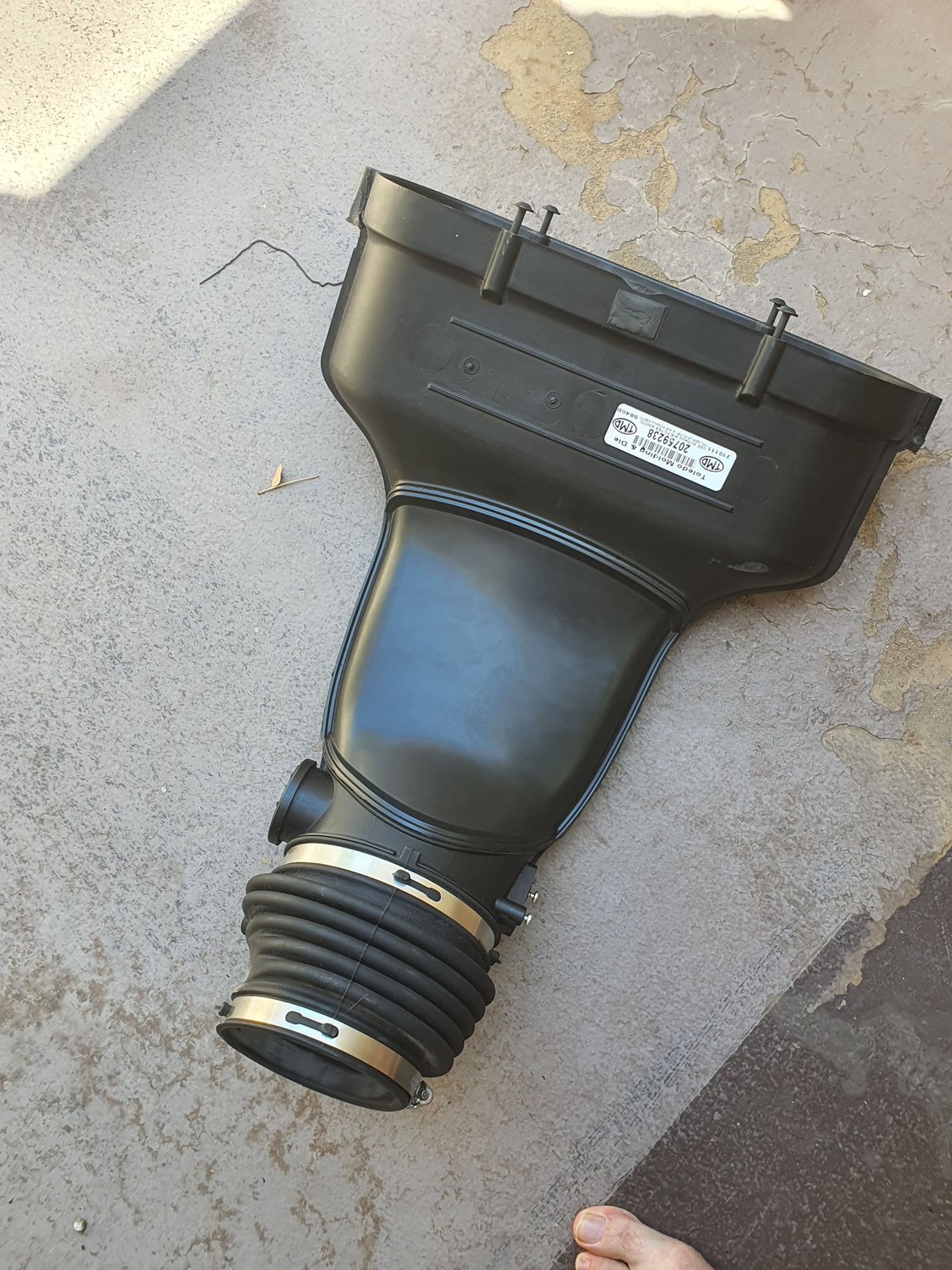

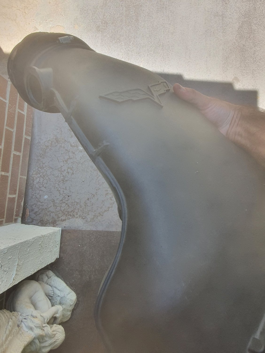

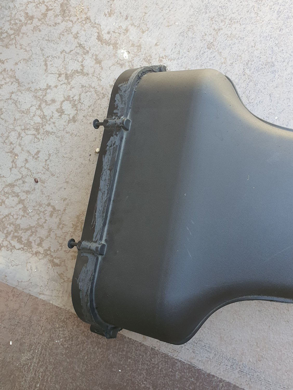

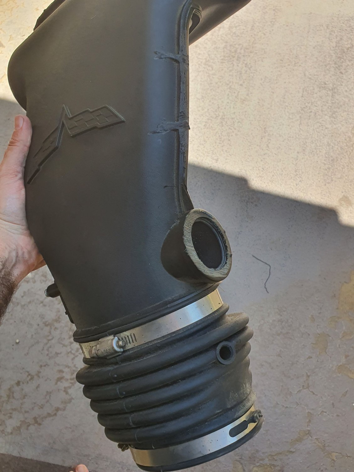

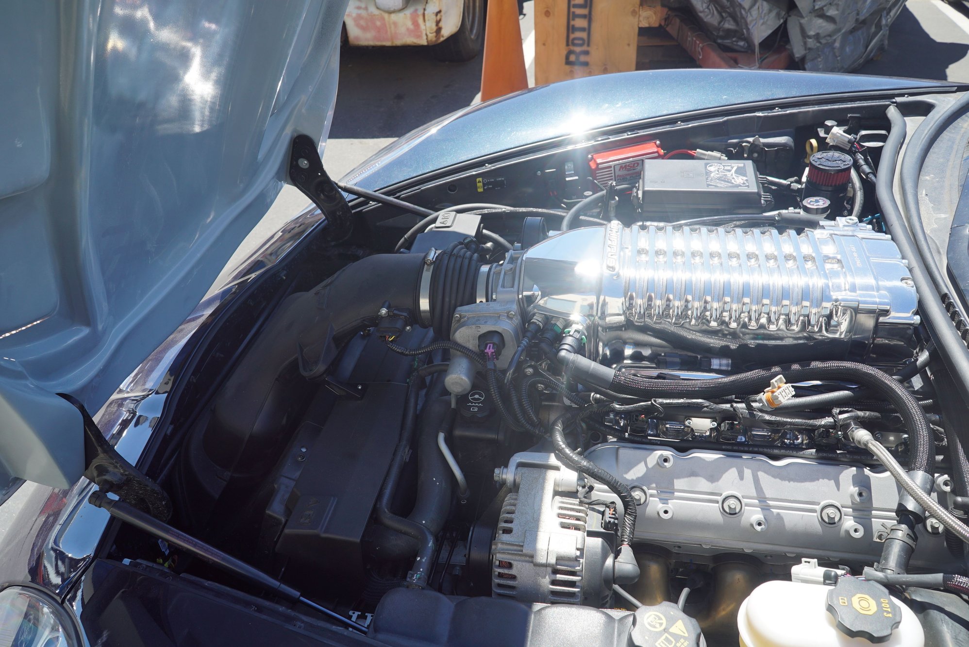

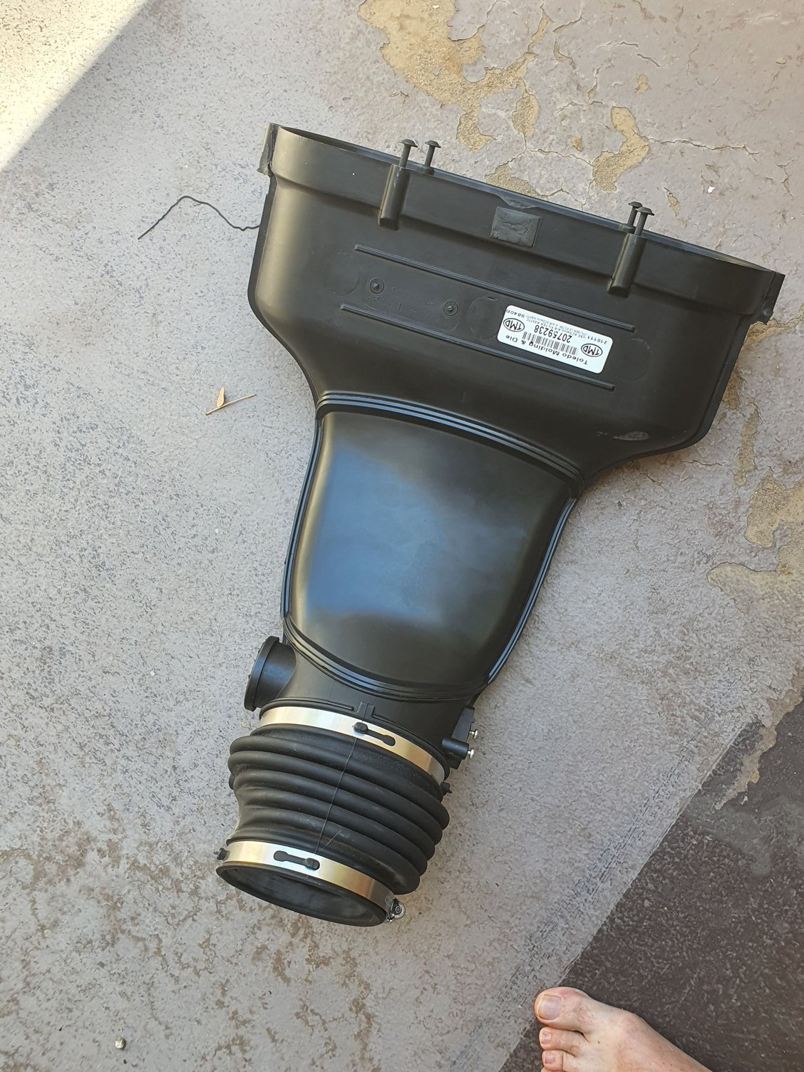

Ok, so another mechanic just pointed out something that most likely is the problem. Which was they could not get the intake to fit right due to it being too big. But I guess their focus was a little backwards. Which is the angle of the throttle body mouth to the intake mouth. And the fact that the velocity is creating turbulance because they aren't KISSING correctly and evently creating turbulance, and air restriction. In essence, changing the VOLUME, of the MAF sensor.
Angle, angle, always a Star Auto Haus, GABBY ANGLE! with Dr Ronald Berry Perelman! :P~~~~~
So stop throwing wrenches at me, and loostening lug nuts on cars while asking me to drive chuck norries's mercedes home to him while trying to kill me! After hiring me!
As I have been reading about turbulance and why they use speed density tuning with IAT sendoes instead on forced induction engines. However it wasn't connecting in my brain due to lack of experience.
I mean these 1968 350, and 454 chevy's are a lil diff! without dem computers! in 1988
In order to run, you must first learn to walk. Not told your not allowed to WALK, but you had better RUN! (With Jason Perelman and Psychotic Friends)
After he pointed it out. it makes perfect sense why the car would stall on idle and be fine at highter rpm with the whipple tune. I also don't know why when I sent whipple the picture they said it was fine. Being that they have installed like 10K of these things on cars.
Now look at that angle. As I am told the intakes are tempermental on these things with the MAF sensors, especially with forced induction. What is everyones opinion on weather or not this would make the engine stall now and then on idle with the whipple tune?

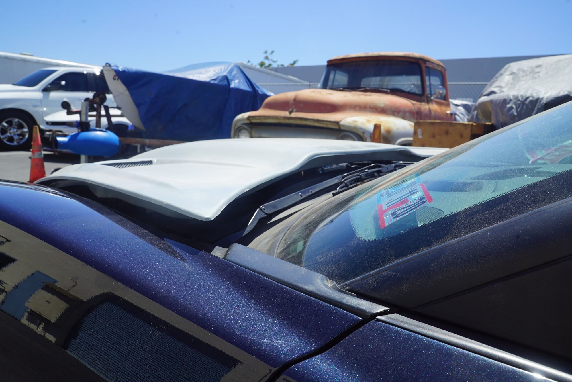

The other issue is the damn hood doesn't close like this!

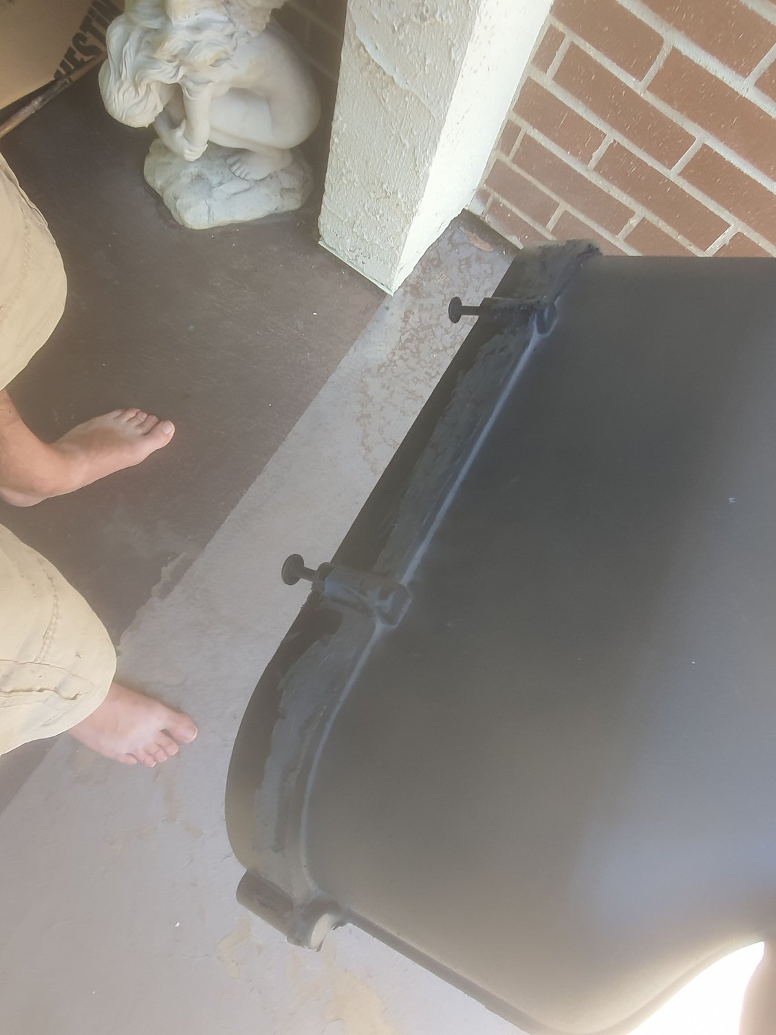

I did go out and buy a used intake for $25 and shave off the outside front parts for them to use. However they wanted to deal with that later. Which I believe would have solved the problem. So putting on an intake that is level, the hood closes, and the mouth's line up seems to make sense as a priority. But they want to get it dialed in first. I am guessing thus solving the issue.
Do you like my feet?
I still need to get the scan data logs but whipple told me the logs suggested that the issue was with the intake as well. So Corvette people who have dealt with MAF sensors, intakes, forced inductions, and tunes.
OPINIONS PLEASE! Do you think this is the issue? Do you have similar intake stories with your cars?
Eleanors life is at stake!!!!!!!!!!!
So lets all get together and solve this!
And join the SAVE A VETTE foundation
While Checksums still might be of discussion due to the whipple tune process. I am guessing this is the PRIMARY stalling out issue at idle.

Vertigo262: we tried everything to get the intake to sit correctly and for whatever reason it does not. We even removed the large stands Whipple sent with the kit to hold the intake up but it made no difference. The air intake still sat way high like in the pic. The kit is installed as per Whipple instructions. The intake hits the shroud which causes it to sit high. The shroud can be moved or cut due to the parts of the Whipple kit located under it. We also asked Whipple about this in our may emails with them and they said its fine although we thought it personal looked weird and is not what we have seen with other Whipple kits we have installed or worked on in the past. Thing is there is not much we can do to correct it due to the Whipple kit.
We also thought that might be an issue with why the Whipple tune falls on its face but our tuner being able to get the car to run and drive as it should disproved that theory. It may not be ideal but its not the reason the Whipple tune falls on its face.
With the Whipple tune you slightly rev the car it wants to stall. Then if you move the car forward or backward even 1mph it and rev it just like you did when it was sitting still it completely falls on its face with not even the slightest attempt to catch itself. Our tuner had no problem getting the car to ide, run and drive correctly with his tune. The issue is the Whipple tune for whatever reason

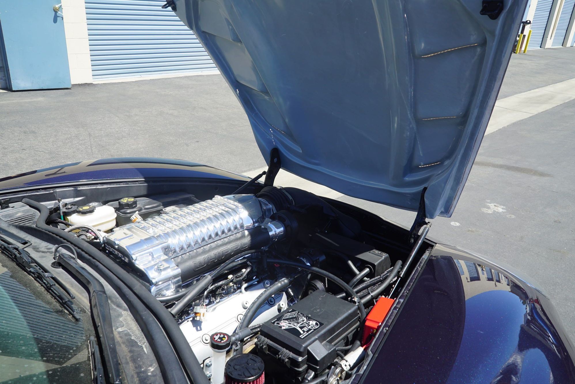

This may be meaningless to this conversation, but since you had mentioned that your flexible intake tube going to the throttle body was not straight ... here is a photo of my flexible intake tube on my Magnuson 'Heartbeat' supercharger.
This flexible intake tube is not straight at all, but has no impact on the idle quality, part throttle drivability or wide open throttle performance of my GS.
Even though my LS3 has an aftermarket cam, it still idles very smooth at 775 RPM ... Idle and steady state cruise rpm maintain a constant 14.9:1 AFR (and that is with 72 Lb/Hr @ 58 PSI injectors), and a good dyno tune.
I am no expert, but I think the tune that Whipple supplied with your supercharger is 100% of your problem.
Yes, your in a bind ... That Whipple supplied tune certainly makes your car California smog legal ... Unfortunately, the tune ain't worth a **** !
And, with a good tune, such as the one that your supercharger installer provided for you, unfortunately won't pass the Democratic People's Republic of Kalifornia (DPRK) new smog inspection criteria.

Originally Posted by Turbo6TA
This may be meaningless to this conversation, but since you had mentioned that your intake tube going to the throttle body was not straight ... here is a photo of my flexible intake tube on my Magnuson 'Heartbeat' supercharger.
Wrong car, wrong intake, wrong MAF tune. And more importantly, look at the graduale velocity curve.
mine is more like
See how this could restrict velocity significantly! And the ZR1 is a nice smooth turn. The Turbulance effect I read about Speed Density tuning solves the issue of that turbulance. However on my setup would be more of a bandaid
So in engineering. You do things correctly, then move on to better it. Not bandaid it to fix it
Look at how the air shoots up, then bounces down probably hitting the bottom and proably bouncing EVERYWHERE before going into the throttle body right at the MAF sensor.
The sensor itself I would guess is flipping out. As on the Haltech the sensor is in the front away from that area as it is even mouthed as well
Now the issue of the intake on it now, is that it doesn't fit. However me shaving off an .5 - 1 inches on the front and retaining the identical volume Should. And get the mouths even. I don't see why that should not be put on if it's going to take that one factor out of the equation. Even if that doesn't solve it. At least you know, that possibility is gone.
I wish I could put this in an air tunnel. I suppose I could do a quick 3D model with Physics simulation of Airflow and see what happens and I'd bet the air would be bouncing every which way right at the Maf. But I have more important things to focus on
Also, if whipples tune simply does not work on that car. Then whipple will need to fix that. Because maybe they got away with no one using their tune in the past. But that has all changed out here! And then their tune would need to work!
It is EO approved, so what's the issue. and since California is RATCHETING down on us to thie EXTREME and making us, and EVERYONE all CRAY CRAY. Everyone needs to figure out how to SPEAK OUT, and do something about THAT!
Because what they are doing at this point is BEYOND obnxious! and in the end they are saying in the grey, "You had better get rid of your cars, and buy ELECTRIC"

Ok, I just got off the Horn with Whipple and as far as the Intake it came down to this.
All the corvettes he has seen them on, the intake does fit that way. Due to the fact of it's size, and wasn't made for a whipple
HOWEVER. that is due to the factory size of the intake, and IDEALY, when you pop on an aftermarket like a Haltech, K&N they fit correctly mouth to mouth.
He could not address if that was the stahling out issue as he said he needed more data from the tuners, scan scan data from the stalling issue to pinpoint in SPECIFICS what is going on. If it is related or not.

I would remove those spacers that are elevating the intake and also get a smooth coupler to connect the intake to the throttle body. Let the intake rest where it will rest as the coupler will hold it secure enough. Will likely solve or at least help your hood to close.
As far as the problem with the tune, I agree that the whipple tune is the problem. Canned tunes are very typically extremely far off. I also had to upload the stock tune on my E-Force C6 to Edelbrock and then they supplied a modified tune. The modified tune was so far off that my car was making about 30 hp more with the supercharger instead of the 150 more it was supposed to. A proper dyno tune fixed everything.
I realize you may want to run the Wipple tune so that the car is CARB legal. California is a beautiful state run by some of the most incompetent and evil people. Sorry.
I just want the whipple tune to run, and idle. I think we'd all agree a custom tune on any application is going to be way better

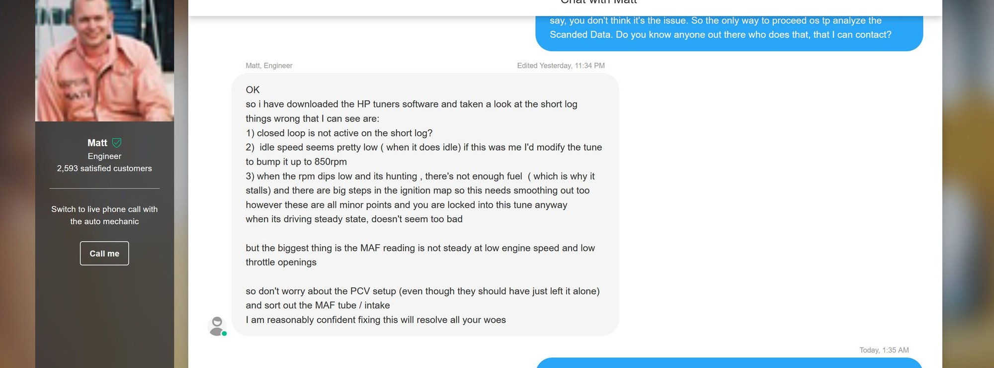

Mechanic after reading the Scanned ECU Data
Also, I should probably upload the Data Logs of the car firing up with the whipple tune and stalling at idle for others to analyze
2nd, 3rd, 4th, 100 million other opinions welcome. Because God knows I have 4 - 7 billions of judgemental delusional opinions and fantasies about me, about my personality from strangers I've never met ranging for 10 yr old to 90 yr olds
