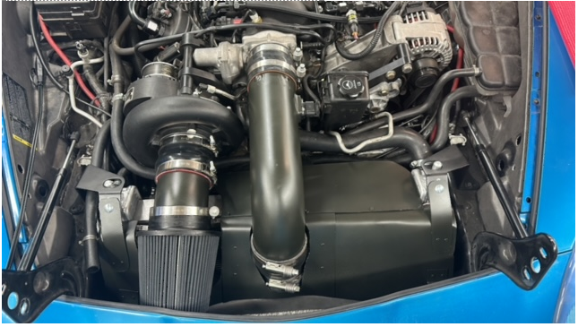

Does anyone know of a shorter condenser for a boost C6?

I don't think anyone makes one. You can always cut the mounts and lower it. What issue are you having?

I had the Radiator tabs on the lower support cut off and moved down about one inch. I also installed a short rad for remove to run a 4" pipe off the blower. The stock Condenser rests on the bar on the rad support. I need it to drop down alittle more.

Ohhhh, i think I know what you're talking about. Take some pics? I did the same thing and it was the plastic air dam that it was hitting. So I just trimmed it to fit. You'll also need to bend the a/c lines

I have the shortened Dewitt radiator in my car and the stock condenser and it sits flush with the short radiator. Also using the stock radiator support, spaced down 1/4-3/8 of an inch (can't remember exactly). I also removed and cut the center plastic air dam piece on the top side as it was not allowing the condenser to move down. Hope this makes sense and helps!
