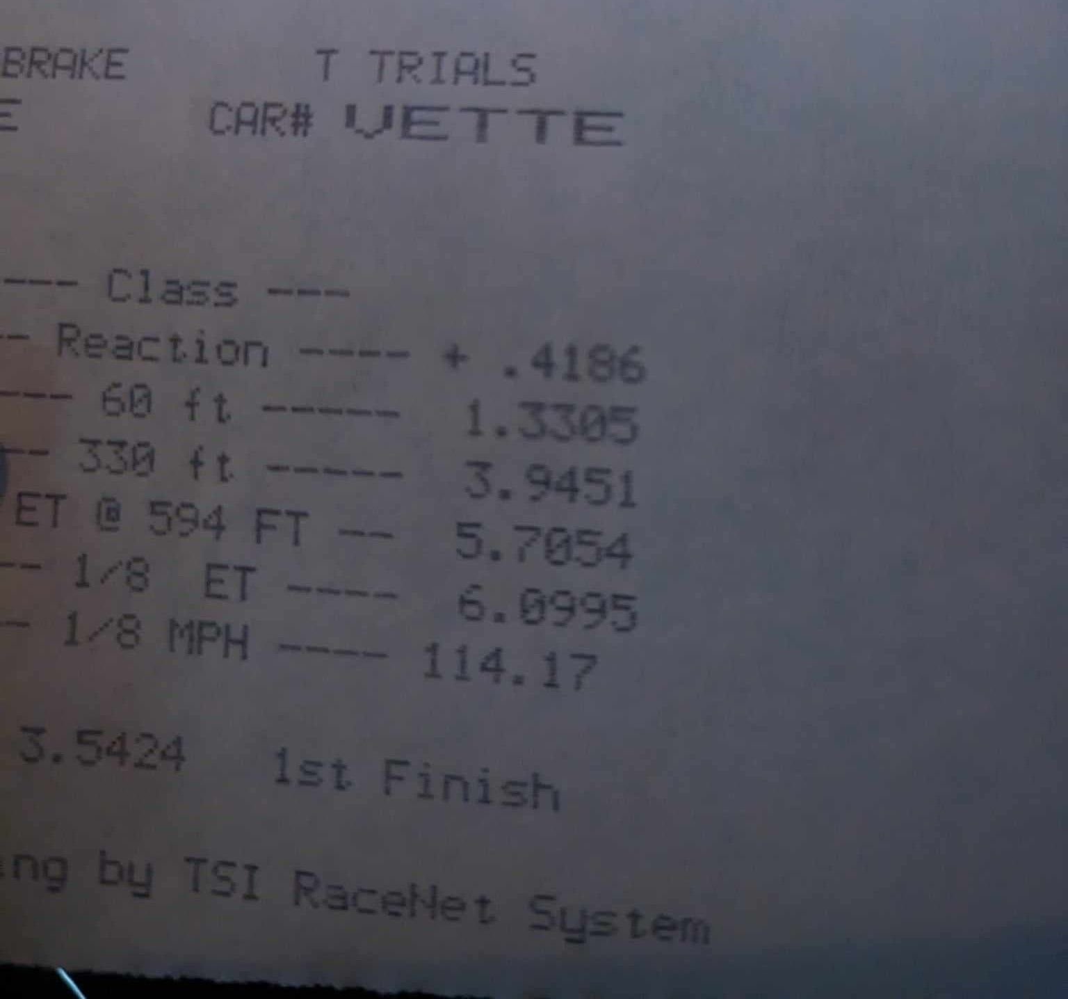

Yea it won't be that difficult. It has very high IAT's right now so tons of timing pulled. We are also keeping the rpm down to limit boost because of the IAT's. Once we get it switched to A2W where i can lean on it some more it will do it. If you look at this slip you will notice my mph is pretty low for the ET because of all this.

Now THAT is getting out!! Bottom 6's in the 8th-you got her humming and 5's no problem like you said once she's sorted.

Well I guess technically a 6.0 in the 8th is low 6's lol but I figured you meant 6.3's or so. lol
Running in the 5's is just a matter of time if you're running 6.0
