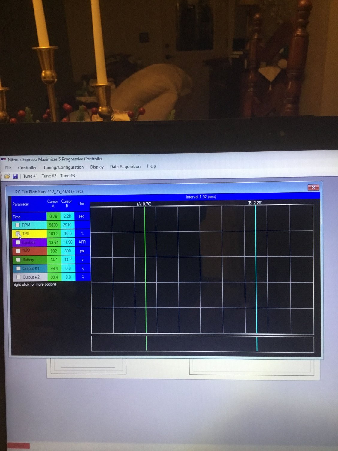

Tune won’t change but you need to drop a heat range on plugs which could possibly change it. I run a Lingenfelter lnc2k box with nitrous outlet plate kit and stand alone fuel cell. 93 in tank and c16 in cell. Have a wideband and read plugs and have fun. Bottle heater is a must. Wrap around heater is better than heated bracket. Fuel psi gauges and nitrous bottle gauges need to be bought.

Having a max 5 helps I’m getting ready to add a 2 bar map sensor and oil pressure sensor.(datalog)
running a wide band is the only way to go when running nitrous
