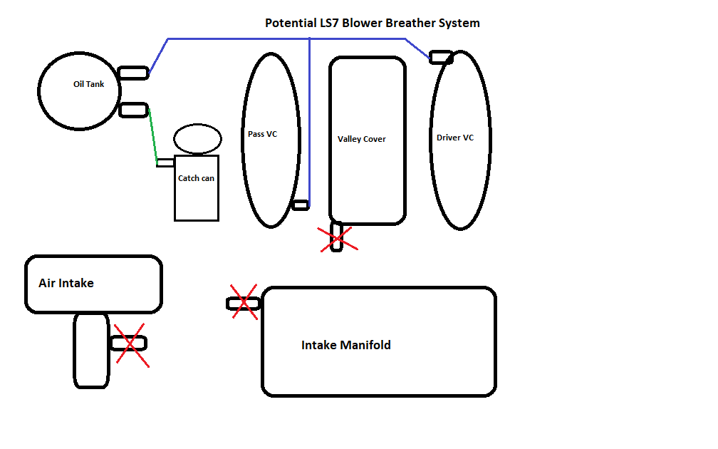

Thinking of doing something like this.

I just realized that this is for an LS7 with the dry sump system. Is there enough suction there to take care of the typical idle/part throttle crank case vacuum?
To be honest, Im not too worried about the lack of vaccum to the crankcase. Id rather have nothing going back into the intake.
