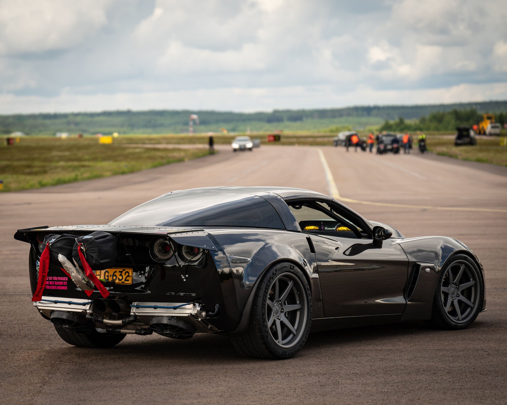

Heres one design for rear radiators.

subtle.
