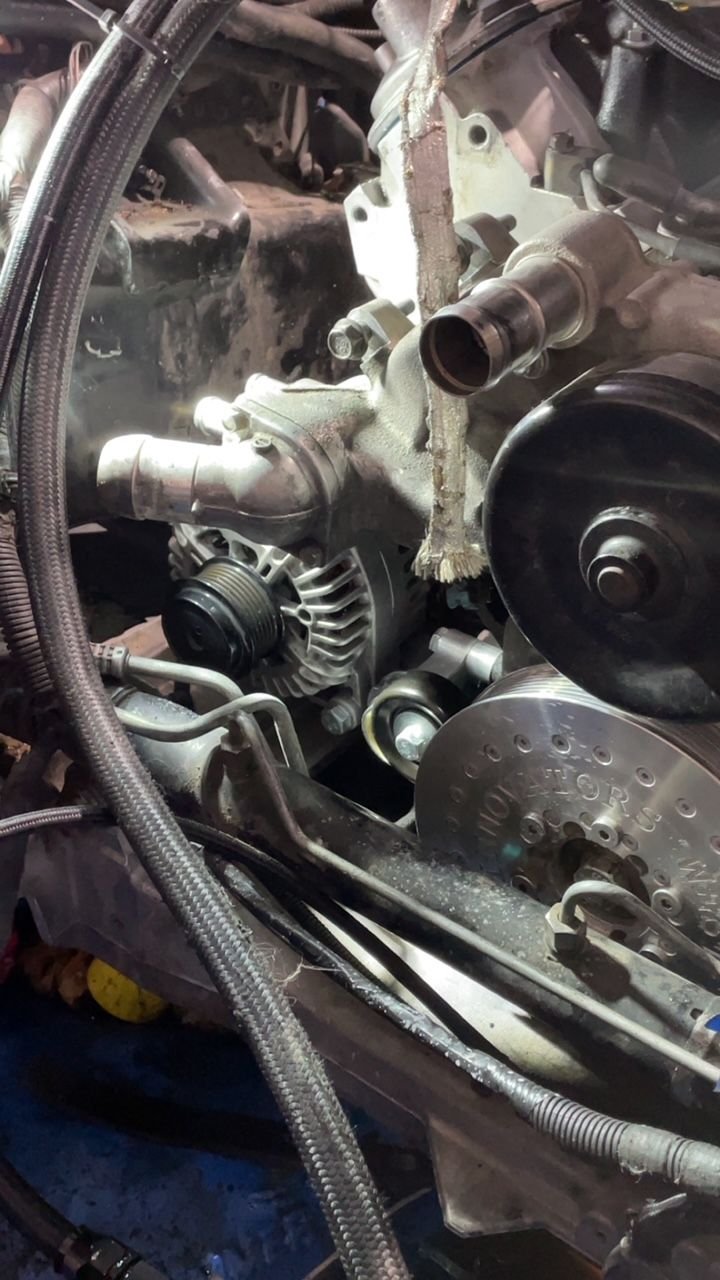

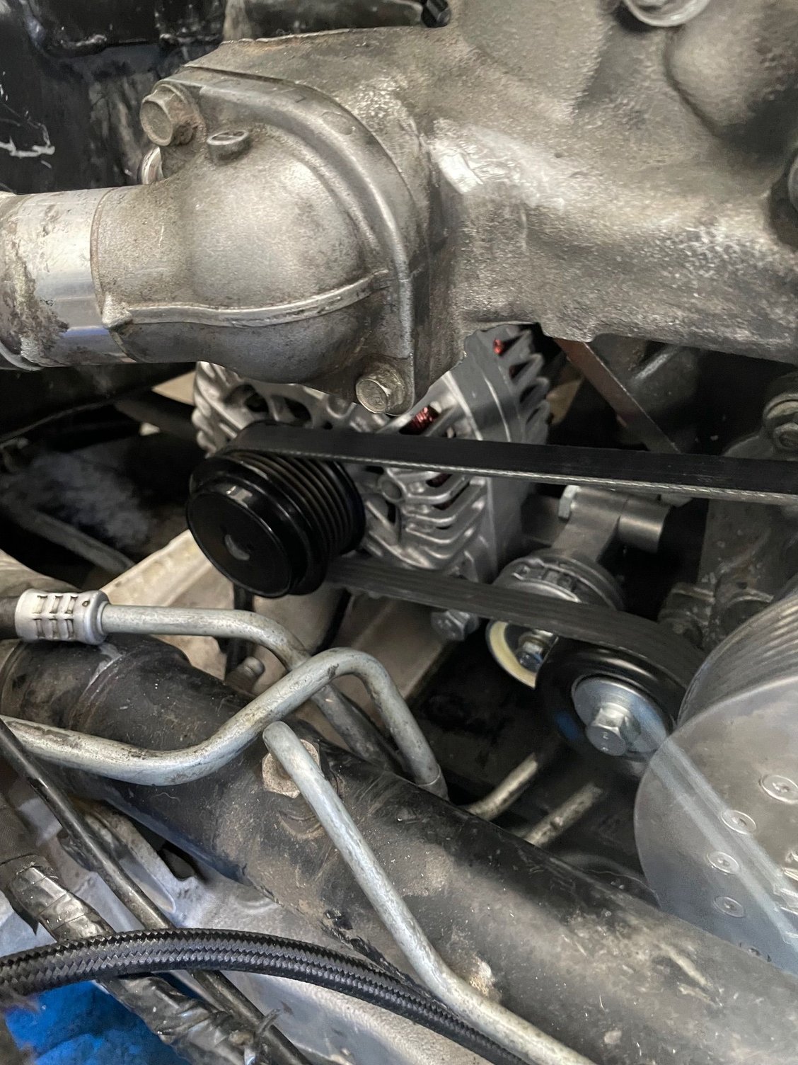

Originally Posted by Irocz2173
Thank you! Do you have any pics of the bracket?
I can take some better pictures once I'm back home, but these are the couple I took when I was doing it. Please don't mind the mess, I need to clean up badly lol. When you call him he'll ask you to measure the pulley size on your alternator and send the correct belt with it.
I ran that bracket in the past. I had to get a tighter belt to stop it from flying off. But I was also turning ~8000rpms. Just something to be aware off. Might need to step down the belt size if you have issues.
