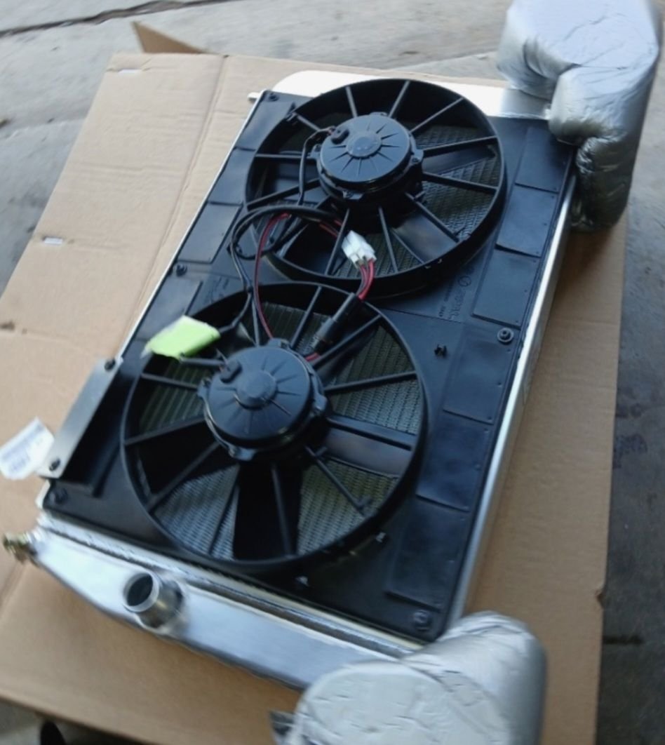

Doesn't DeWitts sell a direct fit dual SPAL fan setup for that radiator? I would call them up and inquire.
My DeWitts radiator came with a direct fit dual SPAL fan setup. It connected to the factory fan controller. They are NOT the brushless fans but they are way better than OEM fan setup. DeWitts also sells a brushless fan setup but they are pricey fans.

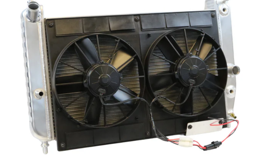

They are definitely not worse than OEM. The dual 11" SPAL fans pull about 40% more air (2,700 cfm) than OEM and the shroud covers the entire radiator. OEM leaves huge gaps everywhere. OEM is also brushed and pulls only 1,600 cfm
The Pro Speed setup uses a similar dual SPAL 11" fans like the DeWitts uses. They might pull more air but I don't see CFM numbers posted

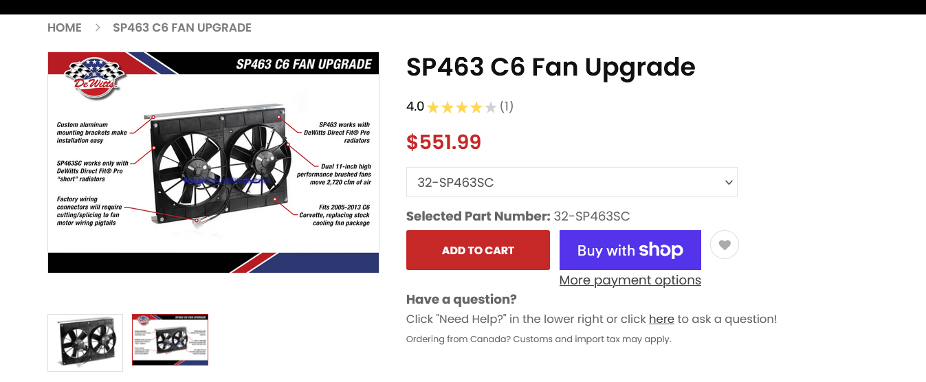

Just got updated.The Pro Speed fans pull around 3,500 cfm and they are NOT brushless dual SPAL fans - $1,000 for the fans
DeWitts are 2,700 cfm and are also NOT brushless dual SPAL fans - $550 for the fans
So the DeWitts and ProSpeed setups are pretty similar. Both utilize 11" dual brushed SPAL fans. The cfm is slightly different but not sure on how they measure cfm on those fans.
The only BRUSHLESS setup on the market now for the C6 is the DeWitts dual 11" SPAL fans that pull 2,800 cfm but that is $1,400 for the setup...
