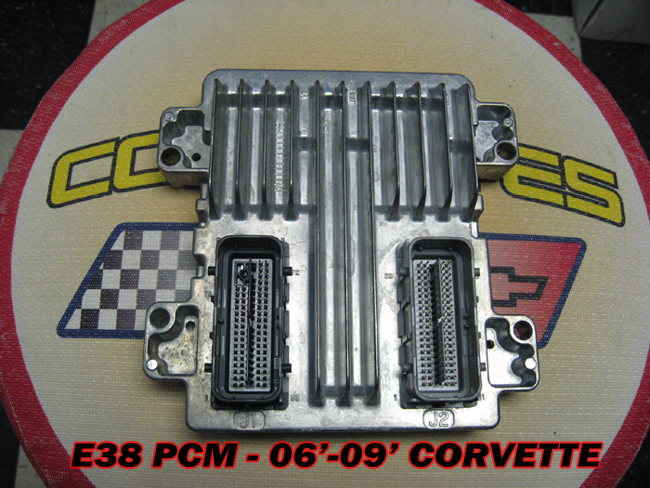

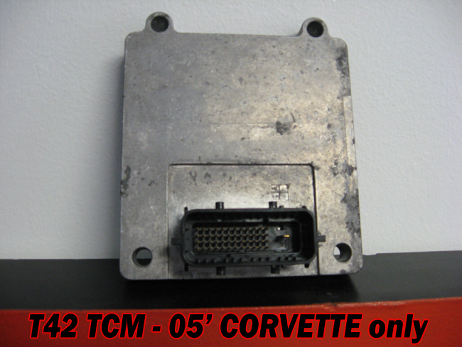

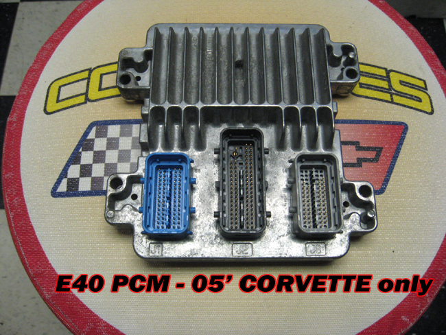

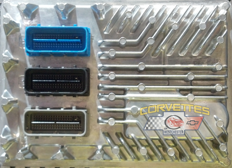

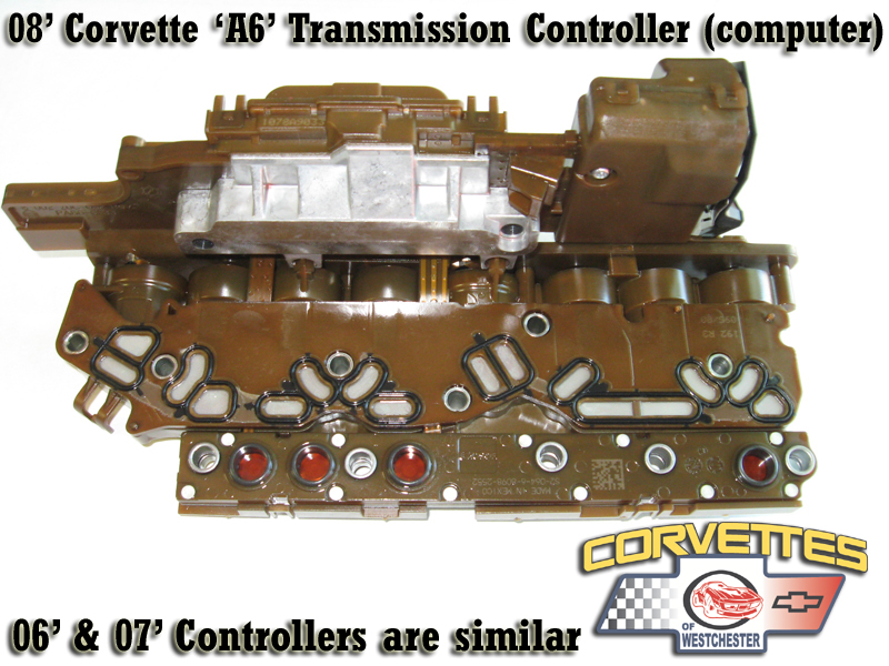

Here's some of the popular computers and their applications.
E92 which powers the new C7 Corvette and the LT1 TRUCKS.
E67 that powers the ZR1, CTS-V, ZL1 CAMARO, and a few others like 07-up TBSS
This is an old pic of the E38 which runs EVERYTHING from 06-13 Corvette, G8, and most Trucks.
This is the E40 step child which is in the 2005 Corvette, 06 TBSS, GTO, and some trucks. PITA.
This little guy is the T42 TRAN CONTROLLER for 05 Corvette, TBSS, GTO, TRUCKS, and some others.
Again, another old picof the T43 trans controller used from 06 -14 in the Corvette, G8, Trucks, CTS-V, and many others using
a 6 speed transmission. This one is INSIDE the trans attached to the valve body.... Please don't take this one out yourself...
90% of the ECMs and TCMs you're gonna come across are these guys.
We always have a good inventory of each of them if you're in need.
Any of these can be bench programmed at CoW should you have a special request.
Stay TUNED!
Chuck CoW
