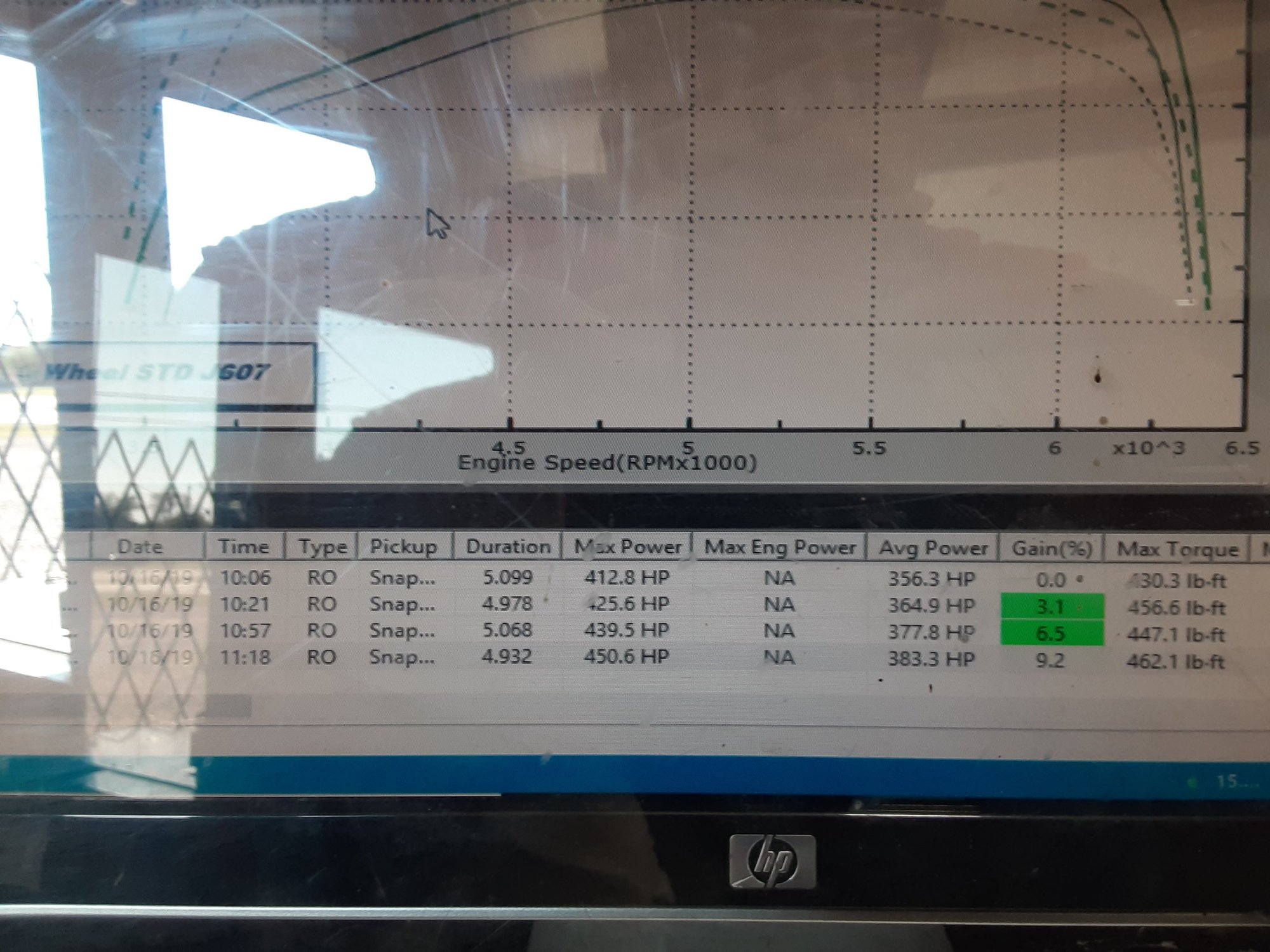

Hi everyone, I just got a dyno tune done today on my ls3 c6. With a halltech intake and tsp long tubes and an off road x pipe I made 450/462. Was wondering what other people made on the same mods

first thing.....welcome!!!! second is your car an M6 or A6 ??? also what kind of dyno and where? seems really high but congrats
its a6. I got it tuned by jp tuning in van Buren Ar. I'm not sure what dyno it is

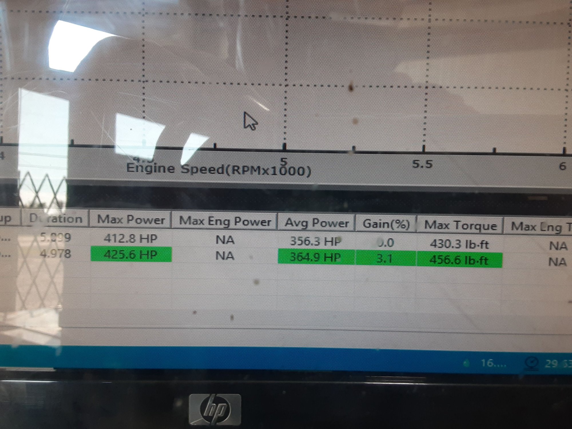

Assuming your baseline numbers were 412 hp and 430 tq, that is a nice gain of 38 hp and 32 tq which would be right in line with intake, headers, and tune.
That dyno is reading high though.
Typical LS3 C6 make about 380 to 390 wheel hp for a manual car and a little lower for an auto.
That dyno needs a re-calibration.
Your numbers are way high. As stated your base is more like 380. Mine made 412/404 with The same mods. However picking up 12.5 HP and 26 ft pounds is not unreasonable.

maybe hes running E85

Raw numbers are high but the gains are solid and believable. Nice!
