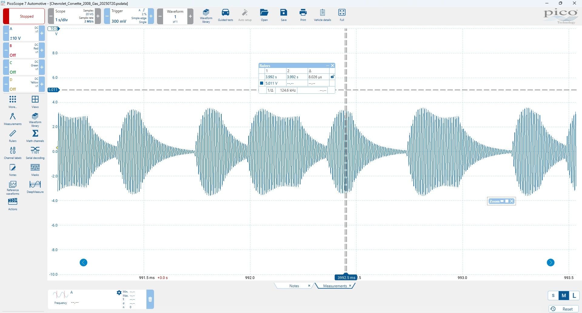

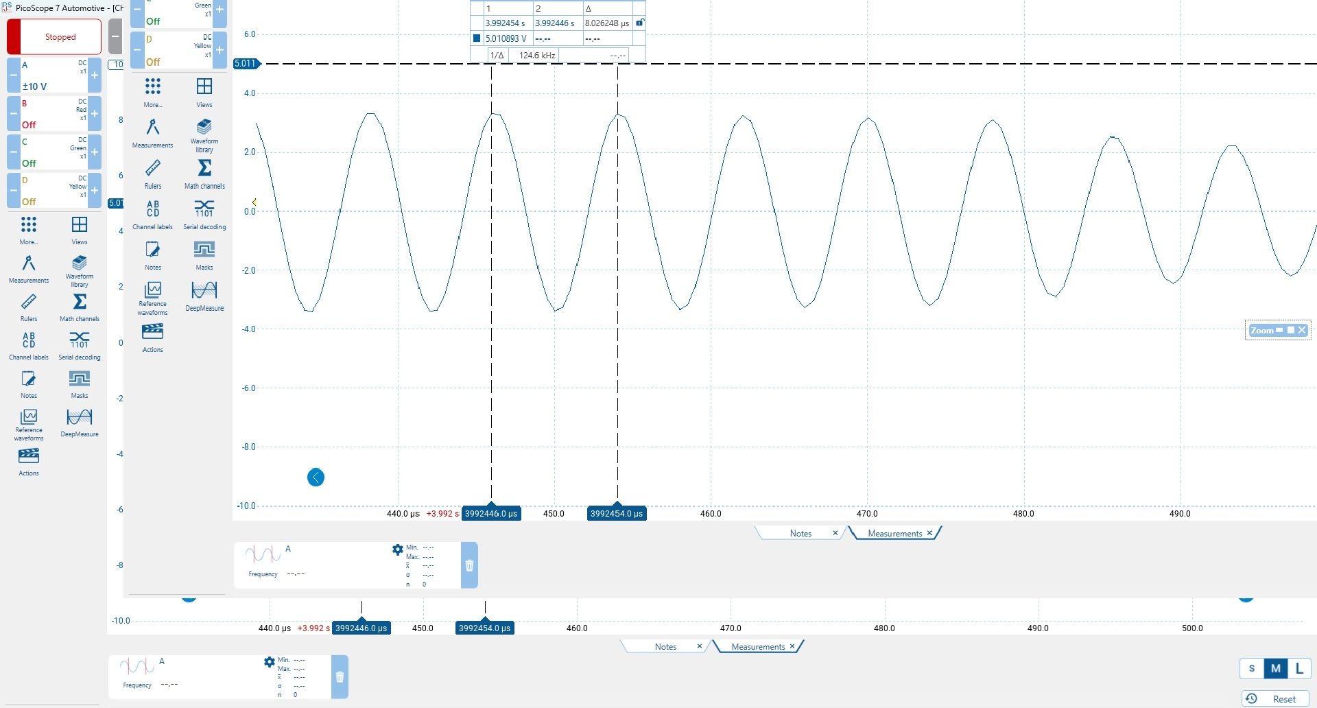

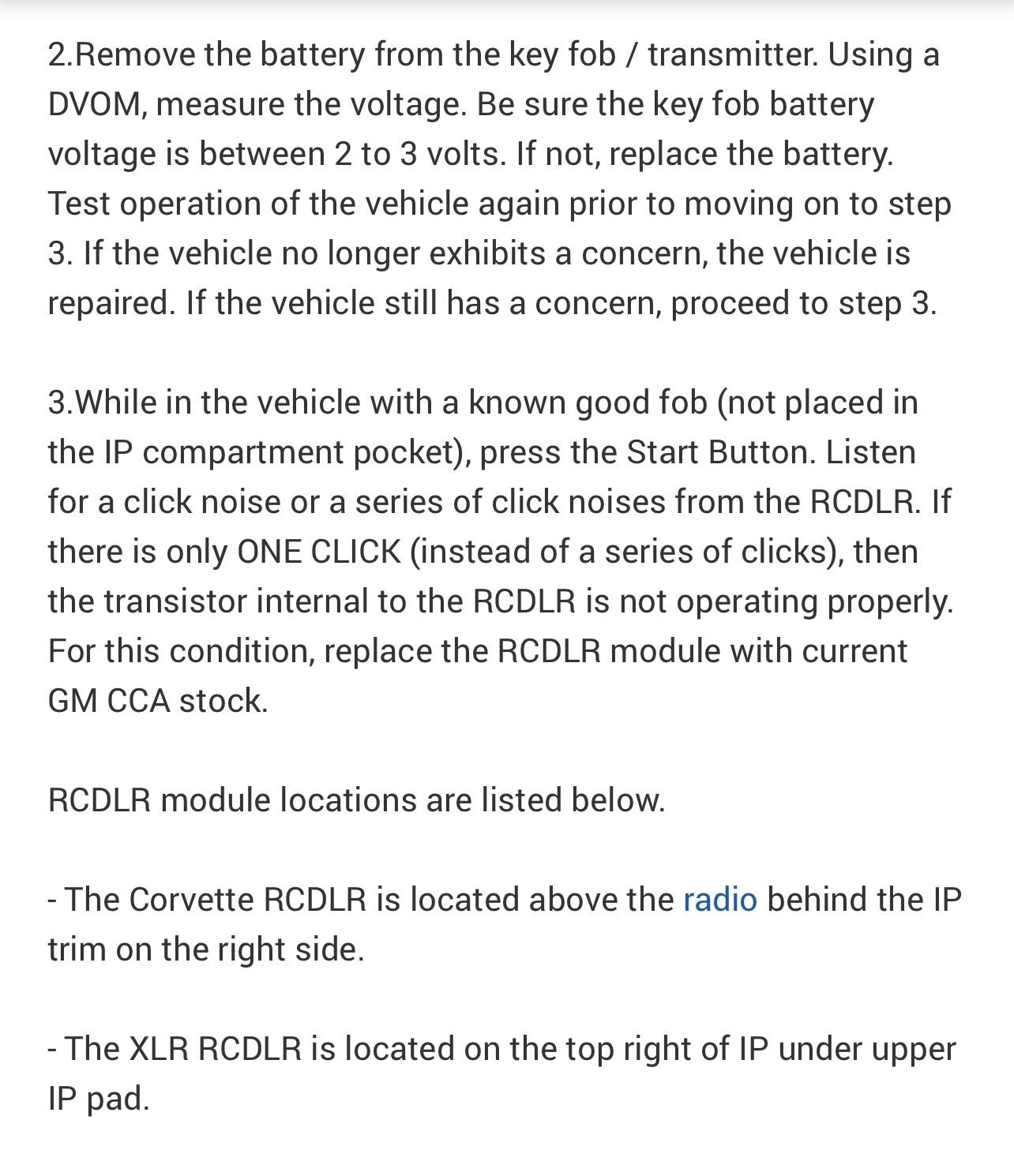

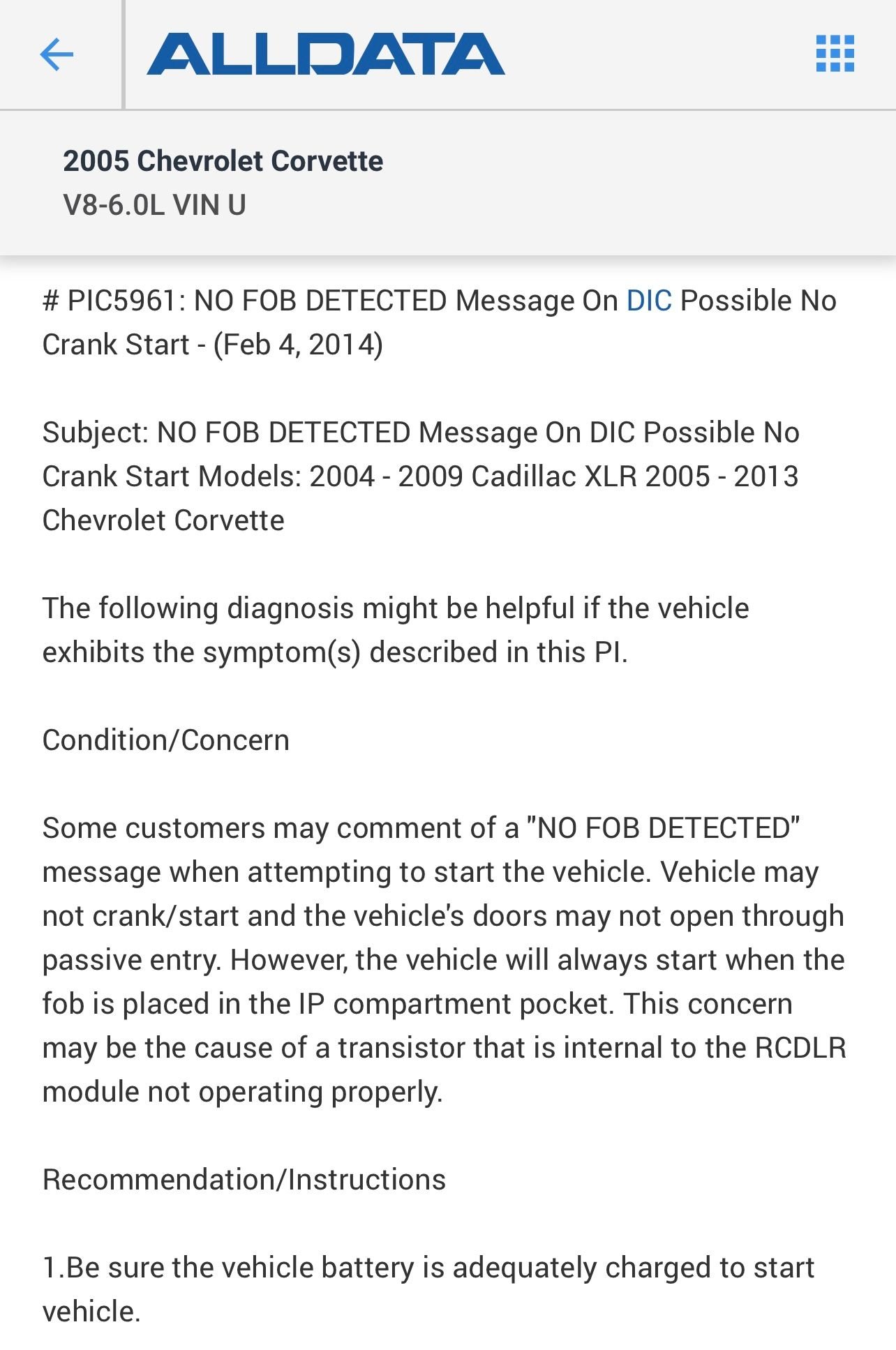

First thing I’d do is replace the FOB battery if that’s not been done yet…have you done that ??…if not replace it with a new fresh battery that reads 3.2 to 3.3 volts and make sure you install it correctly…this issue may be caused by and RF interference…make sure you don’t have a cell phone charger plugged in or even your cell phone in the car when trying to diagnose this…any LED interior lights as that may cause interference..read the PIC below from GM…when you start the car do you only hear ONE click…if so that’s a bad RCDLR…this just may be a weak FOB battery if it ALWAYS starts when placed in the pocket..if it doesn’t start when placed in there now you have some issues with the immobilizer system..,if it starts in the pocket the RCRLR is fine…read step 3…if it shuts off you have ANOTHER issue…I don’t know who Schneider is…are you seeing a “No FOB Detected” message ??…a dealership will probably not touch your car as they only replace parts…they aren’t going to waste 2 hours of diagnostic time on it…why you trying a tuner ??…is the car tuned ??…if not they have NO diagnostic experience…they tune cars !!…I’d call that shop I recommend as a minimum….the antennas put out a 125 kHz signal as shown below with a special piece of equipment I have on my labscope…any RF interference close to this frequency can cause issues…your window and door may be another separate issue.
