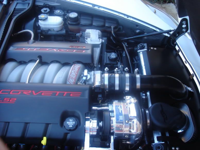

When we did mine, we only saw 11rwhp however it was part of getting more air in the engine, with the final plan later to supercharge it... After the s/c was installed it has well paid for itself by rwhp and tq #'s compared to other similar s/c setups with out the fast intake, we saw a much larger increase because of more efficient air flow into the motor... was it worth it before the supercharger you ask??? My answer is YES... I like to get every last bit out of the motor, before I get into the bottom end... As for the L.P.E. kit, it's VERY clean no "glassing" once the install is done, you would think it came that way from B.G....
Jeremy
Jeremy
J.....that snap shot is waaaaayyyy tooooo CooL Bro
