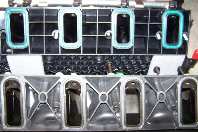

Check this pic out.
L92 and LS2 cylinder heads OH YES!

Originally Posted by TESTOSTERONE C5-R
Check this pic out.
Look how small the ports of the "FAST" intake is compare to the L92 Intake ports! OH YES!
Wow, nice. Yeah that L76 intake might turn out to be a real strong performer, no choice really, it's the only game in town for those heads right now.
