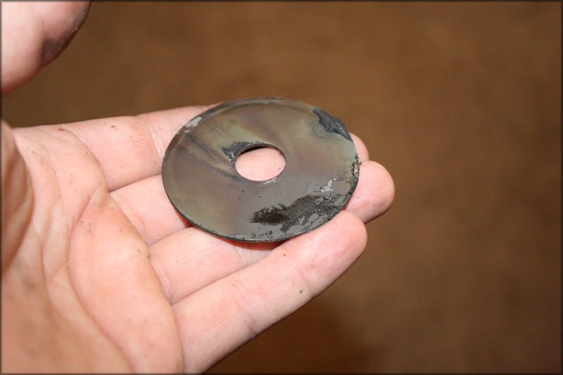

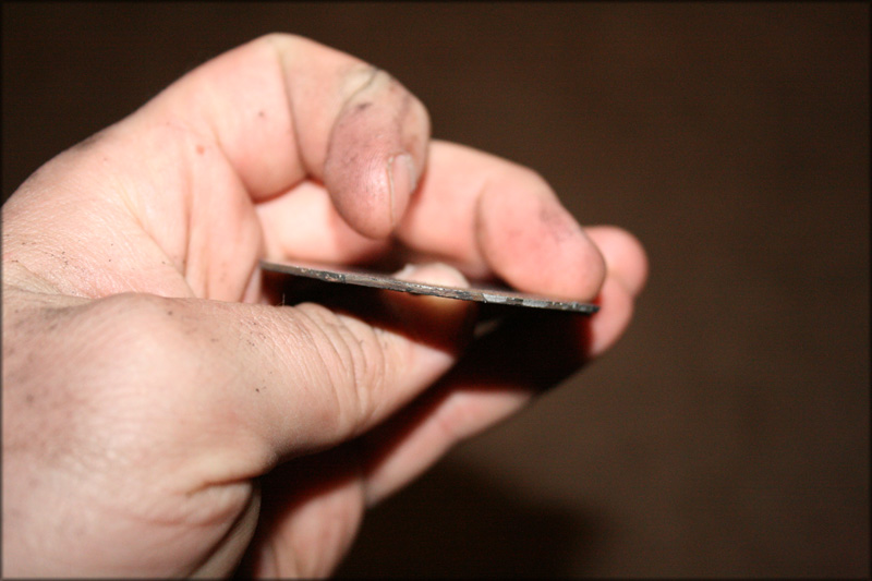

This requires you to remove the bolts from the leaf spring. I pulled out my trusty angle grinder and a 36 grit flap disc. First, it creates a hell of a mess. So I suggest you do it away from your car. Make sure you are in full battle mode and you aren't wearing anything you care about. Cause you will be dirty and the rubber will burn you if you get it on your skin. PM me if you want to know how I know.
I removed all the stock rubber that is normally cushioning the metal inserts with the flap disc. Once all the rubber was removed I used the flap disc to heat the metal insert enough that it could be removed from the bolt/rubber. It left as much rubber material as possible. I just cleaned up the edges so it sat smooth. Tossed some moly lube on the bushing and reinstalled bottoming out the bolt.

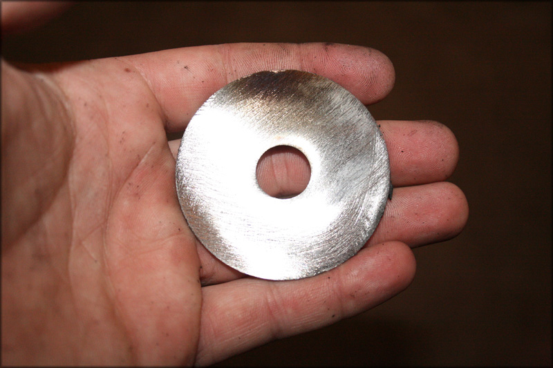

Here are some pictures. This is the side I used the grinder on.
This is the side that was "stuck" to the rubber. I used my channel locks to grab on and it just fell off.
