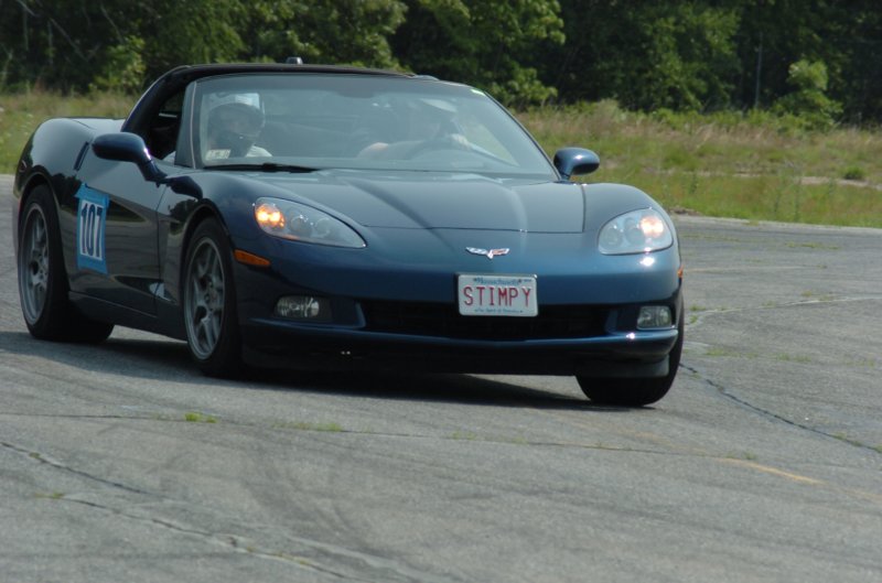

I also use the C5 Z06 wheels on my C6. 295 front / 315 rear.
The Z51 brakes WILL NOT clear the C5 z06 rims.
