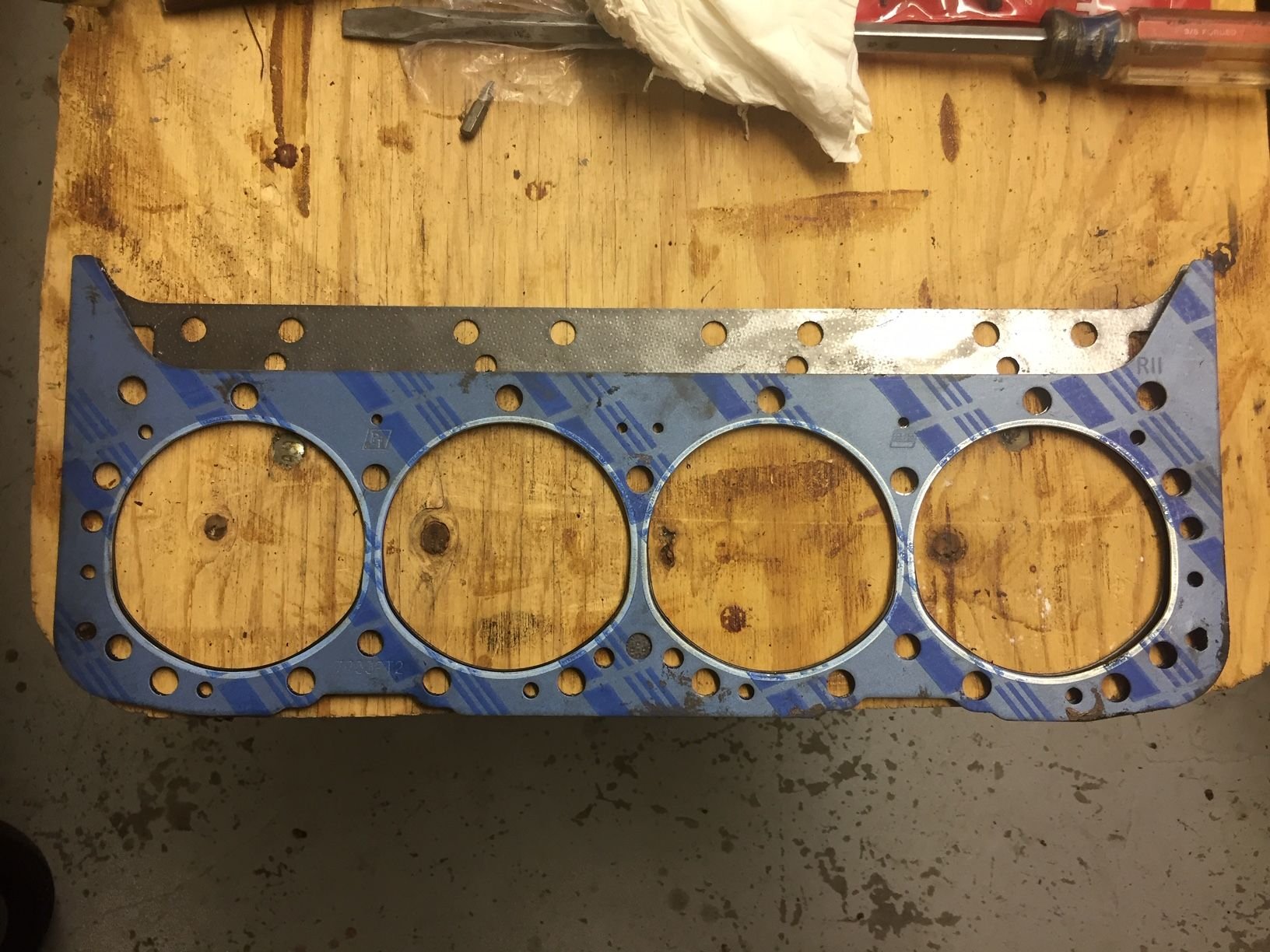

Here is photo of a FelPro gasket on top of the dealer gasket.
The FelPro covers the block and head, the "extra" of the dealer gasket does not appear to have any function.
Do I have an incorrect dealer gasket?

Originally Posted by woodcrest
Update!
Neither one of these gaskets are the correct head gasket for an LS engine.

Run OEM MLS gaskets. No reason to run anything else.
