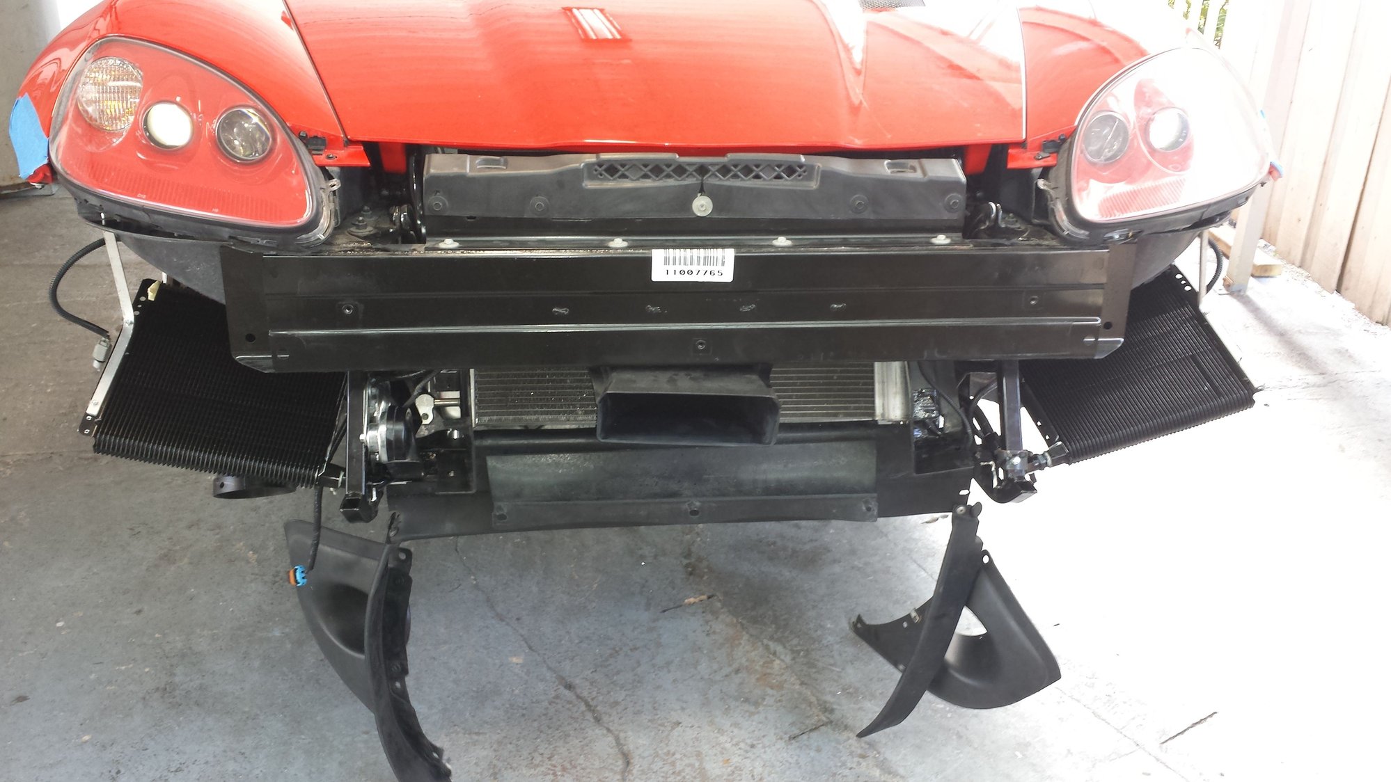

I have a twin turbo C6 running a 440CI RHS motor making 1200 at the wheels, heat if definately a problem.
Im using Aeroquip quick connects so the bumper remains removable.
For me this is superior to loosing my foglights and there is more exposed surface area for the coolers
Only difference from the pics is I used a Lingenfelter adapter as oppose to a remote oil filter due to space constraints
I sealed up the gaps around the radiator
Previously on an 80* day car would reach 220 oil highway, 240 after a WOT pull in 3rd and take 30 minutes to come down. Oil PSI dropping to 5.
Coolant stayed 190 to 220 based on speed
With my cooler I see 170 coolant and 175 oil at 60mph, oil tempspikes to 215 after WOT and is back to 175 in 10 minutes. Oil PSI stays in the 20s

What size and model are those two oil coolers?

3x12in EARL black anodized

Hey sinister that sure is a clever solution you came up with
I guess we find a solution when we have to I was happy to give up my fog lamps they are too low imo to be that effective plus the head lamps are good enough for me so yah...
Drivers side oil cooler pass trannie I have sense added two 8" fans to aid cooling in slow traffic with a temp controller turns the fans on @ 160 degrees.

Looks good! Only draw back to mine is no option for a fan (3in computer fans pull pitiful CFM) but I was in 10 minutes of traffic and didnt see oil temps over 200 and they declined as soon as I moved
