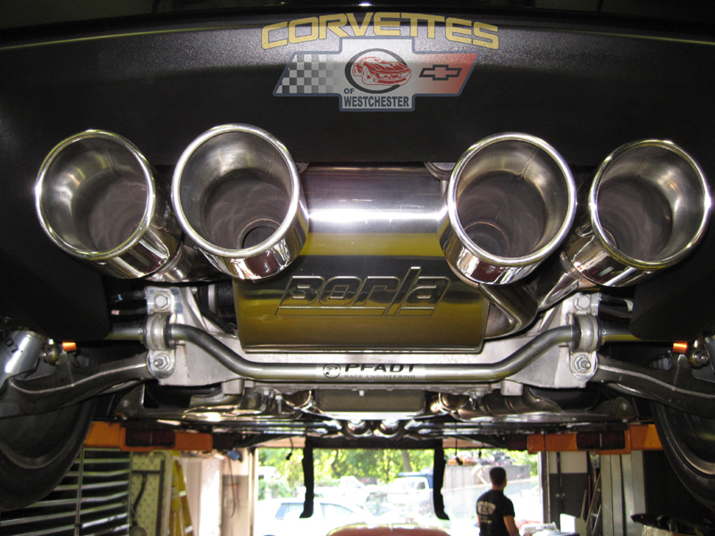

Came the BORLAS! And the PFADT SWAY BARS!
So, How do you make BORLAS SOUND BETTER??!?!?!
You add AMERICAN RACING HEADERS with High Flow Cats!!!!!

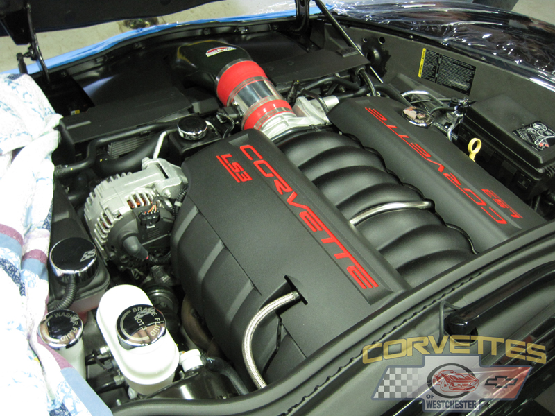

DOCTOR, PLEASE PREP THE PATIENT FOR SURGERY.

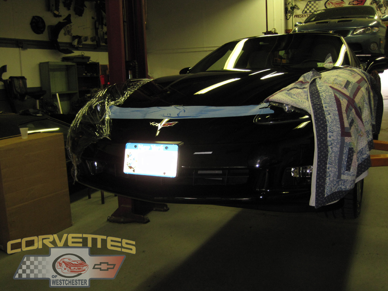

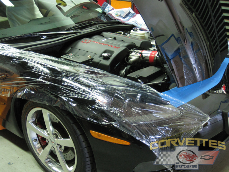

Cover the fenders with plastic please...
Blue Painter's tape and clear plastic...PROTECT THE PAINT!

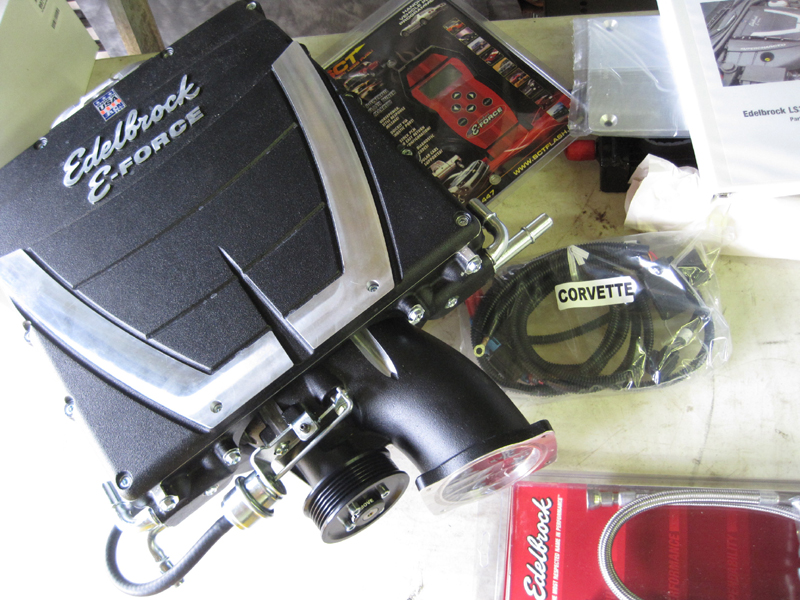

It all starts HERE. READ THE DIRECTIONS.
Here's some of the parts out of the Edelbrock Crate.
The process BEGINS.

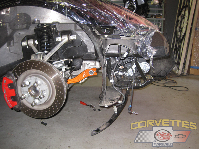

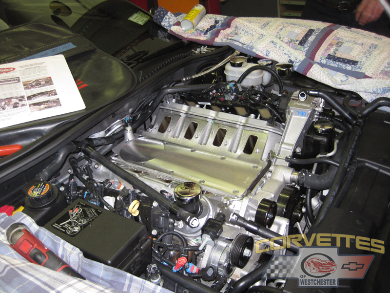

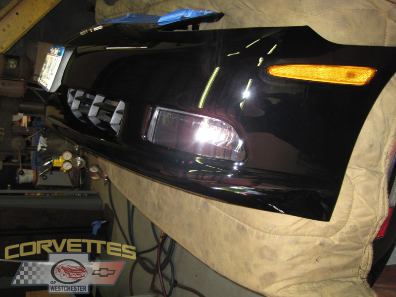

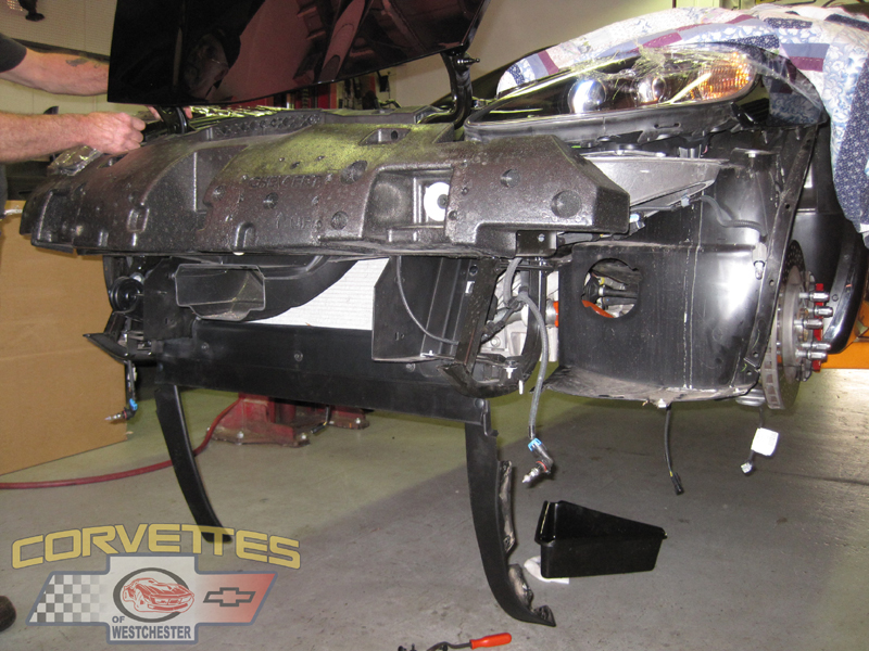

REMOVE THE FRONT BUMPER.

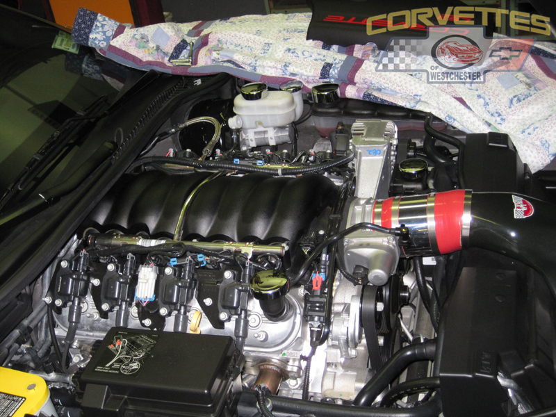

REMOVE THE VARARAM and install the NEW VALLEY PLATE,
TENSIONER ASSEMBLY and related.

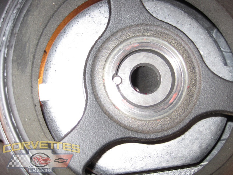

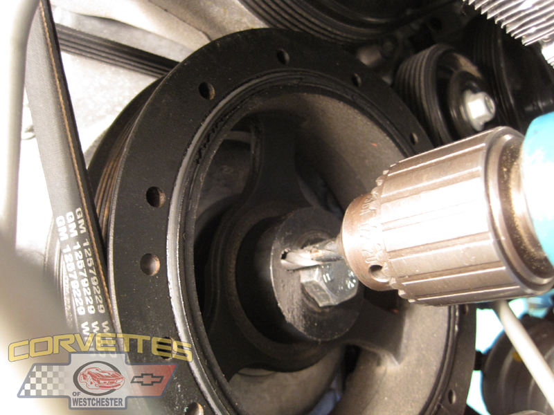

Drill the crank and PIN it so the pulley does not rotate on the crank.

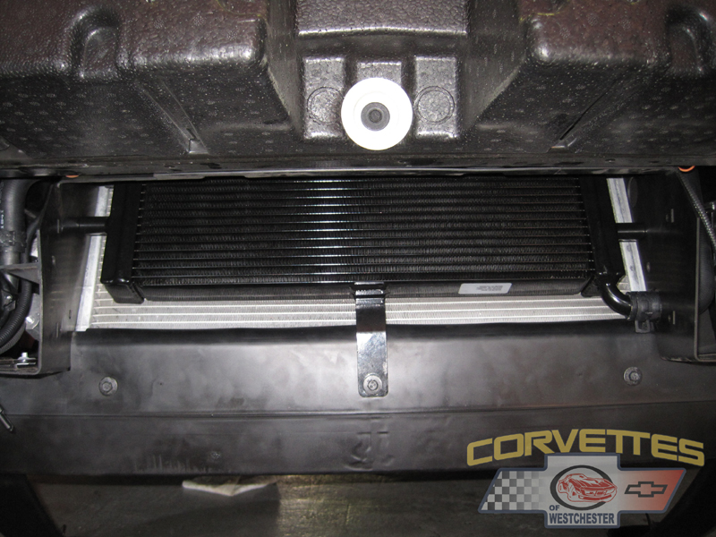

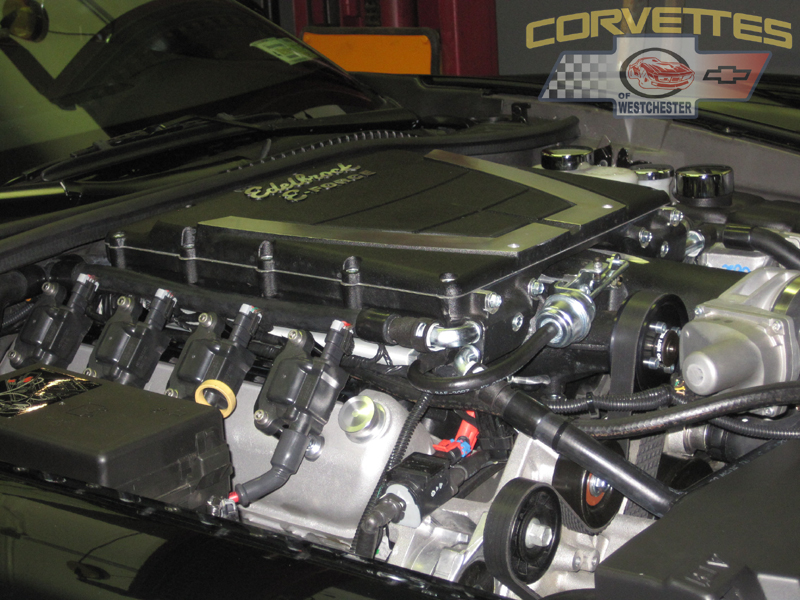

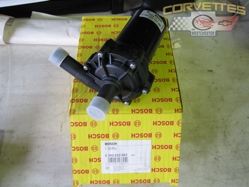

Install the INTERCOOLER, PUMP, and HOSES.

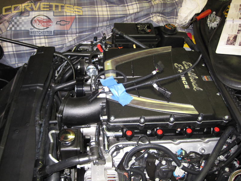

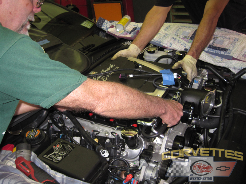

The E-FORCE is heavy and takes 2 or 3 guys to safely put in place.

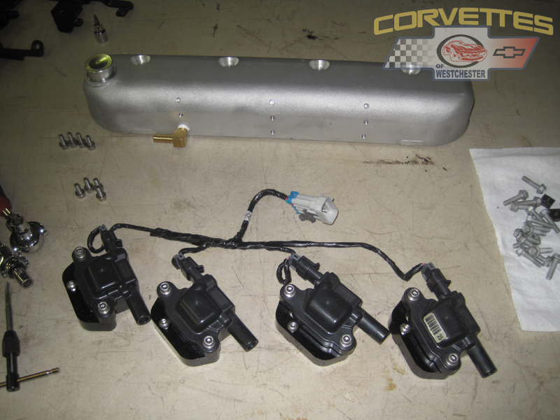

Eric decides to CUSTOMIZE and PERSONALIZE his E-FORCE...
Eric My friend.... Only for you.... The time I spent.... Sheesh...

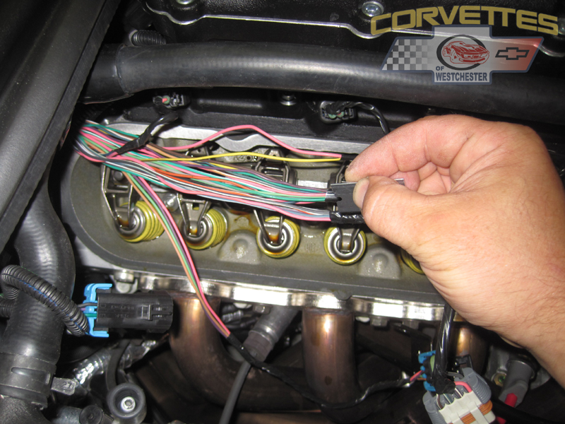

Here we go....Custom Valve Covers and Coil Re-Location Drama!
Dr.Chuck! You're needed in the operating room again!
Modify the wiring harness to make it work.
TOTALLY CUSTOM - ONE OFF MODIFIED COIL RELOCATION KIT...PHEW!

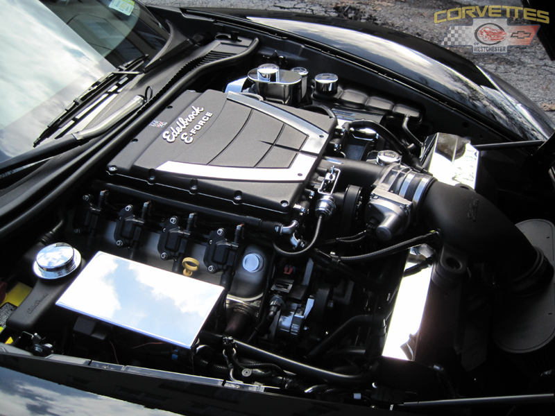

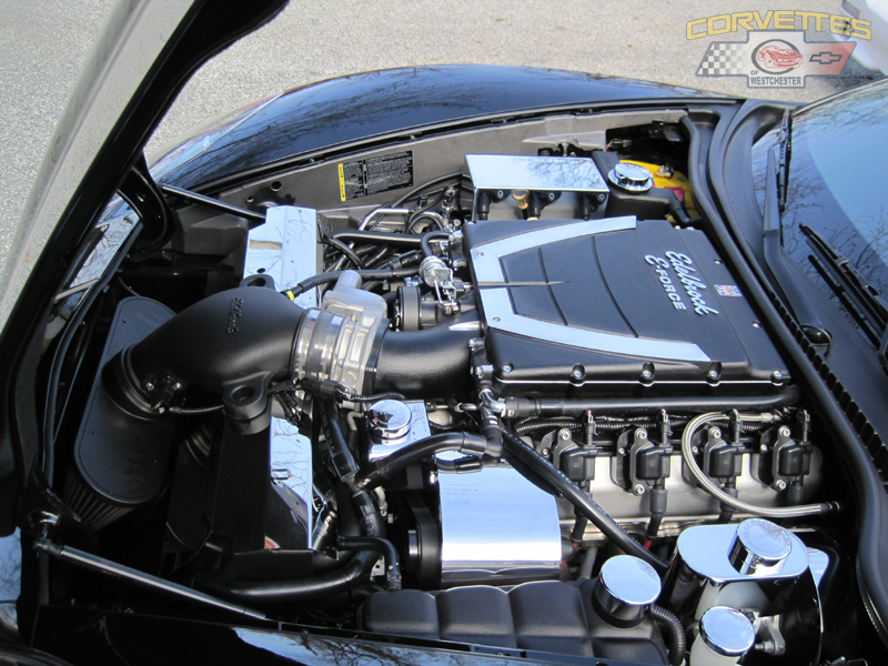

And here's the finished product....POLISHED and READY to TAKE FIRST PLACE!
And the Proud PAPA with his BABY...
BEST IN SHOW EVERY TIME... FAST AS HELL... IMMACULATE....
And TOTALLY RELIABLE for long trips to visit his son...
Eric's Beautiful 2009 C6 A6 w/3.42s and E-FORCE 599 kit makes about
545 WHP on 93 OCTANE.
