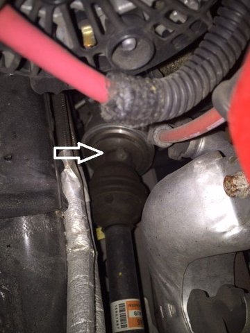

Hi. So I opened the hood, found the steering shaft/column and I followed it down toward the front of the car.
With the car off, I turned the wheel slightly side to side and determined the sound was coming from where a portion of the steering shaft connects into another part (sorry, I don't know the name of the part).
I purchased some white lithium grease spray and sprayed the area and the squeaking went away.
