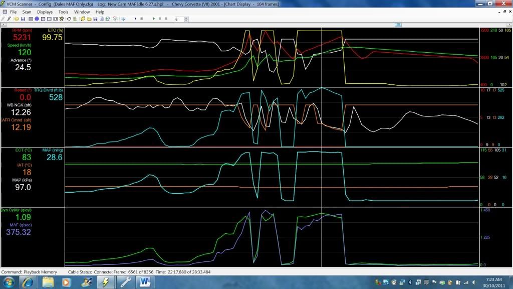

I know you spent a little time with your HPT
Do you think based on this log this motor makes any power?

One more, TC on & cold PS2's
I'd say so! Delivered Torque is 56 more ft. lbs than mine at the same RPM, as per below. I just checked my friend's high 9 second 427 (A6) and he's at 486 delivered tq. So yes, you're making power.
How are you getting the cylinder charge (dyncylair) above 1? What are your mods?

It also looks like traction is a problem.
Same for a local 900+ HP car with 12-14 second timeslips showing 80 MPH at the 1/8, yet 130-134 MPH for the 1/4.

Stock
It's my 416, Fast 102 & NW 102 TB with Haltech's LS7 whizzy intake.
Traction is a issue, the third gear TC nanny kicked in @ 60mph. In fairness the 305's PS2's are not very good at that temp.
