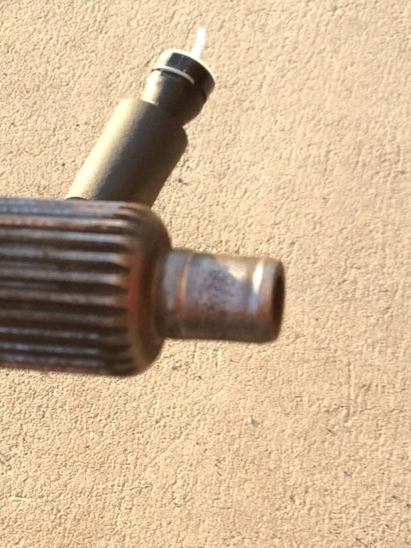

I'll update this thread just for anyone who searches for the same issue in the future.
I had zero luck finding a used input shaft. RPM transmissions didn't have any and every salvage yard told me that the usually sell the rolling chassis, and this shaft goes along with it.
I ended up taking my damaged on to my local machine shop and they fixed mine for $135. It can be fixed by either spray welding material back onto the shaft and then machining it back down to the required .059" diameter, or it can be ground smooth and a sleeve pressed on that is .059" in diameter.
Hope my headache(s) helps someone else out later on.

Forgot to mention, a new shaft is about $750 from GM. I was able to find a dealer who would sell it as low as $500+ tax, which is still way too much.
Here is the repaired shaft, good as new

I usually sleeve these and get rid of the pilot bearing. You can use Partnumber PB656 bushing and use a solid brass bushing.

Having the same problem do u happen to know if the machine added a sleve and machine it down? Also how is it holding up? Thanks
